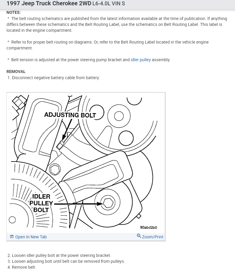

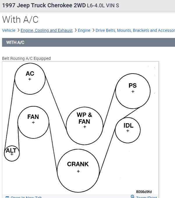

Only have serp belt rout.
https://www.2carpros.com/forum/automotive_pictures/30961_beltrt_1.jpg

Attached is the belt diagram as well as replacement procedure for anyone looking for this information.
Here is a helpful guide on serpentine belt replacement:
https://www.2carpros.com/articles/replace-serpentine-belt
Let us know of any questions.
