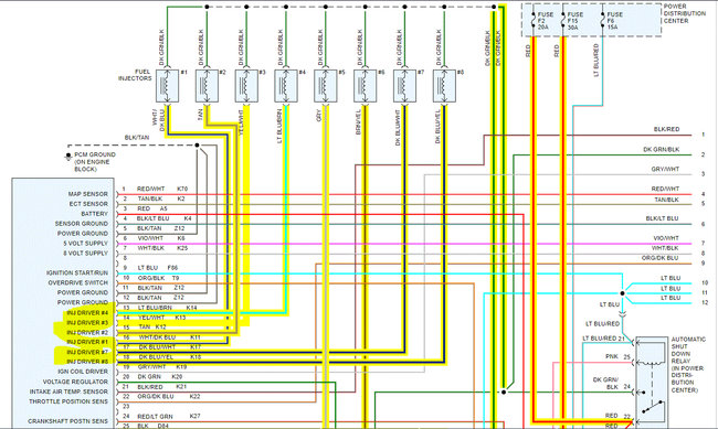

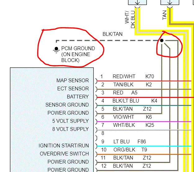

If you confirm there is no pulse, the next thing I need you to check is the ground to the PCM. If you look at pic 1, it shows how multiple wires splice together and then one goes to ground. It isn't uncommon for a splice to corrode or become loose or damaged causing issues for specific components.

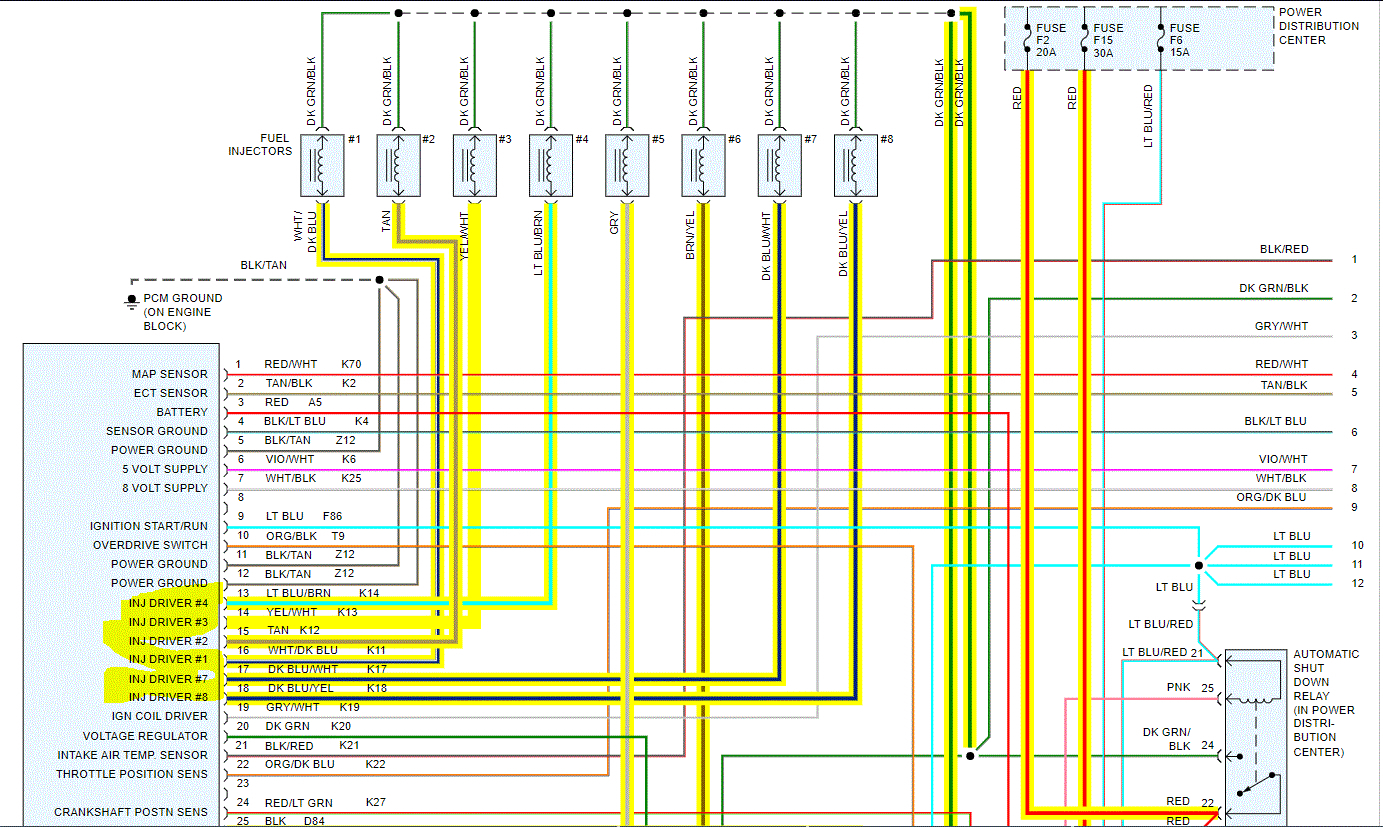

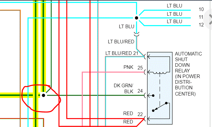

Once you confirm that ground is good, I need you to confirm the ground which ties together all injectors and the ASD. I know the ASD is good, but once again, there is a splice that can cause issues. See pic 2

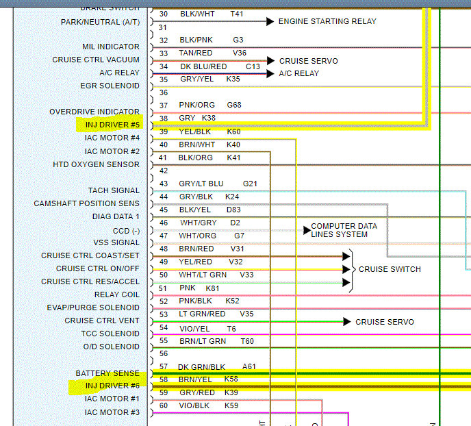

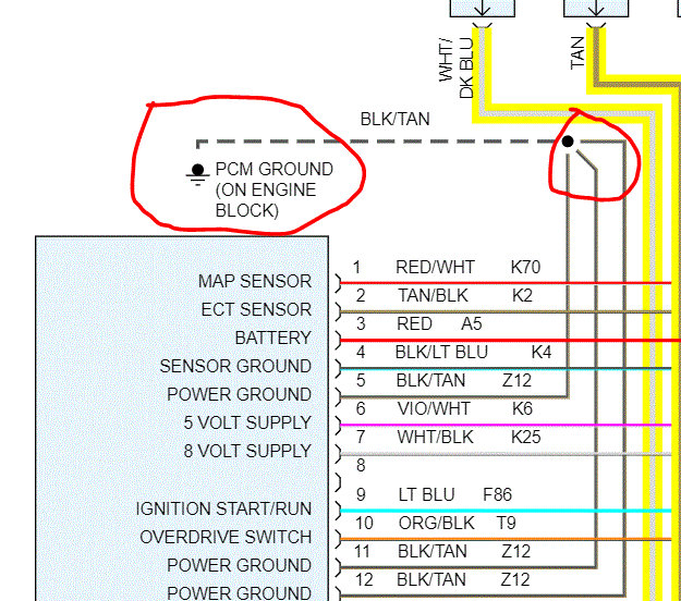

If that ground is good as well and there is still no injection pulse, I need to go check the PCM pins for the injectors for a pulse. If you look at pics 3 and 4, they show the pins related to each injector. We need to determine if power is available there.
If you note, there are three fuses at the top right of pic 4. I want to assume they are good since you have spark, but confirm they are.
