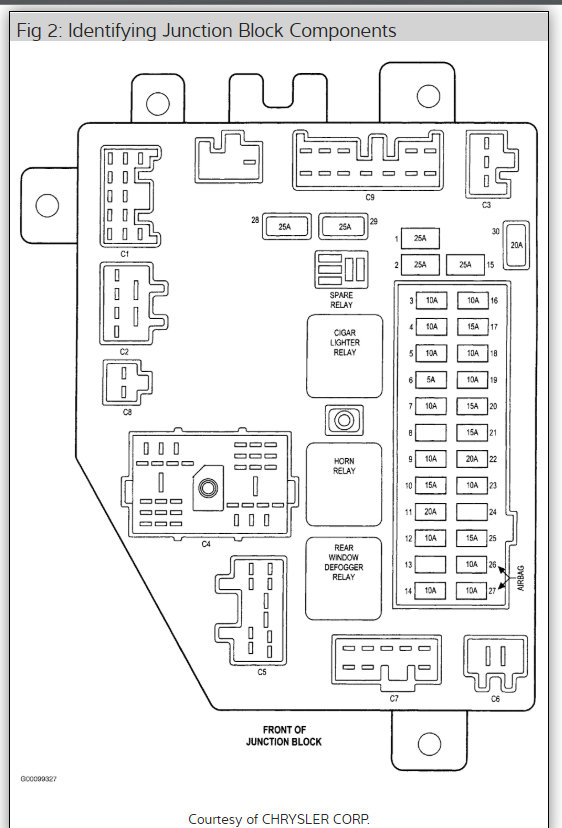

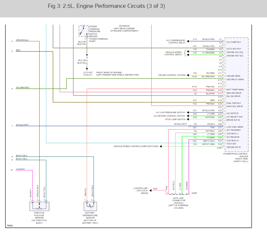

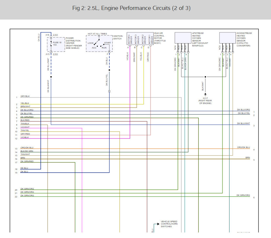

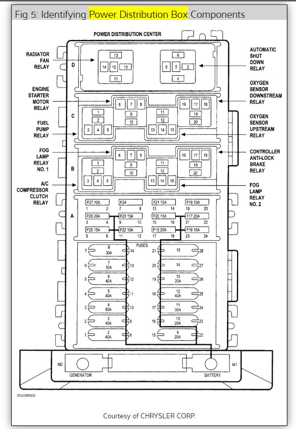

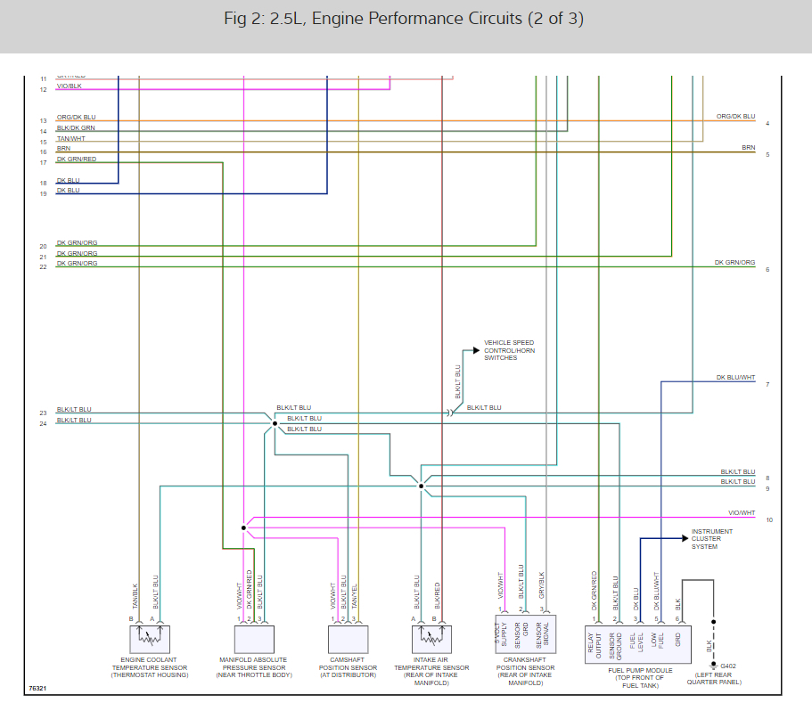

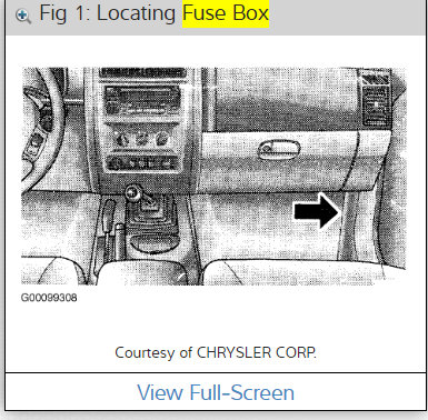

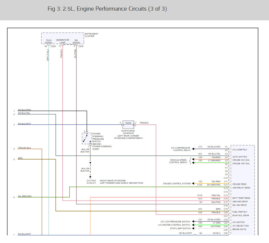

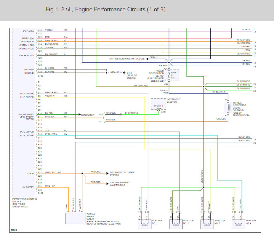

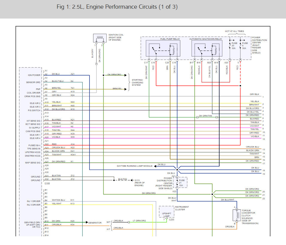

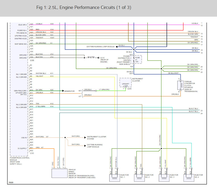

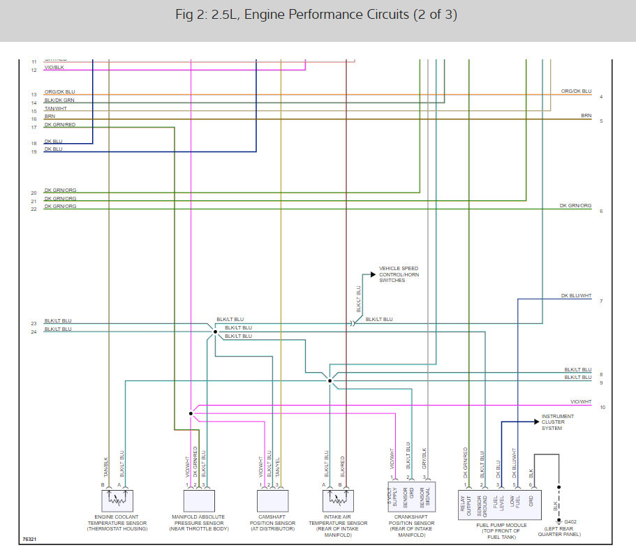

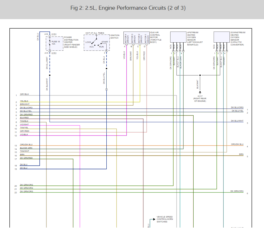

Let check the fuses first by using the guide and the fuse locations below. I also have the fuel pump wiring diagrams so you can see how the system works.
Check out the diagrams (Below). Please let us know what you find. We are interested to see what it is.
