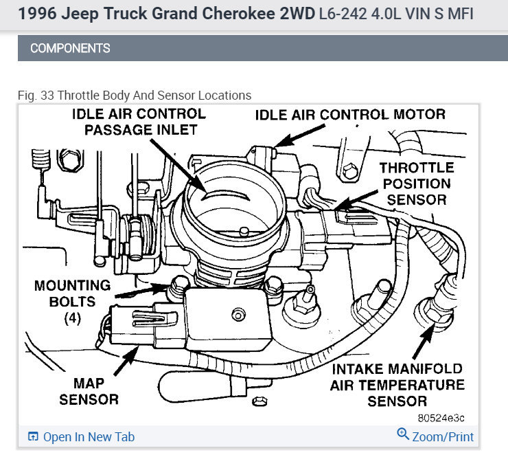

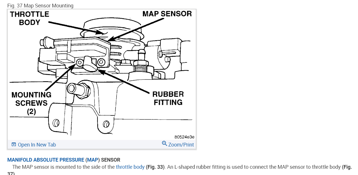

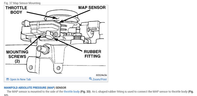

It sounds like you have a map sensor that is not working right or a plugged catalytic converter here are tow guides and diagrams below to help us get the problem fixed.
https://www.2carpros.com/articles/engine-has-low-power-output
and
Check out the diagrams (Below). Please let us know what happens.

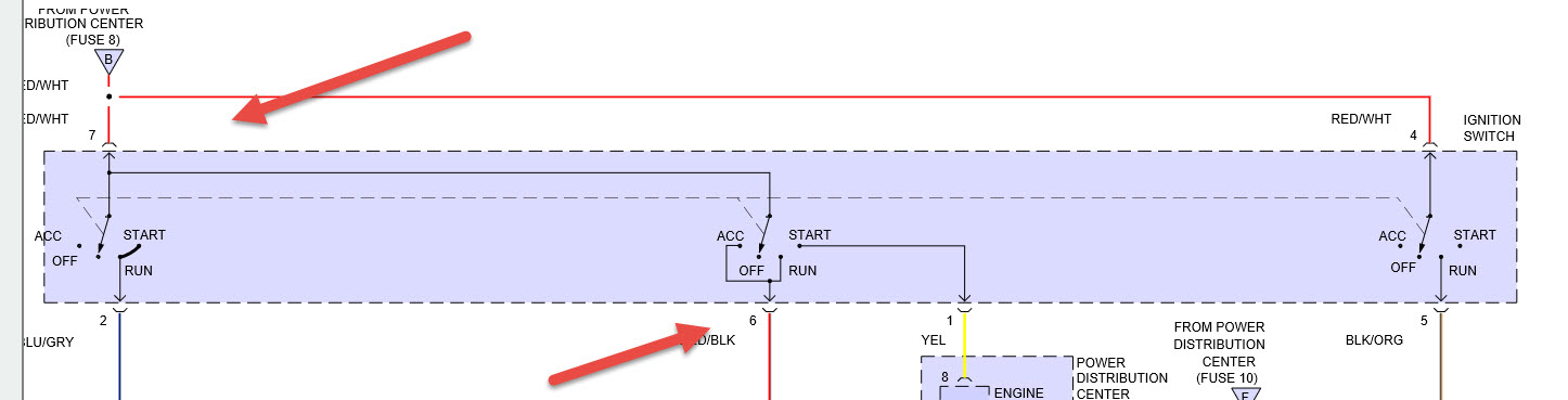

Our car keeps randomly shutting off. i very sure it is the ignition switch connector the wires coming out of the connector two of them I burnt up and really corroded. I think it is numbers 7 and 6 I am trying to figure out where the wires go so I can rewire them.
Jun 18, 2020 at 10:38 AM (Merged)
HMAC300
  • 48,601 POSTS
Seven comes from PDC and six goes to junction block also check harness at rear of engine by stud on head it wears through there and causes multiple problems.
