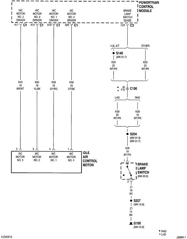

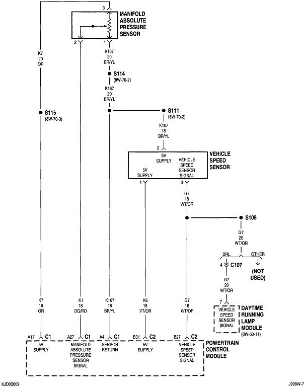

engine wiring diagrams please?
2004 JEEP CHEROKEE
51,000 MILES • V8 • AWD • AUTOMATIC
MARKCCAMP1116
while driving the engine stopped for gas jeep lost power I need to check the engine wiring can I get engine wiring diagrams please?

Here is a guide to help you step by step with instructions in the diagrams below to show you how on your car.

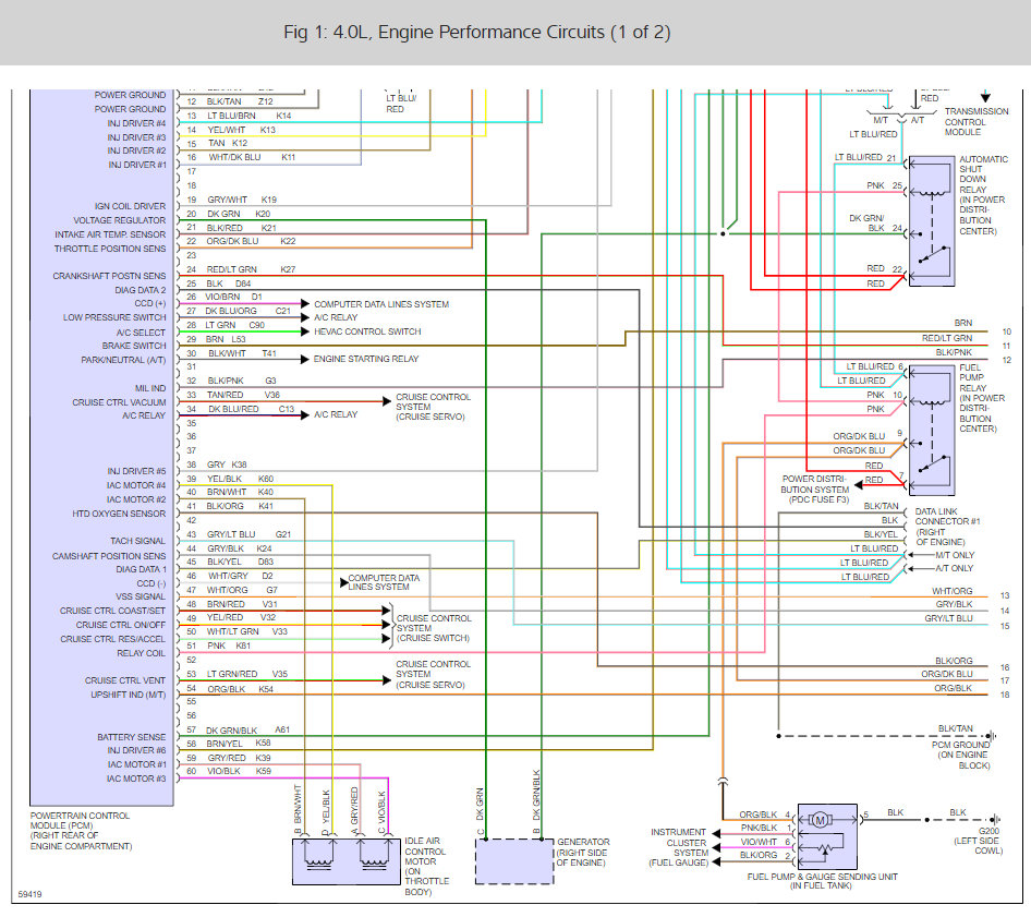

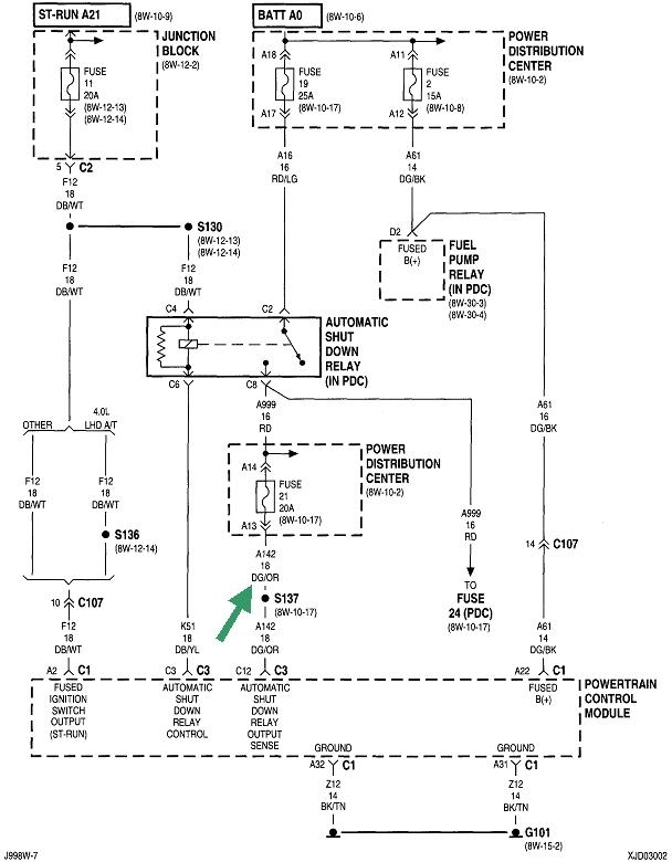

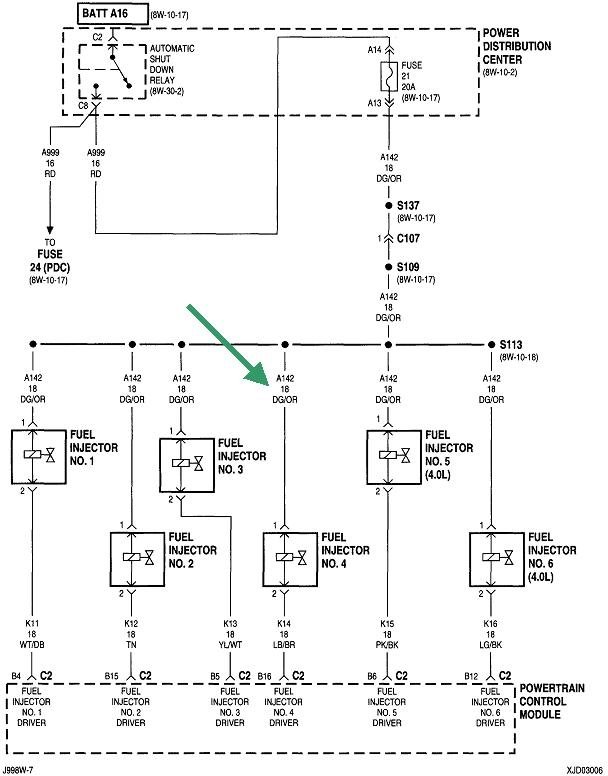

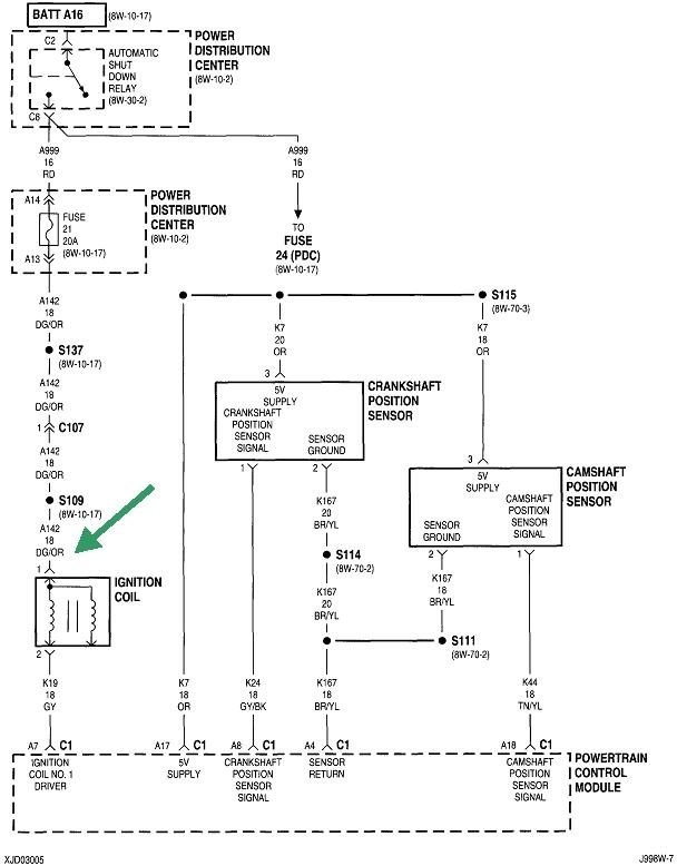

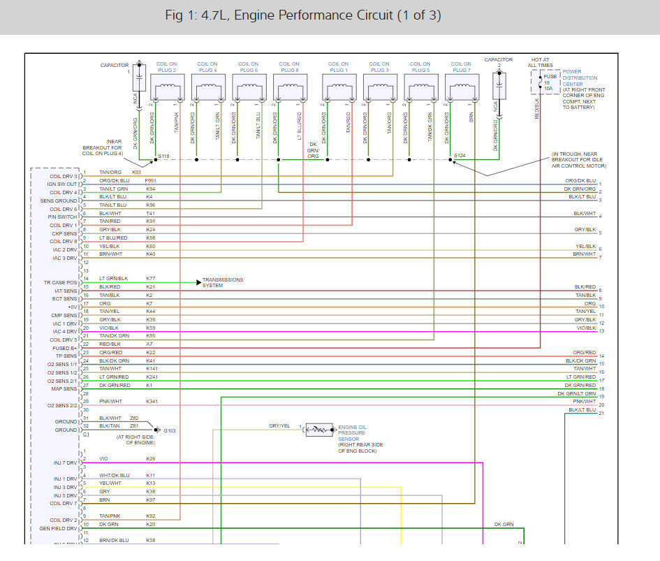

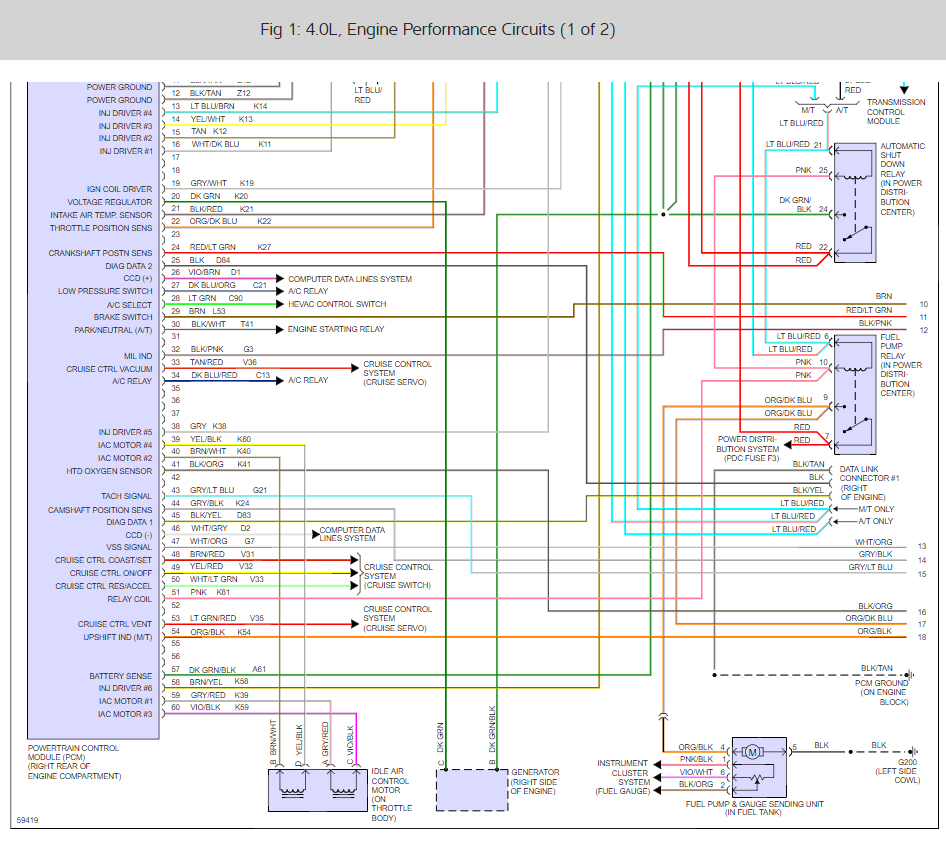

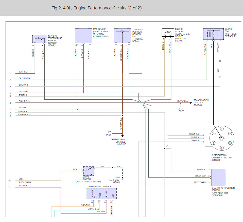

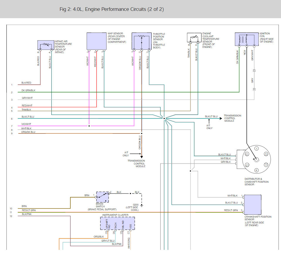

Vehicle wouldn't start so we got a new coil, when we plug the coil into the wire there is no power, but when it is unplugged there is power. Don't know what it is or how to fix it.
Feb 5, 2021 at 8:20 AM (Merged)
  • 34,306 POSTS

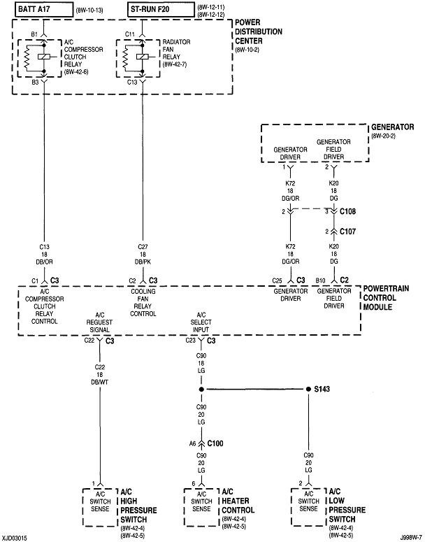

I'm not clear on where you're taking voltage readings, but if it's on the primary side of the ignition coil, there should only be 12 volts there for one second when you turn on the ignition switch, then it will go back to 0 volts. The 12 volts should come back during engine rotation, (cranking or running).
For this type of circuit, use a test light, if possible, instead of a digital voltmeter. The test light can be more accurate in finding some problems.
Another test is to back-probe any injector through the rubber seal. This will be the dark green / orange wire at the ignition coil or any injector. In particular, we want to know if the 12 volts comes back during cranking. If it does not, you won't have injector pulses or fuel pump either, so you don't want to waste time with the ignition coil.
The test points are shown in the first, third and fourth diagrams.

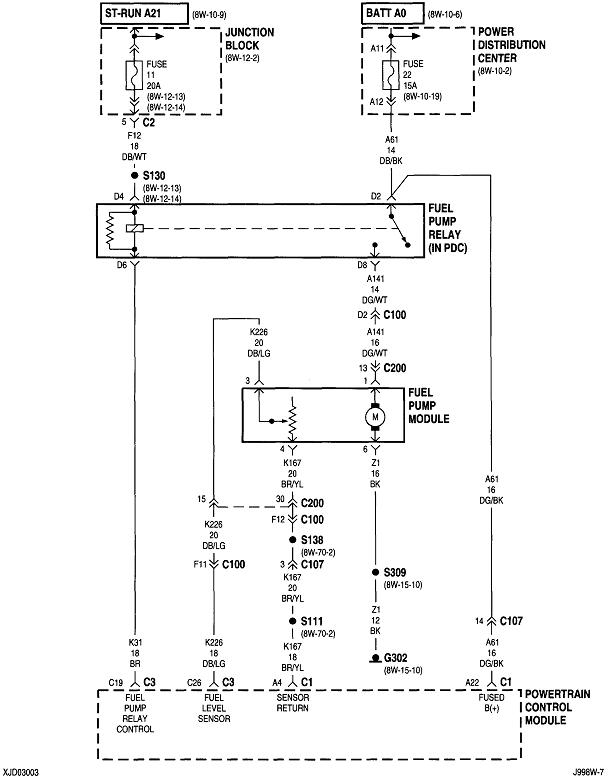

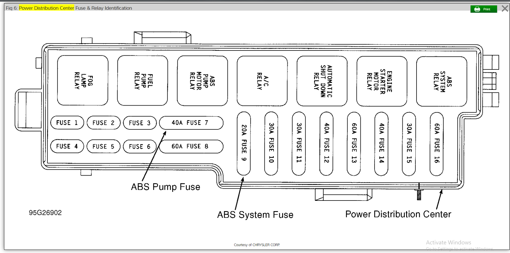

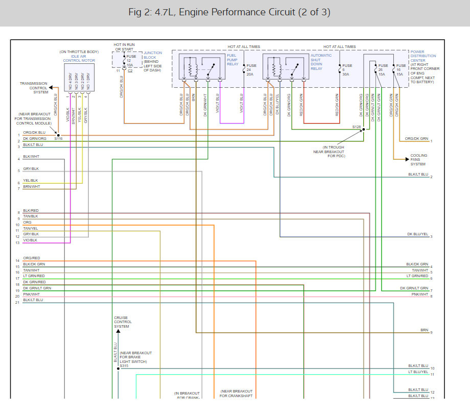

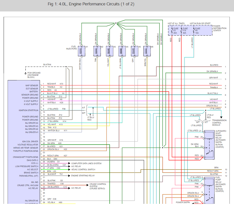

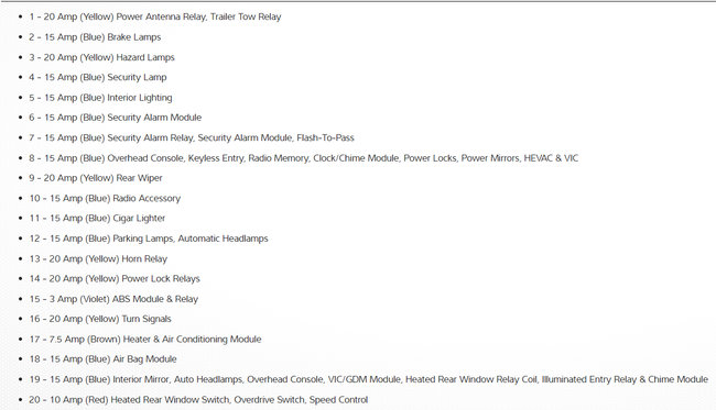

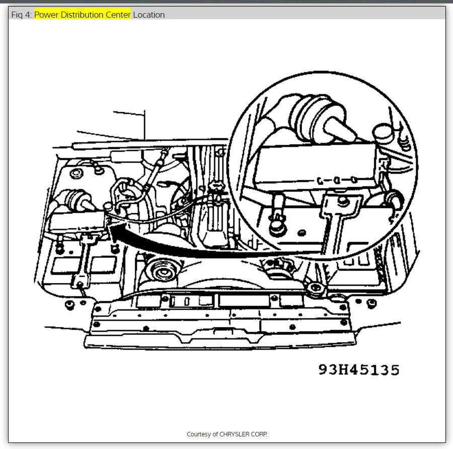

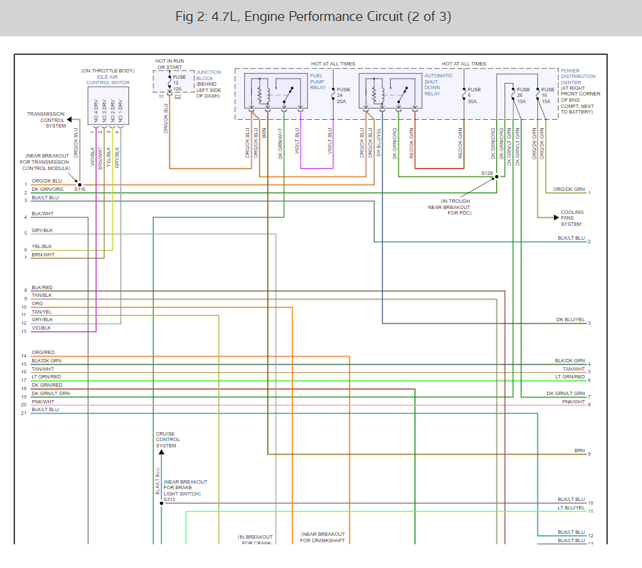

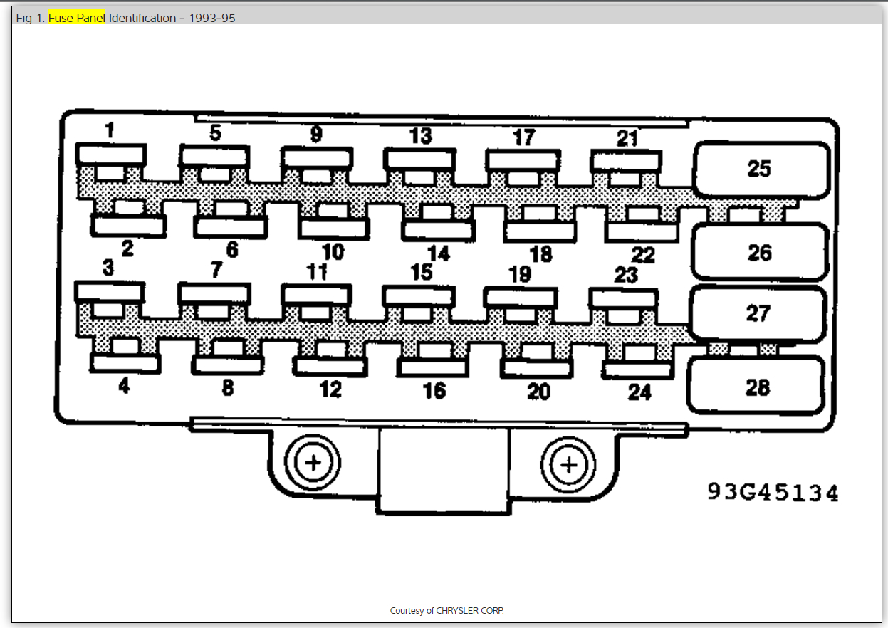

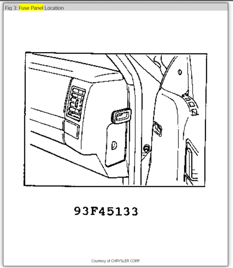

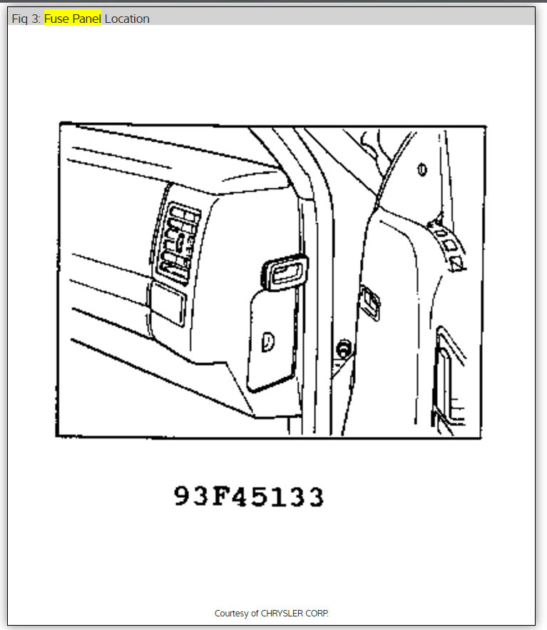

As subject says I really really need the location of the fuel pump cut off switch in my 93 jeep cherokee with a 4.0 inline 6 or a close general area. I looked in the area but nothing on the cut off switch I know it has one but I just cant find it and I believe that is what is wrong with my jeep. Any other ideas on location?
Feb 5, 2021 at 8:21 AM (Merged)
OBXAUTOMEDIC
  • 3,711 POSTS
There is no cut off switch like on a Ford car, There is a fuel pump relay though that goes bad, Here is a wiring diagram so you can see what Im talking about and fuse and relay box locations along with a guide so you can confirm the problem and get it fixed.
Cheers,
TRUSOLDIER626
  • 8 POSTS
Yep this is what I needed, I cant believe this service is free. I found the relay was bad and replaced it, now the car runs great and Im off to work.
Thanks 2CarPros

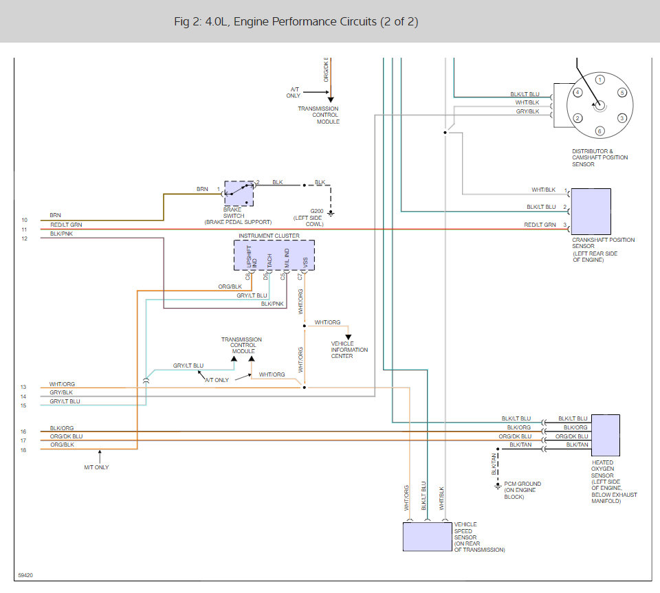

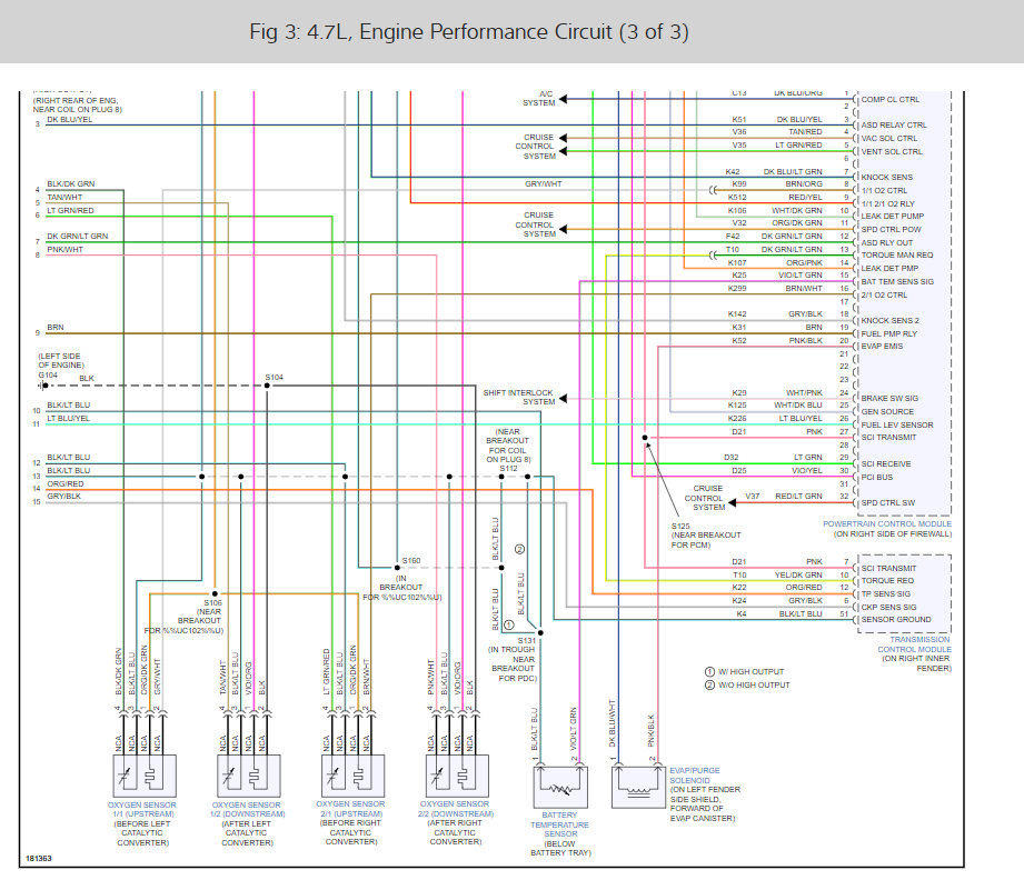

MRDCOE

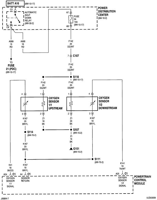

I have a 3 wire oxygen sensor. The wires on the sensor are as follows. I need the matching colors for the connector.
Existing on Oxygen sensor
A-Blue
B-Black (center)
C-Red
Matching other side
A-Gray or Brown
B-Unknown (Org or Black)
C-Unknown (Org or Black
I cannot find this anywhere. Thank you in advance
BLUELIGHTNIN6
  • 16,542 POSTS
hello and thanks for donating
i hope i understand your question correctly...let's see if this is what you need...
BLUE -- GREY -- To ECM
BLACK -- BLACK -- To GROUND
RED -- ORANGE -- To RELAY (power source)
