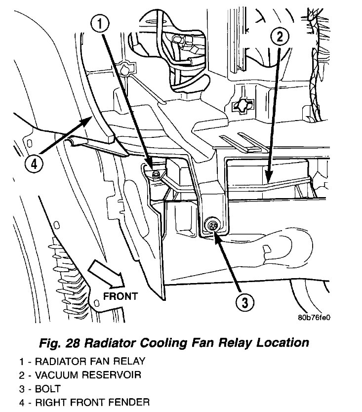

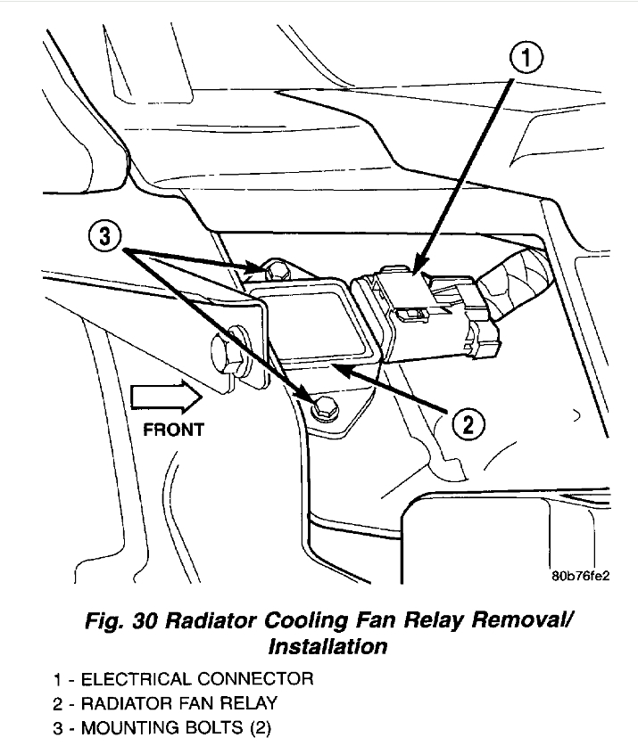

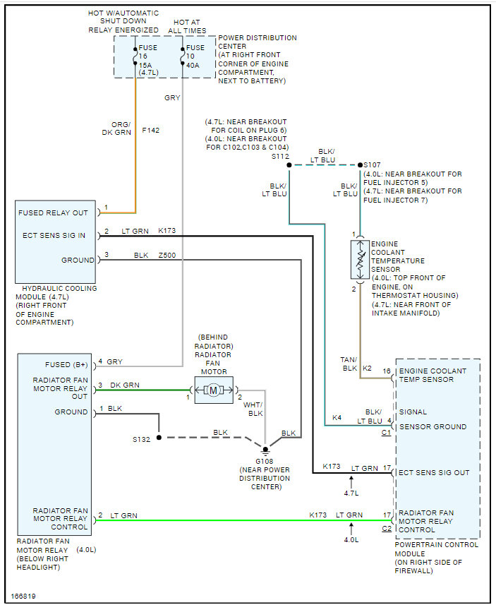

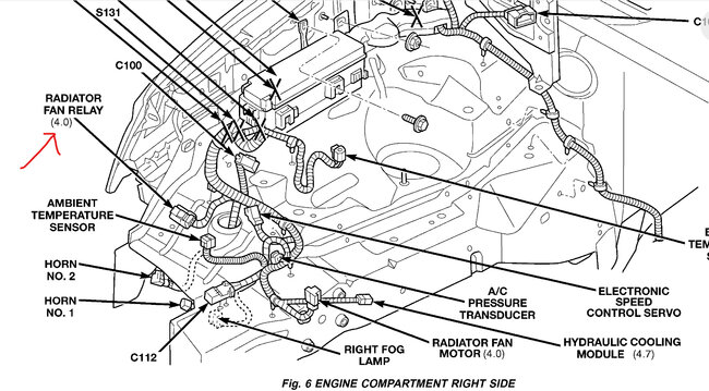

the cooling fan even after ignition is off the fan will run until the battery is dead, what should i check and where is the cooling fan module located at?
