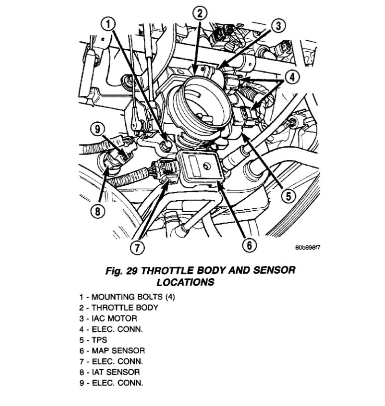

if 4.0L in line 6 does not use MAF has a MAP. Check out the diagrams (Below). Please let us know if you need anything else to get the problem fixed.

Hi MAP on intake see diagram
https://www.2carpros.com/forum/automotive_pictures/198357_Graphic_516.jpg
Has ECT sensor been checked out if faulty would make cold start difficult. Is vehicle hard to start all the time? Been doing this long time? any other performance problems? Let me know Thanks for donate

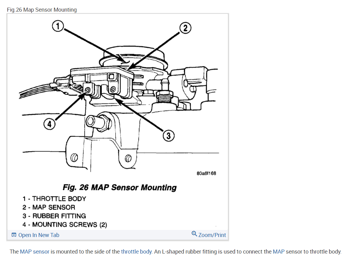

Need OHM meter remove connector probe terminals engine cold should br 3K ohms as engine warms ohms drop if not replace.At menu for jeep click on Electrical, then click on Componet locations then click on sending units and sensors then MAP 4.7 click on Fig. 6 blue highlited
