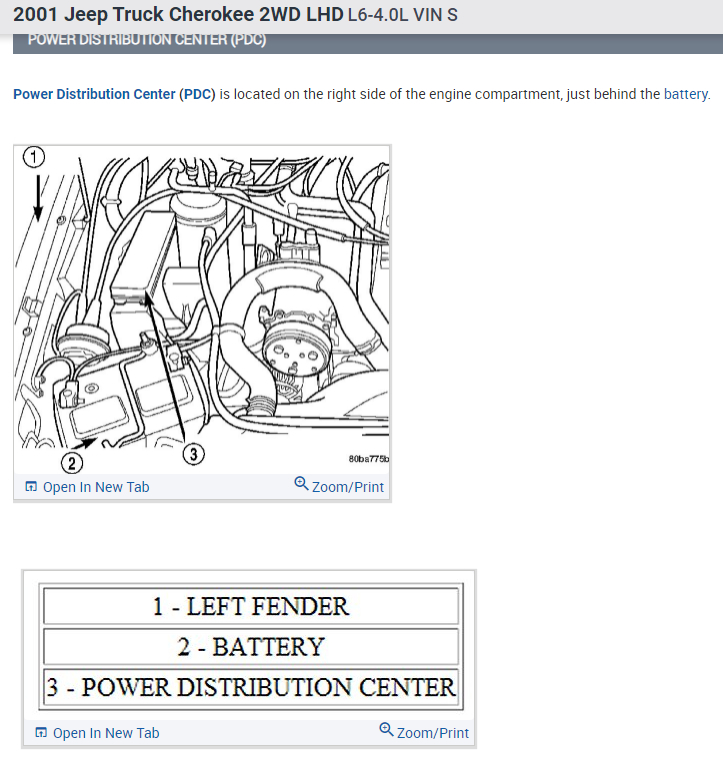

You need to check the power distribution box next to the battery. It is where the positive battery cable goes into. Many times on a reverse polarity attempted jump start, it damages the box.
You will have to test the individual relays and fuses to see what needs to be replaced.
Here are few helpful articles:
https://www.2carpros.com/articles/how-a-car-fuse-works

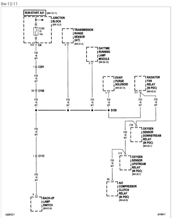

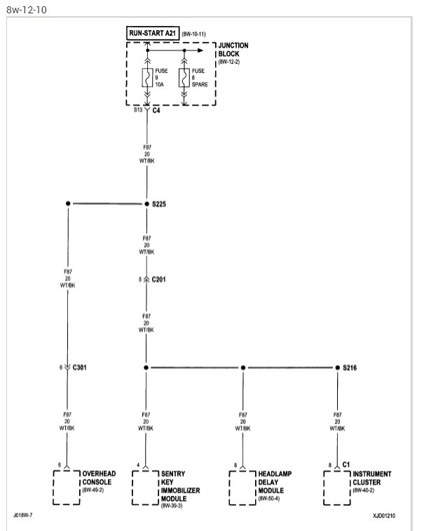

I have attached the power distribution box location diagram as well as wiring for the starting system.
