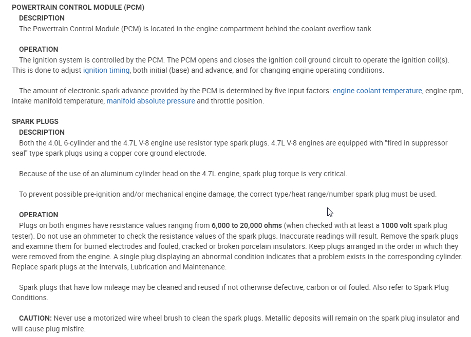

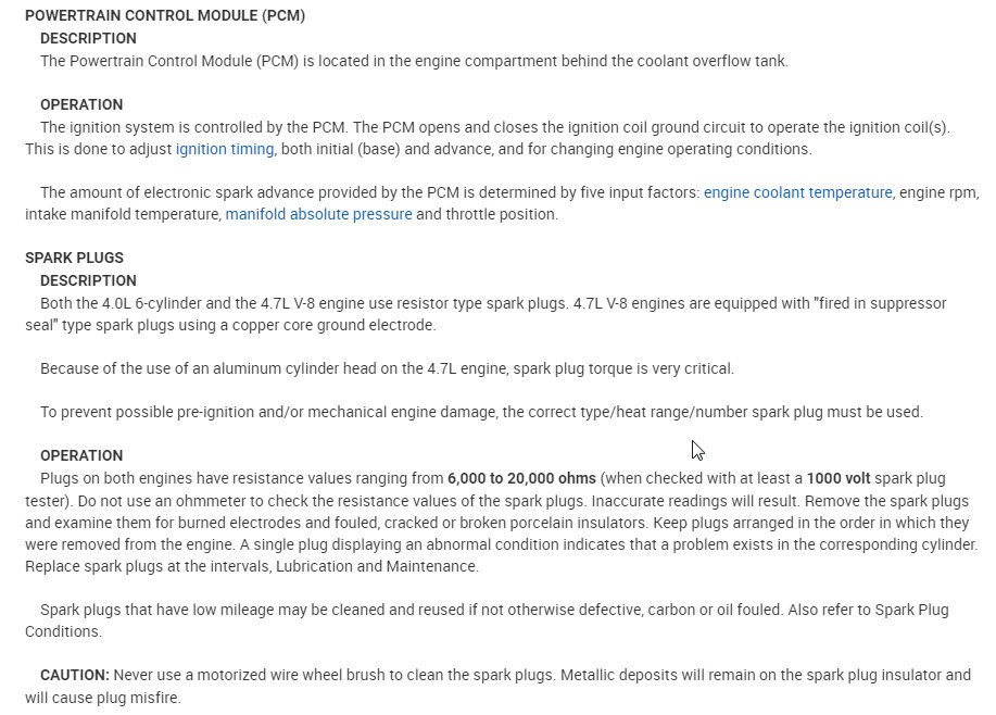

SERVICE WRITER
  • 9,123 POSTS
Okay fuel pump is fine based on The specs (44-54psi) for this one: 1999 Grand Cherokee Larado 4.0.
IS this what you have?
Does this happen when the engiine is cold or not?
Check for codes in the pcm, if possible check the O2 Sensor wave pattern.
Have any carbon removal procedures been done?
Check coil pack resistance.

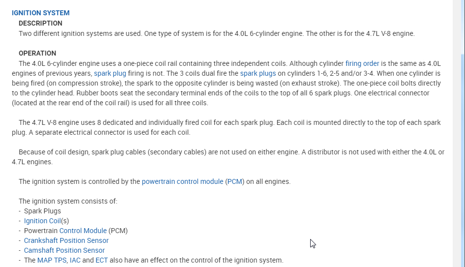

SERVICE WRITER
  • 9,123 POSTS
I guess it's a good thing it isn't the grand Cherokee.
https://www.2carpros.com/forum/automotive_pictures/30961_jee_2.jpg
I don't have a hot or a cold spec other than this. I found this on mitchell, and wanted to throw ot out there.: Cust comlaint: Rough idle in high ambient after hot soak. Clears in 30-60 SEC Cause: Exhaust heat causing fuel in #3 and #4 injector to vaporize. Repair: Install heat sleeve, PN56028371AA, on injectors Long shot, but.....
