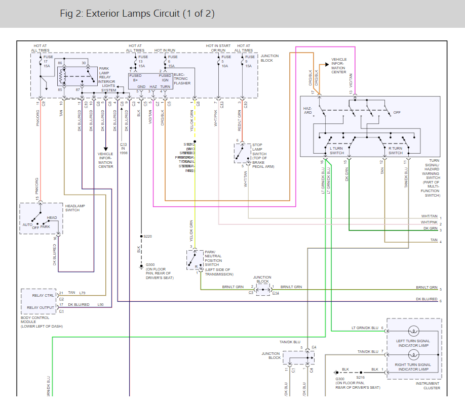

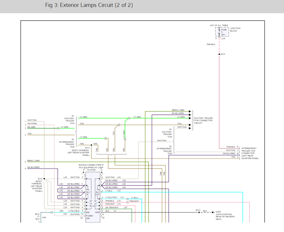

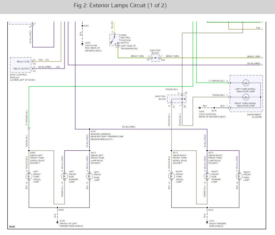

Here are the brake light wiring diagrams so you can see how the system works. Check out the diagrams (Below). Please let us know what happens.

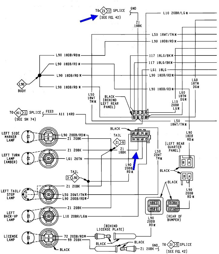

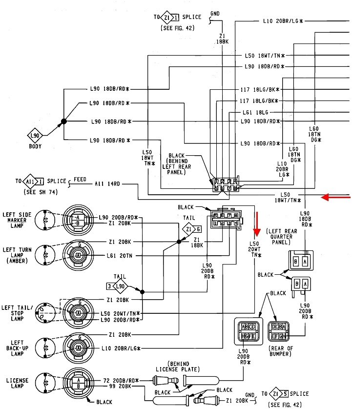

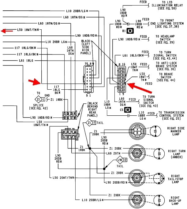

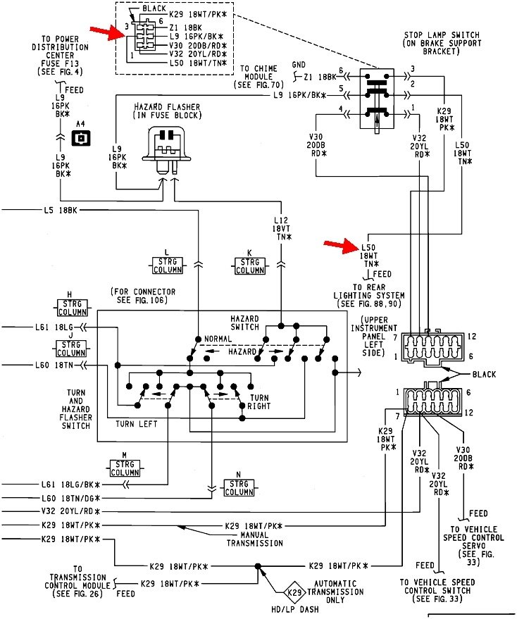

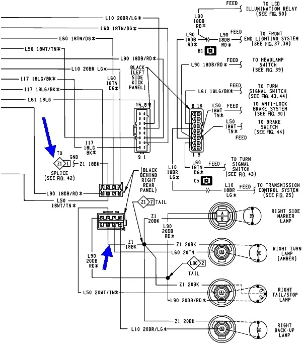

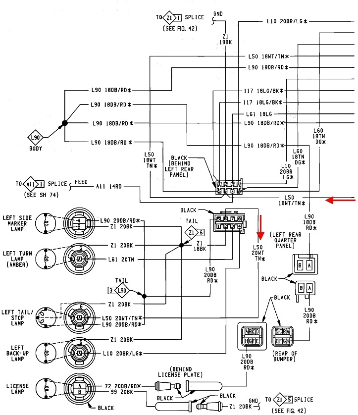

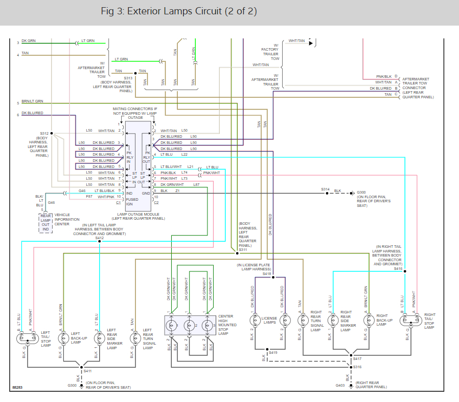

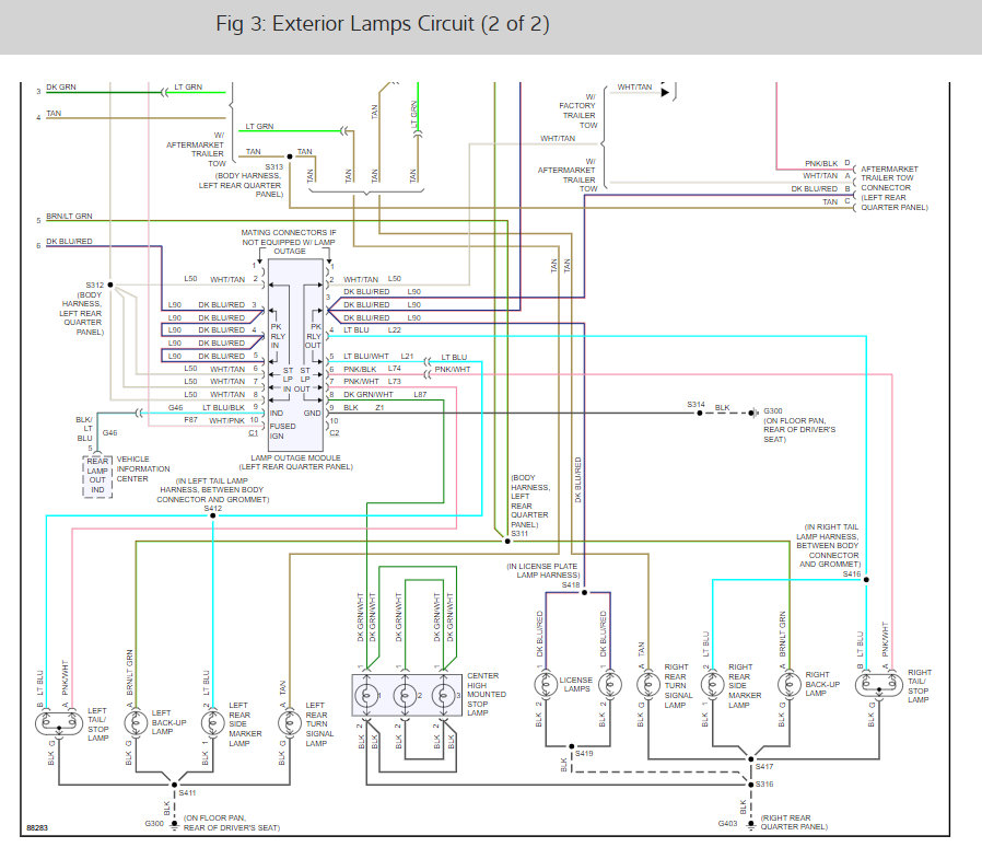

Here's the diagrams that pertain to the brake lights. They can be hard to follow until you're familiar with reading them, so I added some nifty red arrows to show the best test points and where current flows.
A good suspect, and a good place to start, is by the connector behind the driver's kick panel just to the left of your left foot. This is a good place for road salt to migrate to if you live in a state where they throw a pound of salt onto an ounce of snow, like I do.
Look for the white wire with a tan stripe. It's the third one from one of the corners. You can back-probe that wire with a digital voltmeter or a test light. It should show 12 volts when you press the brake pedal. Be sure to check both sides of that connector. If you find a wire corroded off, we'll discuss the repair. If you find 12 volts on one side but not on the other side, we can bypass the connector completely, but you should inspect it for other corrosion damage to the other terminals. This connector is shown on the third diagram.
If you have 12 volts on both sides of this connector and the wires are okay, look for the connector on the fourth diagram. That one is listed as behind the left rear trim panel. Look there for the same white / tan wire and check on both sides of that connector.

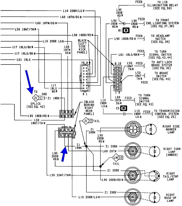

You are absolutely correct. I derailed myself by thinking about the center brake light that you don't have. What you described originally is the classic symptom of a bad ground at the rear. Thanks for setting me straight.
One thing to look at first is with the head lights off, press the brake pedal, then observe if the front running lights turn on. Alternately, turn on the radio, then observe if the display dims when you press the brake pedal.
Here's where I'm going to add some unnecessary confusion. Most vehicles have two separate grounds for the rear lights. One is on the left side and one is on the right side. When one of them is broken, it is only the lights on that side that have the symptom, but the glaring clue is that symptom changes dramatically when you unplug the bulb on the good side. That's not the case here. On your vehicle, the diagrams show the two grounds go through their own connectors on each side, but then they come together in a splice. I'm still looking for that splice on a diagram. My suspicion is that single ground wire after the splice is where the break is.
The reason the rear lights appear to work at times is current can't find its normal path to ground, but it is finding an alternative path through the interconnected tail lights and front running lights, then to ground in the front. That puts half the voltage on the front lights when they should be off, and that 6 volts can be enough to falsely tell the radio you turned the head lights on and it is supposed to dim the display. The rear lights won't be at full brightness when this happens.
Nov 12, 2020 at 12:27 PM (Merged)

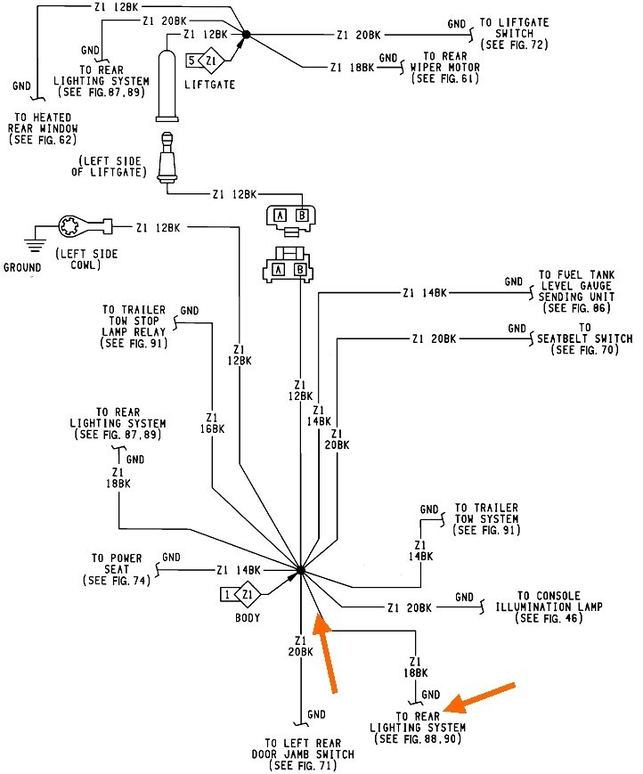

CARADIODOC
  • 34,307 POSTS

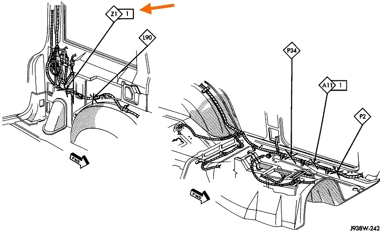

The top blue arrow in each of the first two diagrams point to the individual ground wires, and that they come together in splice "Z1". That's shown in the third diagram. You can see on that one there's a lot of other systems using that same ground, so if the fuel level reads right, and the power seats or seat belt warning system work properly, that ground has to be okay. All that leaves is the single wire between the two orange arrows.
The fourth drawing shows the location of the splice. That is the logical area to find the ground screw too.
You could have the same set of symptoms if the two individual ground wires were both broken, but the chance of that is less likely than having one broken wire that affects both sides.
If you don't see something obvious behind these trim panels, we'll have to do some testing to find the broken wire. The two 8-pin connectors are behind these panels too. The wires in them will make good test points.
