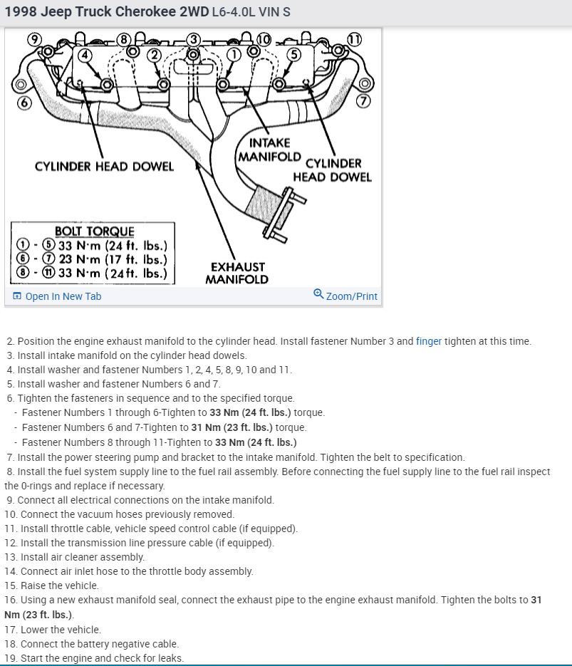

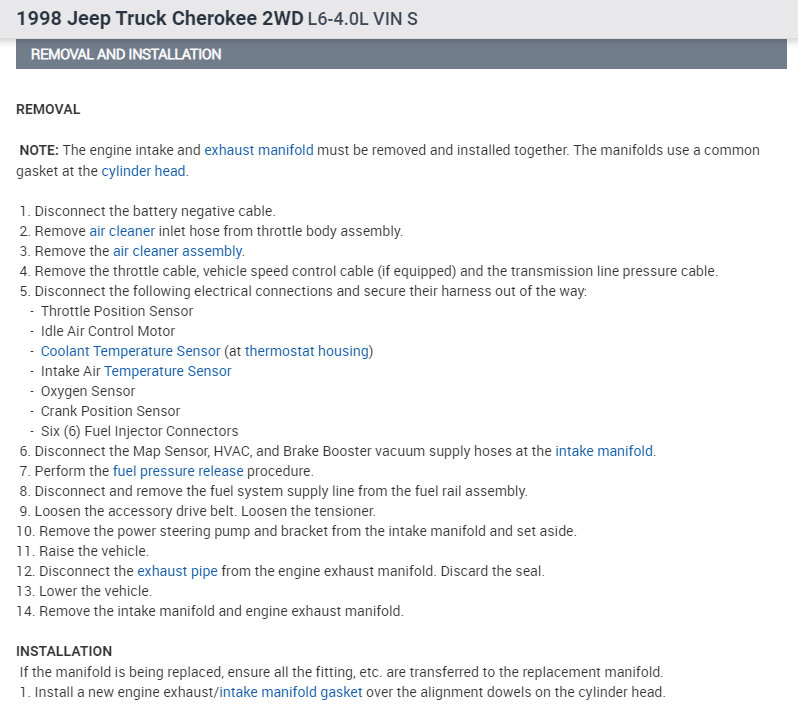

I have attached diagrams for the replacement instructions below.
Thank you.
