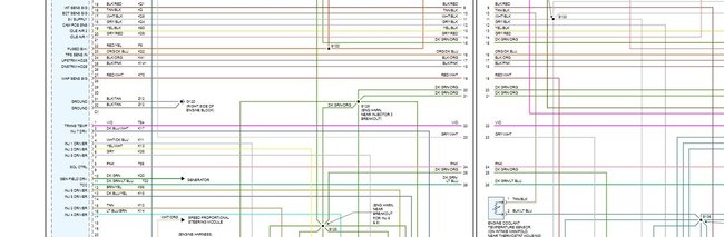

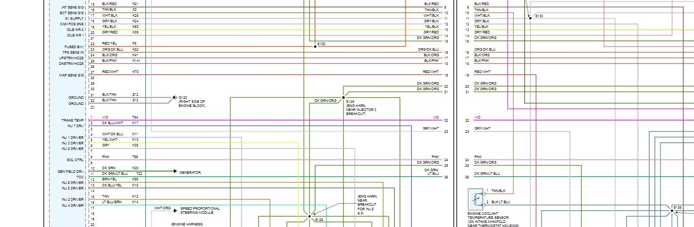

If they replaced the coolant temperature sensor and it continues to comeback get the wiring and computer checked out-
Heres a guide on testing wiring
Attached below is the wiring for the coolant sensor so you can test it

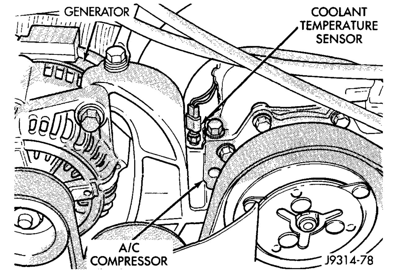

Are you driving Grand Cherokee? CTS sensor should be on or near the thermostat housing. The guage sensor is typically on the back of the block, or on the intake manifold.

The CTS is on the intake manifold near thermostat housing.
The engine coolant level sensor on the right rear corner of the engine.
