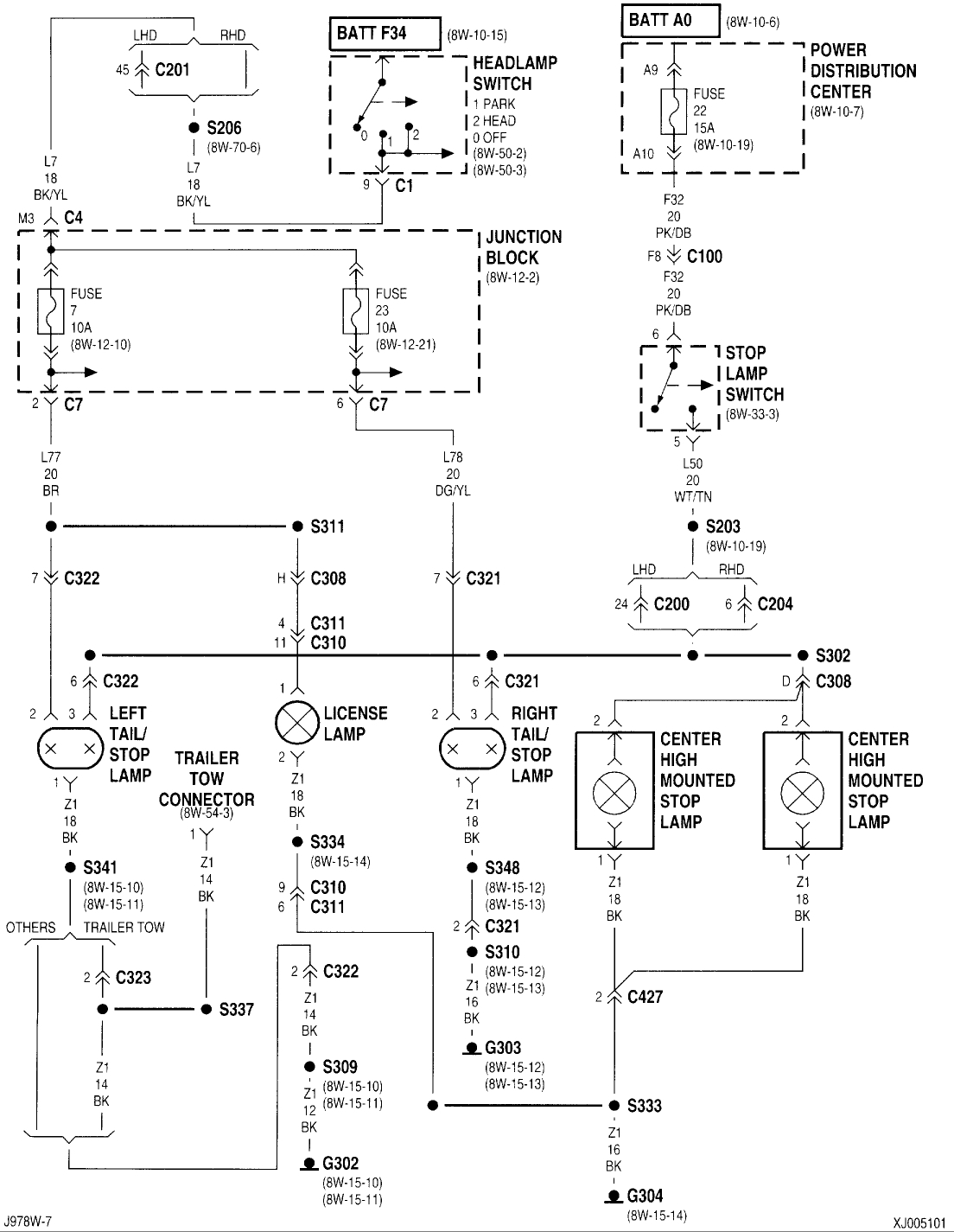

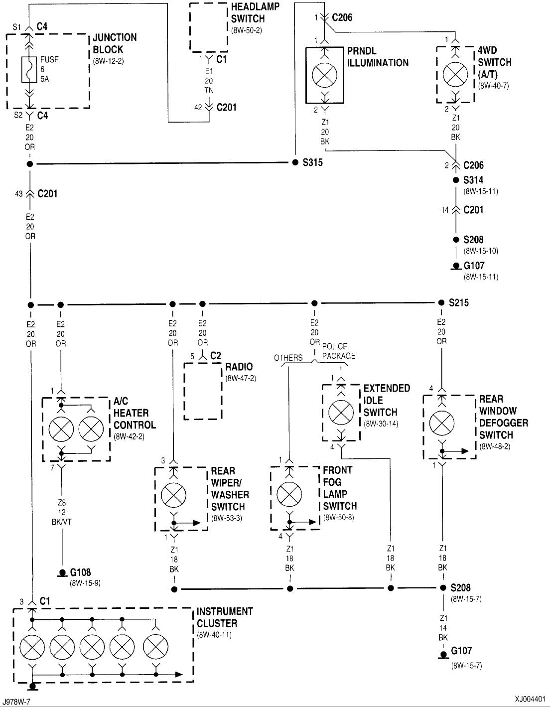

Here`s the exterior lights wiring schematic for your Jeep I will send it full size to your E-Mail! good Luck and let me know if you need assistance to read it and we will follow it !!

Hello !!
I`m back!

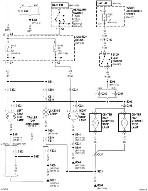

well, we`re going to start checking the tow connector, get a Light tester (12 volts) and check the brown wire (#3 second from the left) that`s the (+) to the tail lights brown wire...
if you have light there then the switch its sending the signal to the back and the problem should be .. a missing ground (-) Black wire or bad light bulbs..
check that to start and let me know..
i`ll send you an schematic with a trailer tow to your Email at full scale that way we can follow each other.

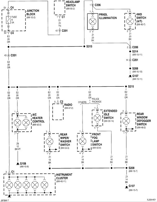

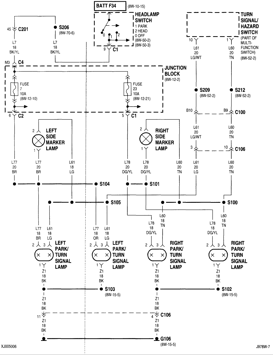

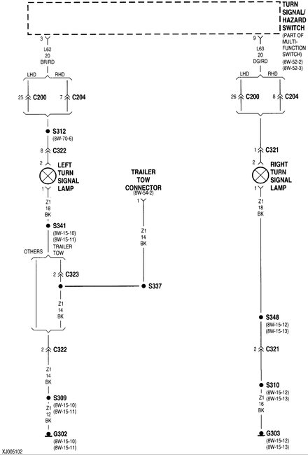

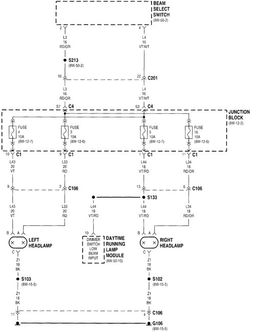

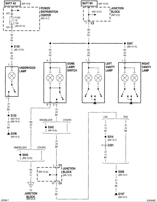

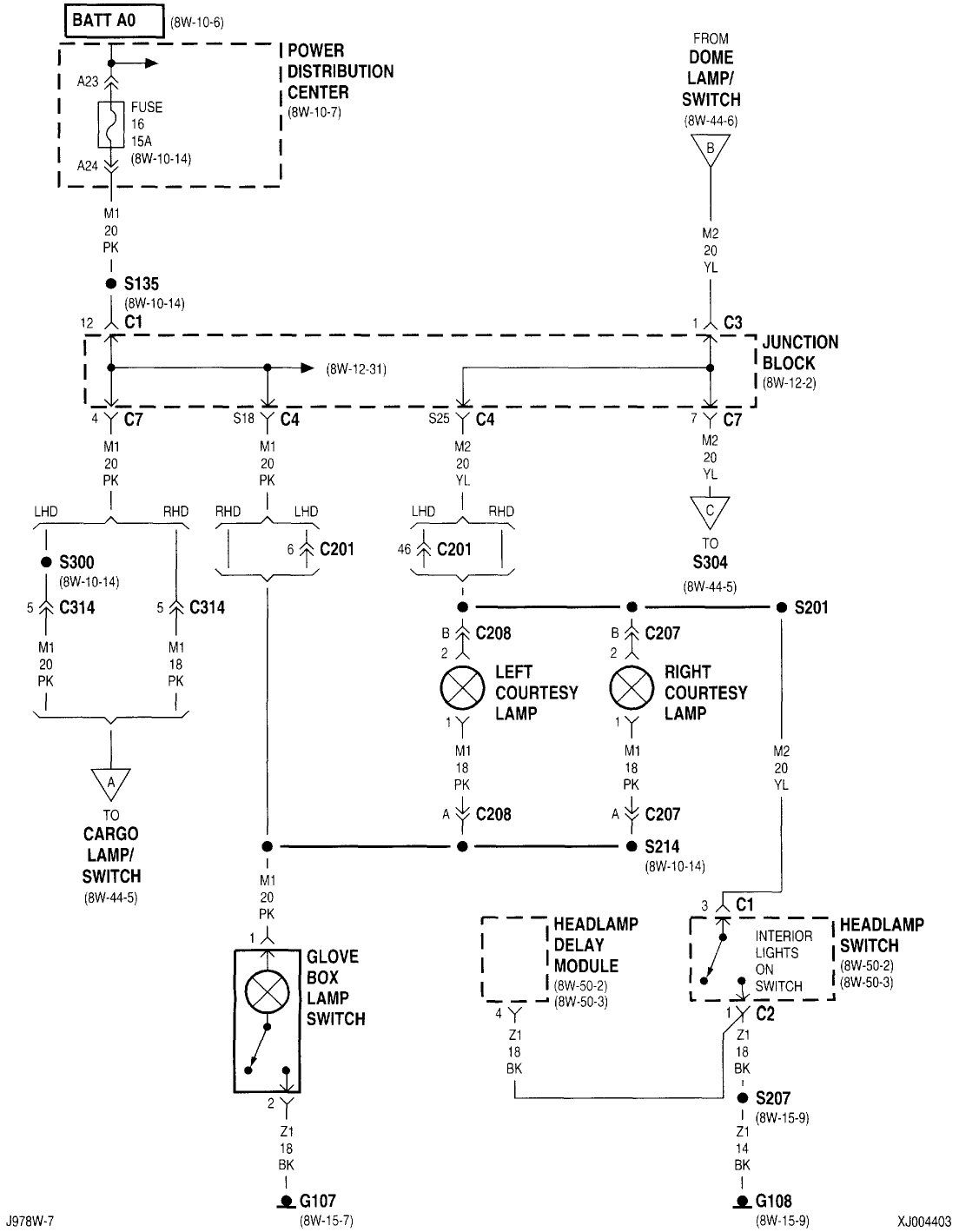

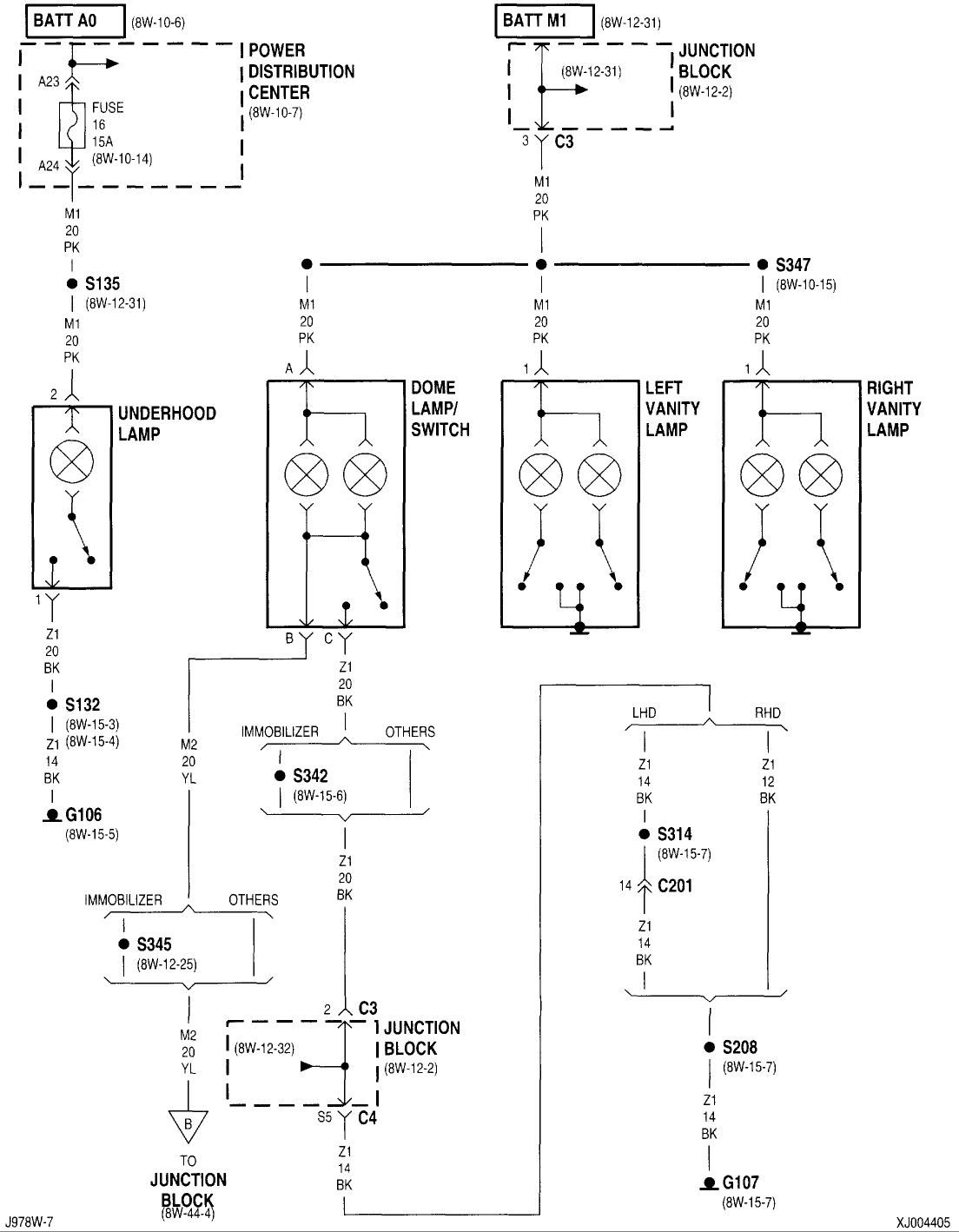

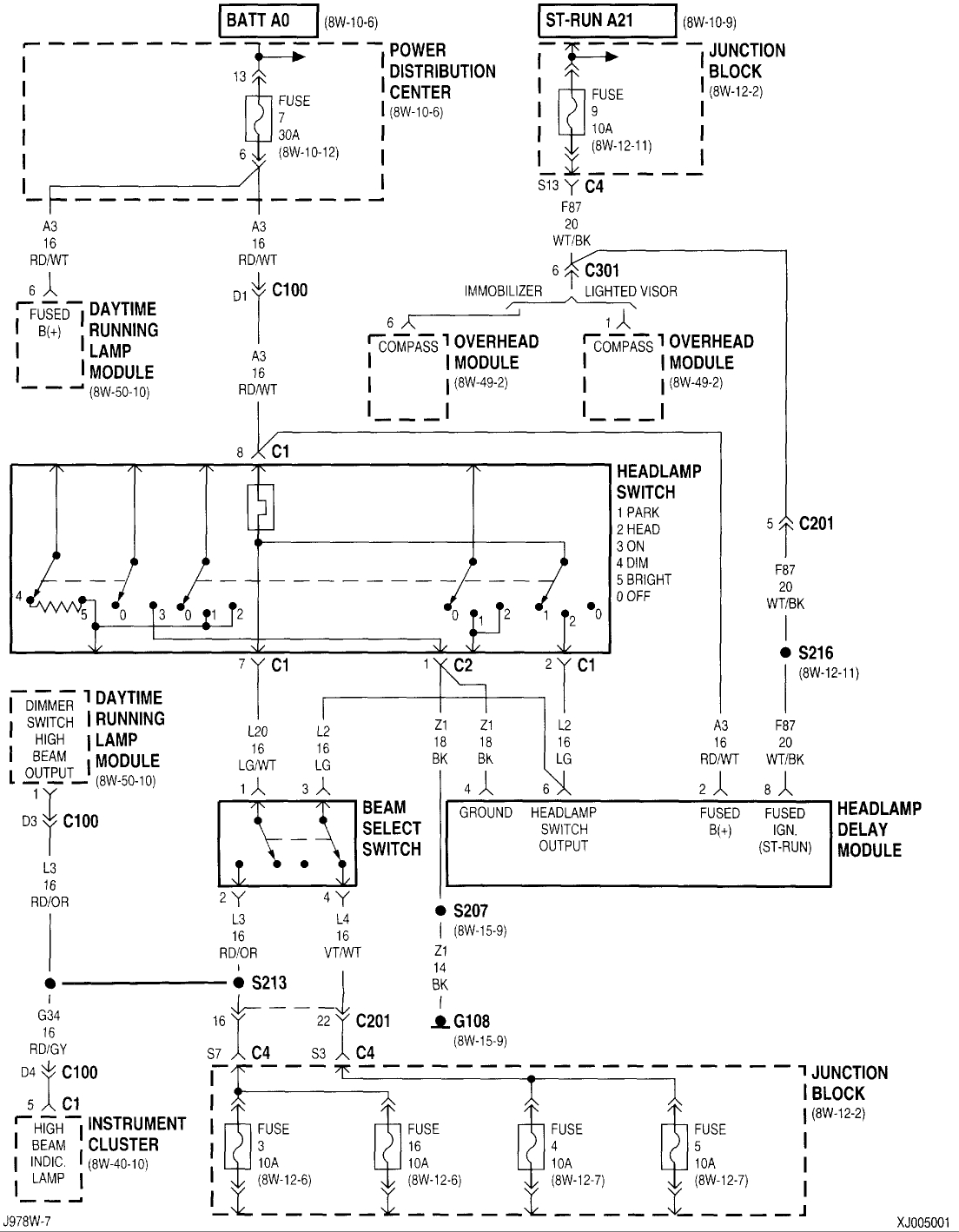

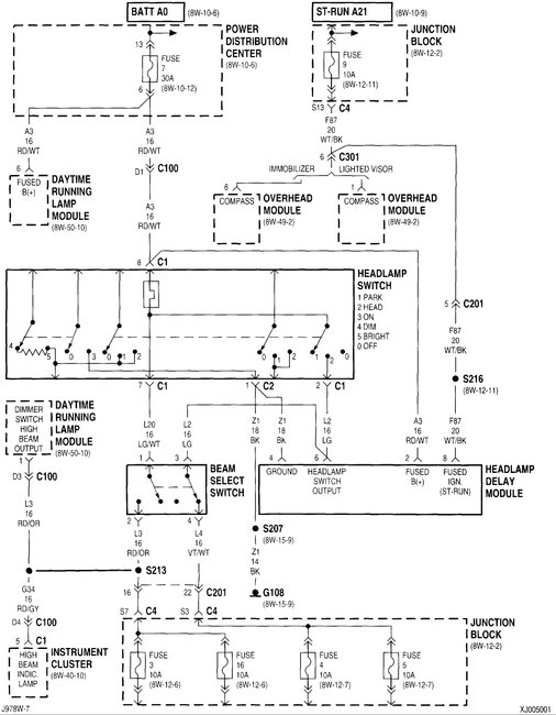

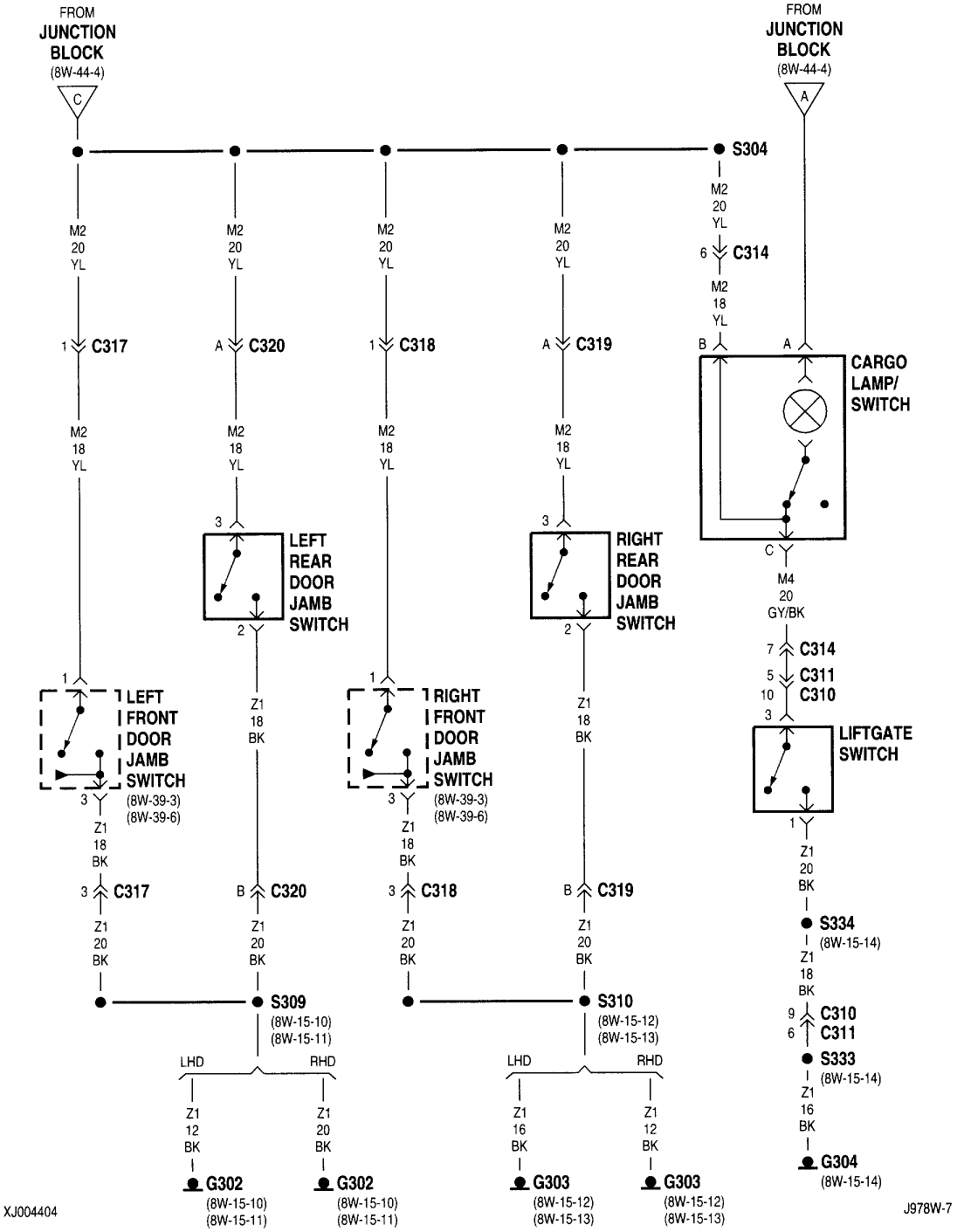

These are the exterior and interior lighting schematics for the 99 Cherokee. US LHD
