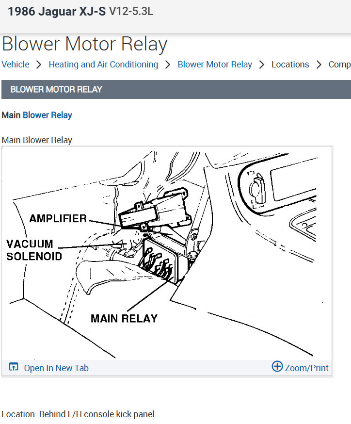

Here is a guide so you can check the blower motors. I have seen the main blower relay go out on these cars, here is the location for that so you can swap it out.
https://www.2carpros.com/articles/how-to-test-an-automotive-hvac-system-blower-fan-motor-a-detailed
