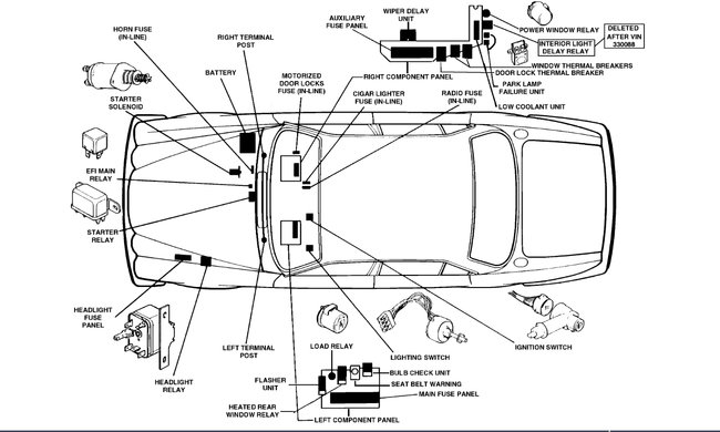

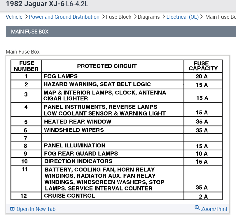

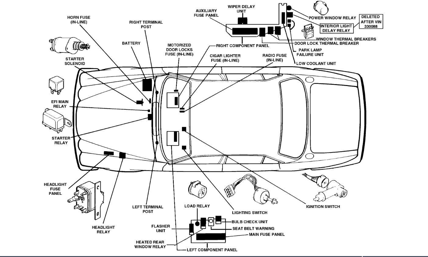

Is sounds like you lost a #4 fuse or EFI relay. Here is a guide to help you check the fuses and relay long with the relay and fuse locations below:
and
