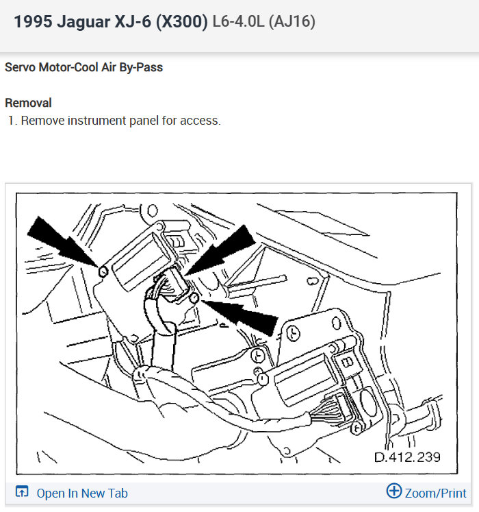

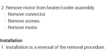

It sounds like the "Servo Motor-Cool Air By-Pass" is not working which has a common failure in this car, here is the location of the servo motor so you can swap it out which should fix the problem. Also please go over this video as well.
https://www.youtube.com/watch?v=SNRb6pSwYuU&t
