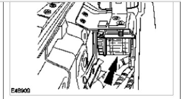

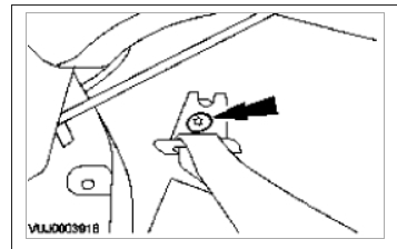

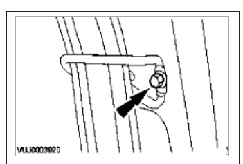

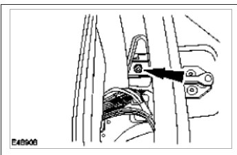

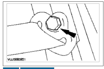

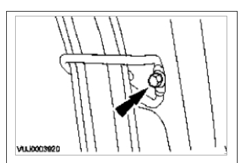

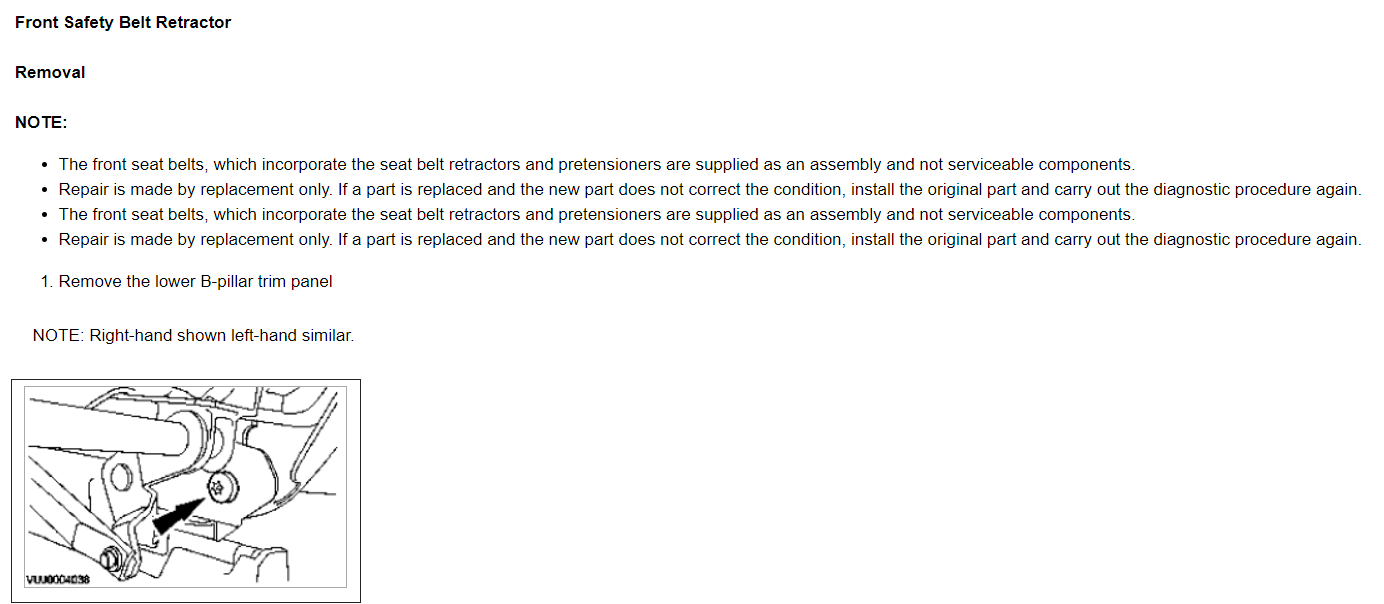

How can I remove the driver and passenger seat belts. The locking device is not working?
Feb 2, 2010 at 10:30 AM
DAVE H
  • 13,384 POSTS
Here are diagram to let you see how the seat belt reactor is removed (below)
