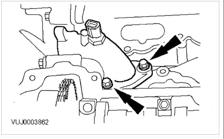

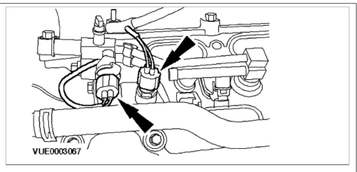

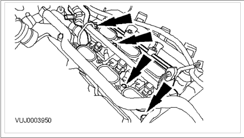

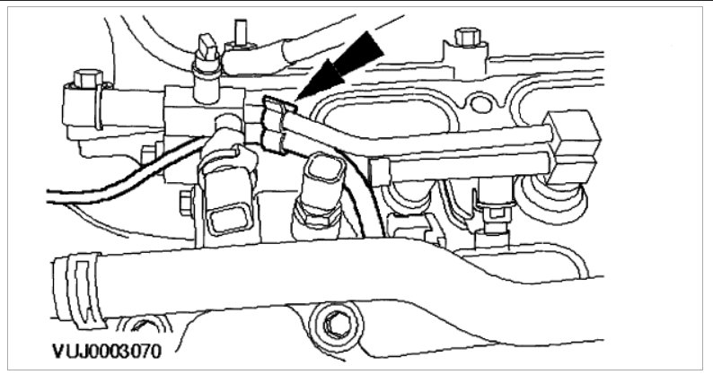

Disconnect the engine coolant temperature (ECT) and fuel temperature sensor (FTS) electrical connectors.
Disconnect the electrical connector.
Detach fuel sensor vacuum line.
Detach the fuel charging wiring harness.
WARNING:Fuel may still be present in the fuel injection supply manifold, extreme care must be taken as this could cause personal injury.
Detach the fuel injection supply manifold, lower intake manifold and place to one side.
Remove and discard the lower intake manifold seals.
Remove the fuel injection supply manifold and lower intake manifold.

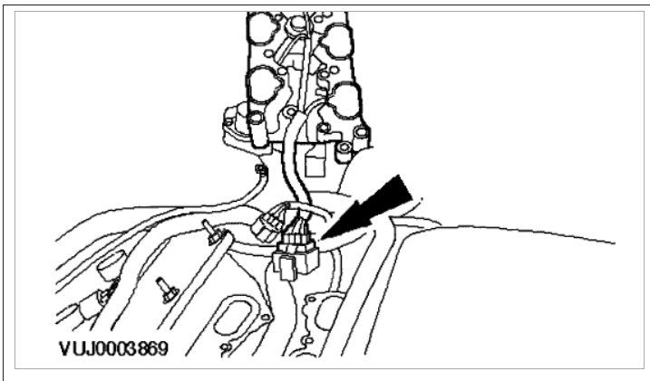

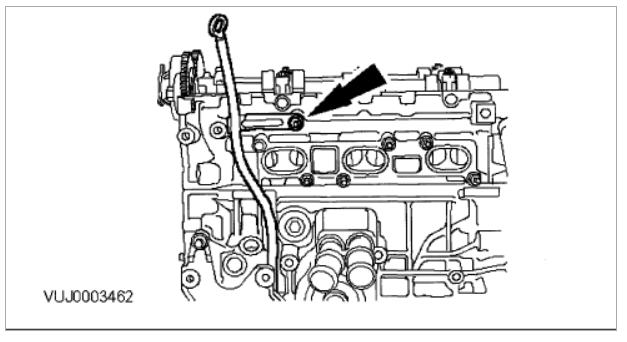

Remove the oil level indicator tube.
Remove and discard the oil level indicator tube O-ring seal.
Remove the water pump outlet pipe.
Remove and discard the water pump outlet pipe O-ring seals.
Remove The Coolant Bypass Tube.
Remove and discard the coolant bypass tube O-ring seals.
Remove the exhaust manifold.
Remove and discard the exhaust manifold gasket.

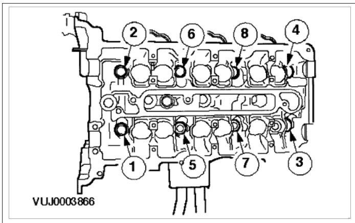

NOTE:Remove the bolts in the indicated sequence.
Remove the cylinder head.
Remove and discard the cylinder head gasket.

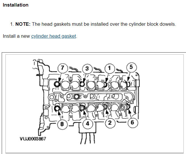

NOTE:The head gaskets must be installed over the cylinder block dowels.
Install a new cylinder head gasket.
CAUTION:Use care when installing the cylinder head. Damage to the cylinder block, cylinder head or the cylinder head gasket may result.
NOTE:Make sure the cylinder head is installed in its original position.
NOTE:Tighten the bolts in the indicated sequence in six stages.

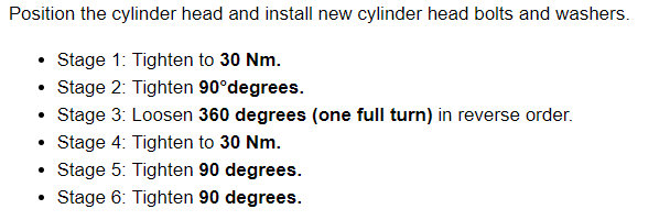

Position the cylinder head and install new cylinder head bolts and washers.

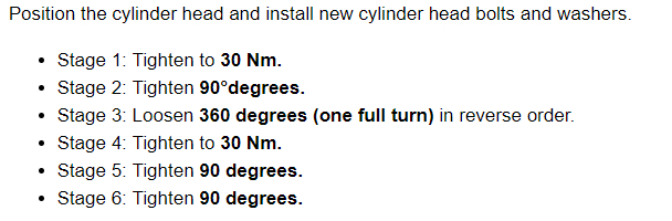

Stage 1: Tighten to 30 Nm.
Stage 2: Tighten 90 degrees.
Stage 3: Loosen 360 degrees (one full turn) in reverse order.
Stage 4: Tighten to 30 Nm.
Stage 5: Tighten 90 degrees.
Stage 6: Tighten 90 degrees.

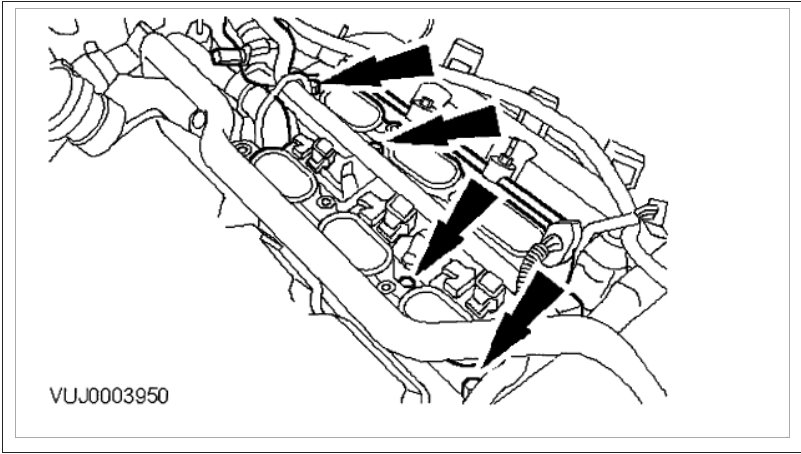

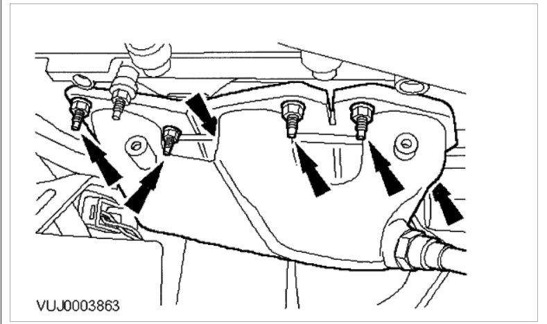

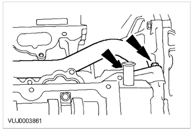

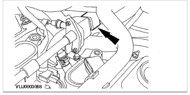

You will need to disconnect the battery to start, drain the coolant and when you get the heads off have them resurfaced. You can get the head gasket set at Rock auto or amazon.
Here is step by step how to remove the cylinder heads and the bolt torque specs.
Check out the diagrams (below).

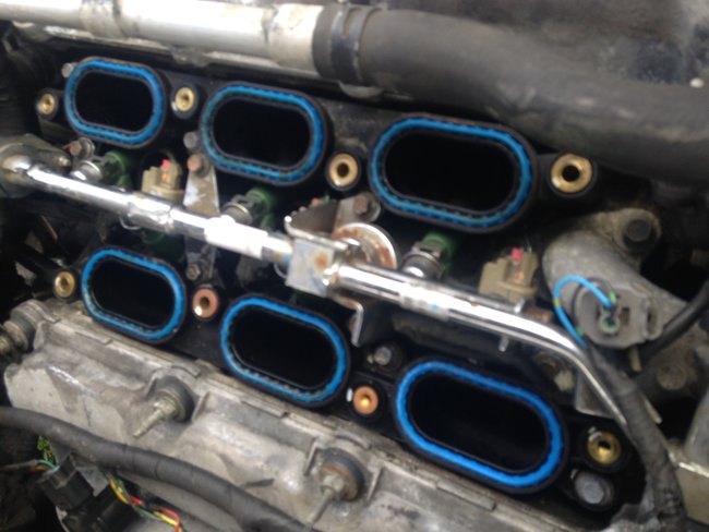

this is how far i have gotten everything is so clean a dry. what is going on?

what were the symptoms? with the engine part dismantled you cannot do any further diagnosis to see what is going on.
