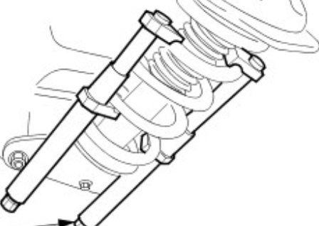

Would you compress these using strut compressors?
Sep 15, 2021 at 7:53 AM
SQM
  • 6,383 POSTS
Yes, that type of spring compress toll will work.
Just remember when you use these spring compressors, you want to turn each one of the arm few turns at a time. Do few turns on one then few on the other, back and forth. You don't want to compress one of the arms too much as it can have uneven pressure and pop out.
