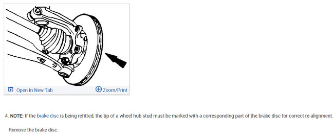

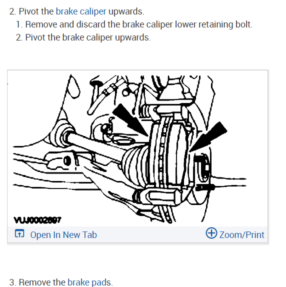

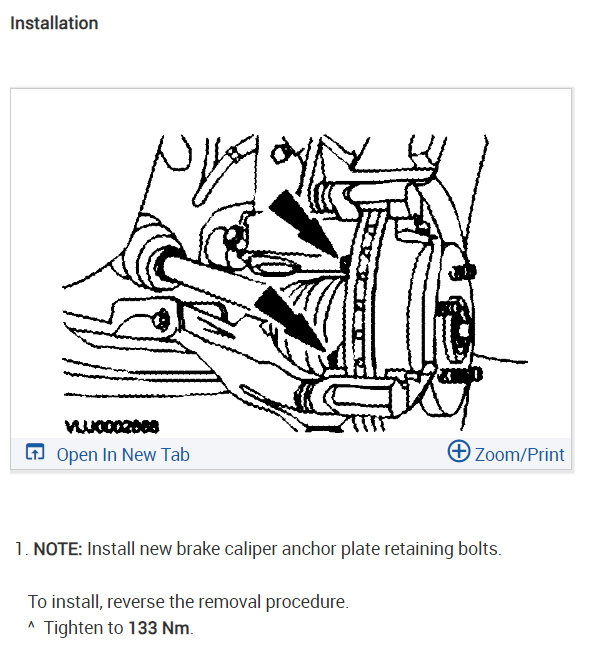

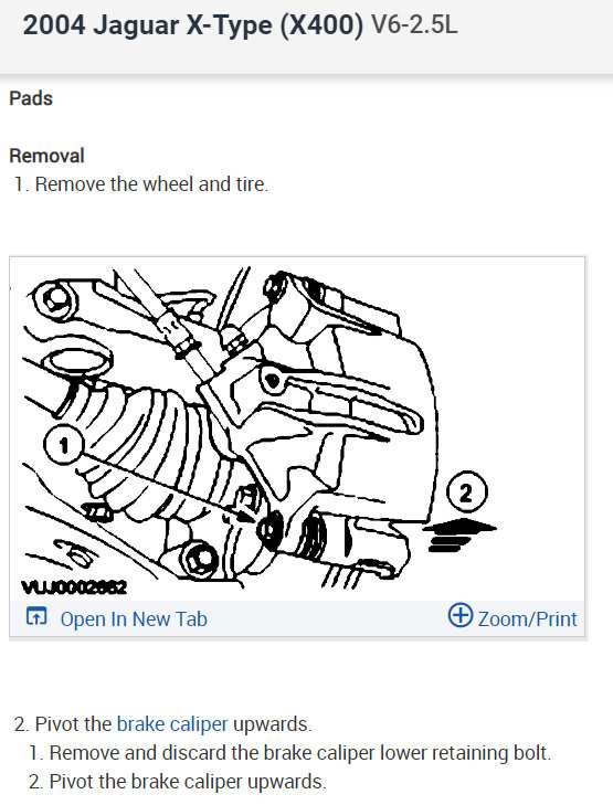

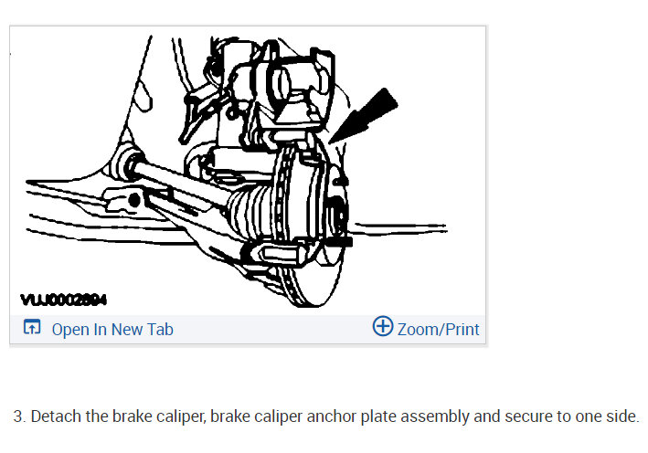

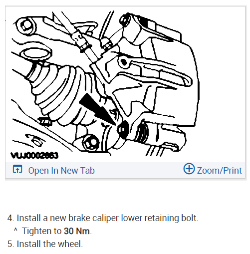

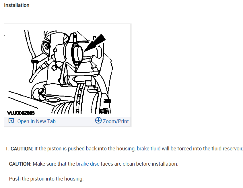

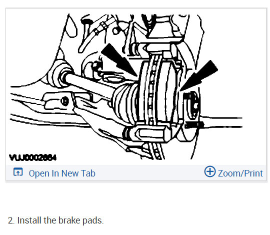

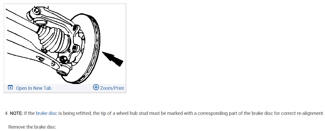

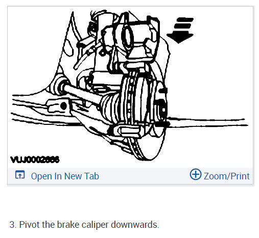

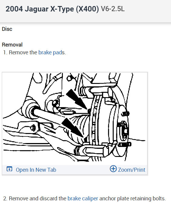

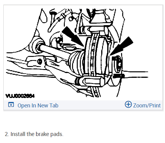

That should be fine, it only has 32k, I would think the front brake pads need to be replaced because the warning screemers are touching the brake rotor. Here is how to replace the front pads a rotors in case you want to do the job yourself. Check out the images (below). Let us know how it goes
