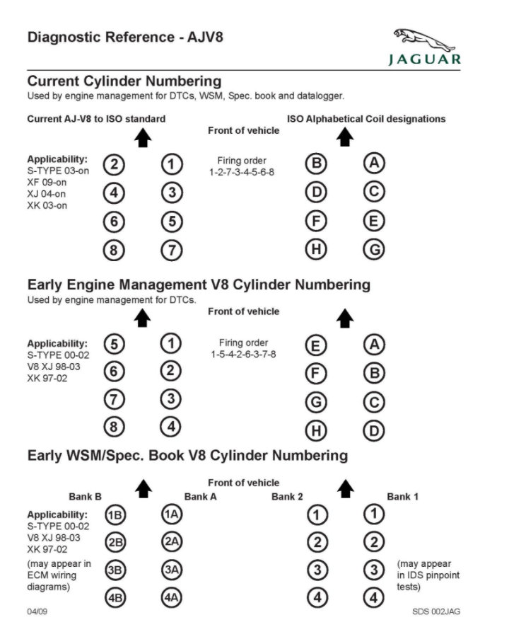

What is the firing pattern on the S type 4.0? Code says that I am missing on 1 and 3 becasue of "Air injector control malfunction" I'd like to swap coils to see if the problem follows them.

Here is the firing order for your car (below)
