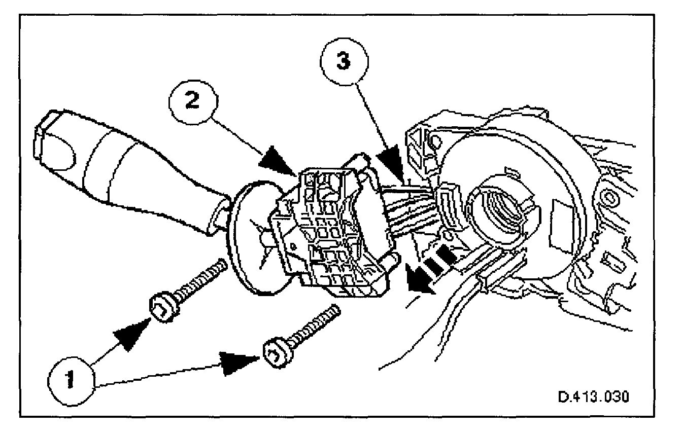

Here are directions for removal of the switch. The attached pics correlate with the directions.
________________
1999 Jaguar XJ-8 Sedan (X308) V8-4.0L (AJ27)
Flasher/Headlamp/Trip Switch
Vehicle Sensors and Switches Sensors and Switches - Lighting and Horns Combination Switch Service and Repair Procedures Flasher/Headlamp/Trip Switch
FLASHER/HEADLAMP/TRIP SWITCH
Removal
1. Disconnect battery ground cable.
2. NOTE: Steering wheel must be in straight ahead position.
Remove steering wheel.
pic 1

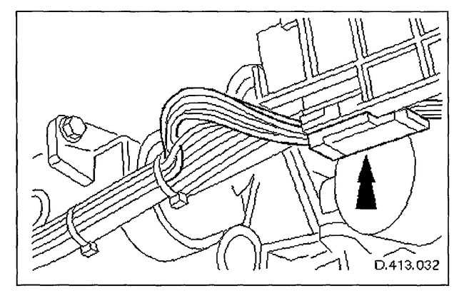

3. Displace cancellation module connector from mounting bracket and disconnect.
pic 2

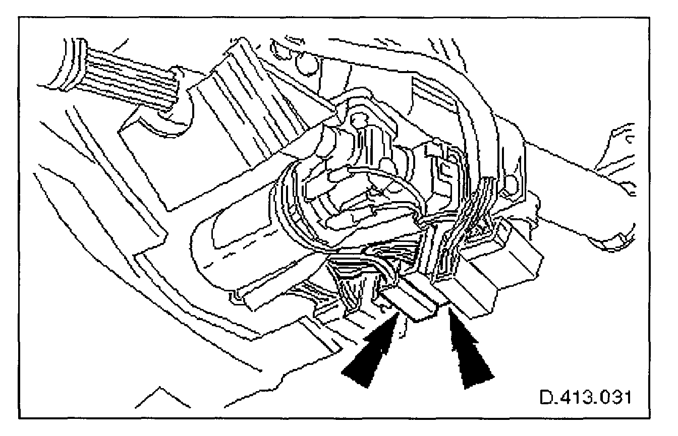

4. Displace flasher/headlamp/trip switch connectors from mounting bracket and disconnect.
- Cut and remove appropriate harness securing ties.
pic 3
5. Remove switchgear.
1. Remove two screws which secure switch assembly/cancellation module to mounting bracket.
2. Displace switchgear from mounting bracket.
3. Route switchgear harness through mounting bracket and remove switchgear.
