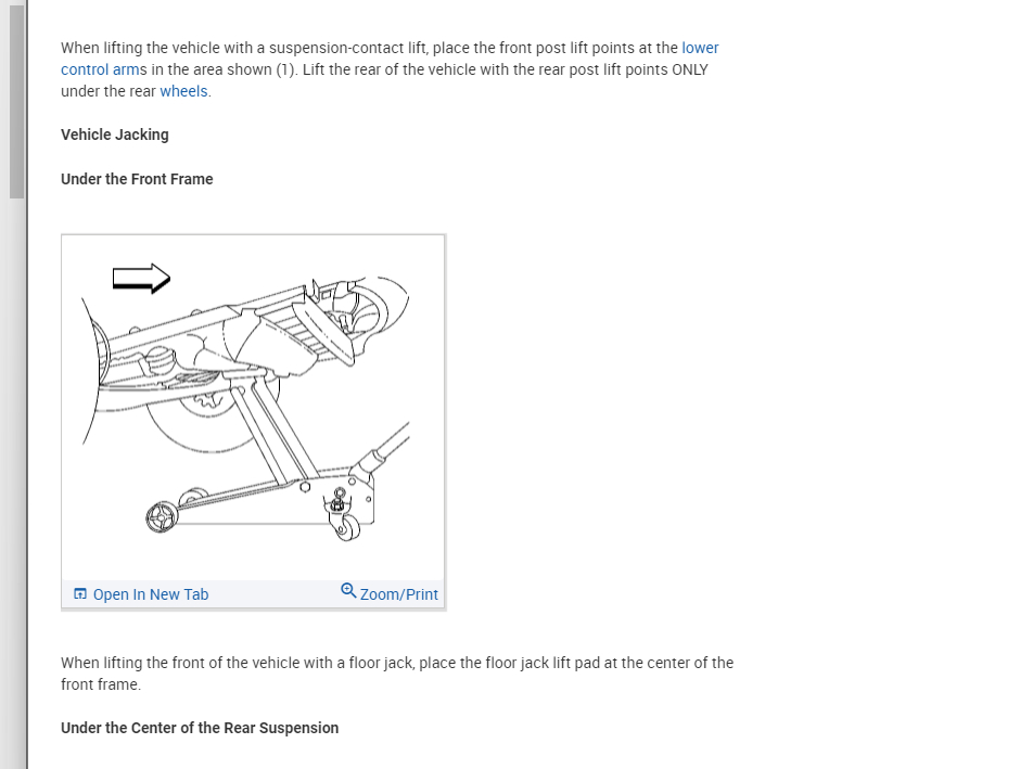

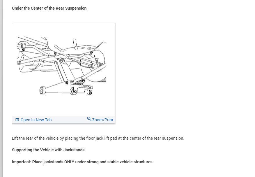

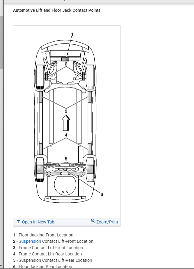

Where can I place my floor jack to lift my car so that;
1. lift both front tires.
2. lift both rear tires.
3. lift both side tires.
If possible, pictures would be appreciated.
