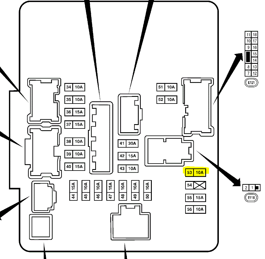

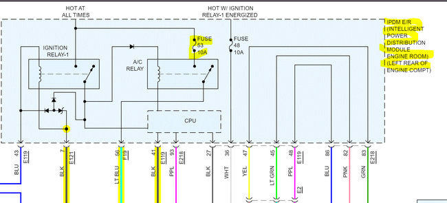

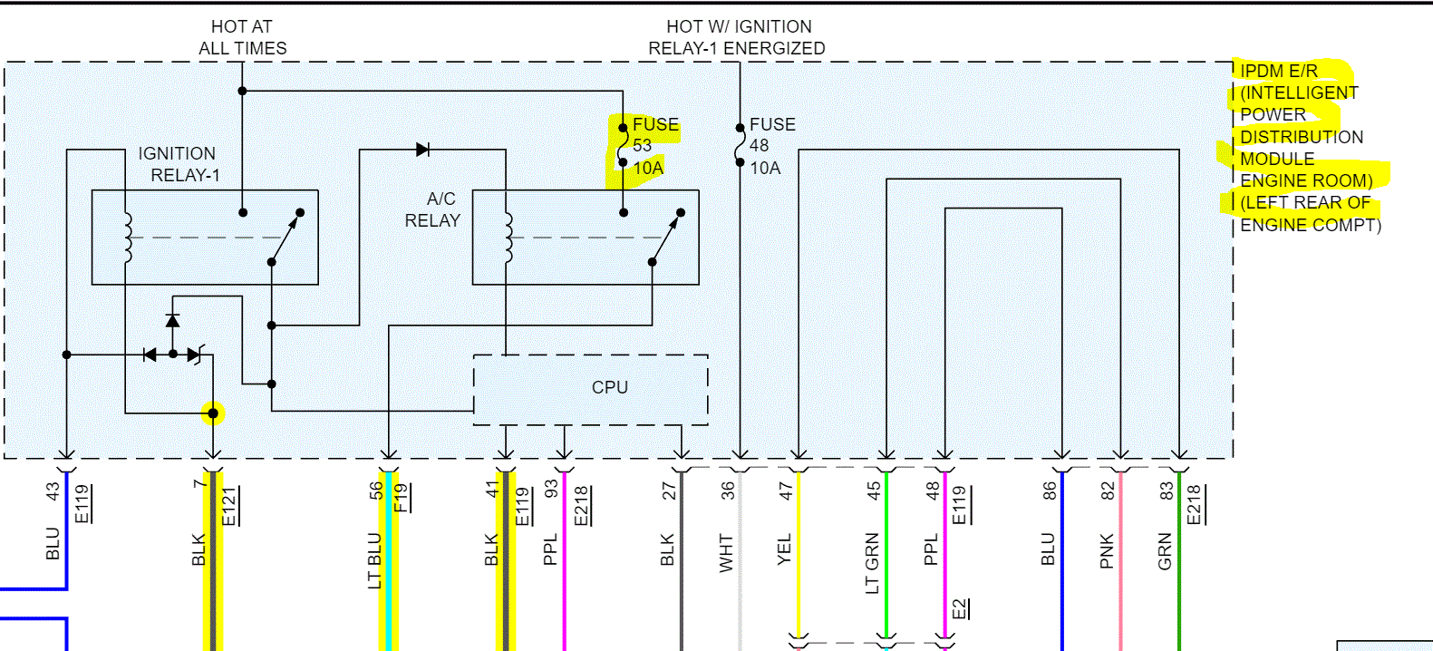

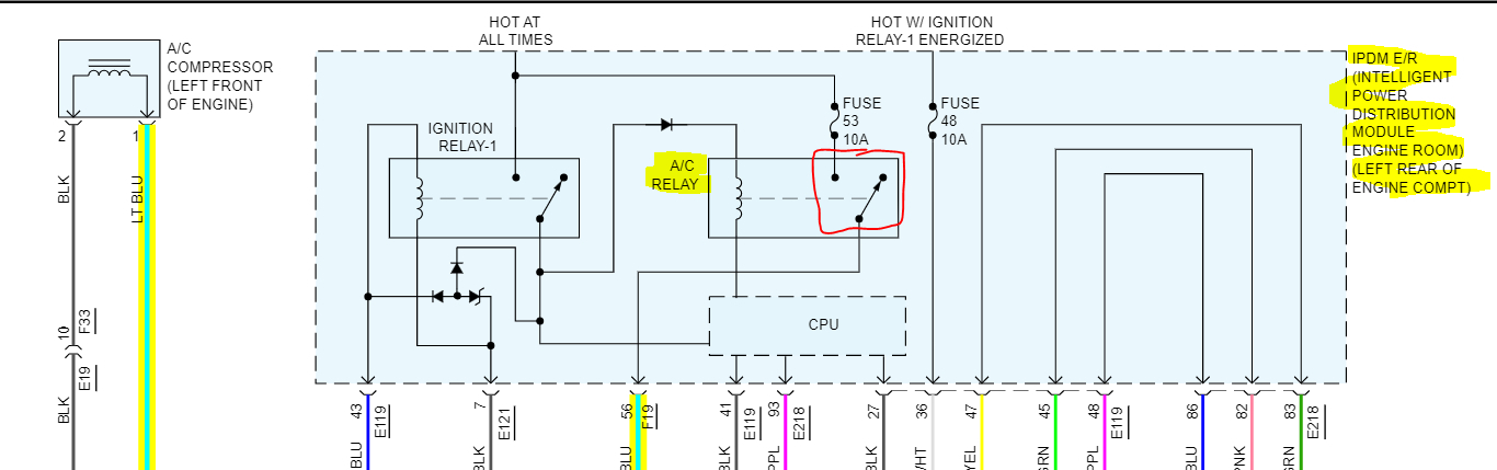

The first thing I recommend is to check fuse 53 in the intelligent power distribution module. This is the fuse that powers the A/C compressor clutch coil. If it failed, the compressor won't engage.
When you check it, confirm the fuse is good and also confirm there is power to and from it. Here is a link you may find helpful:
Also, take a look through this link and let me know if anything helps:
https://www.2carpros.com/articles/car-air-conditioner-not-working-or-is-weak
Below, pic 1 shows where the IPDM is located, pic 2 shows the fuse to check, and pic 3 is the fuse box wiring schematic.
Let me know what you find or if you have other questions
See pics below.

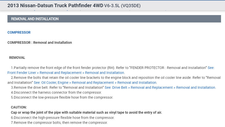

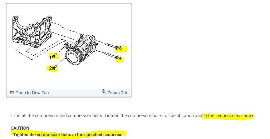

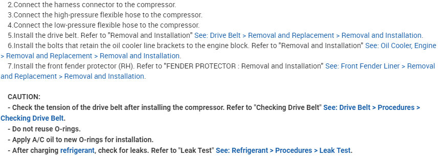

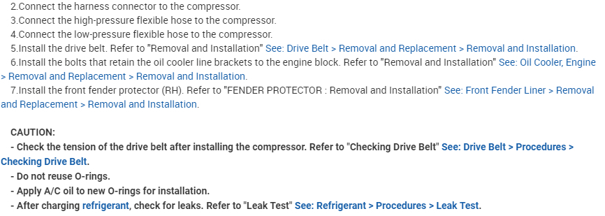

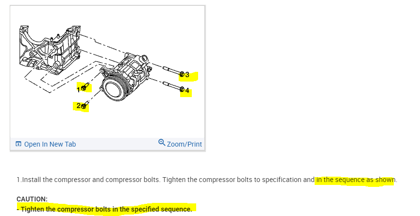

No problem whatsoever. I'm glad you're back. As far as replacing the compressor, I attached the manufacturer's procedures below. They are somewhat vague. For example, they don't explain how O-rings are replaced or adding PAG oil or anything like that. So, here is a link that will explain those things to you:
https://www.2carpros.com/articles/replace-air-conditioner-compressor
If you look below, I attached the directions from my manual. Take a look through things and let me know if you have questions or if it helps.
See pics below. Note: If the original compressor had internal damage/failure, the system will need to be flushed.
Oct 4, 2023 at 5:25 PM

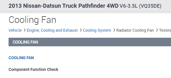

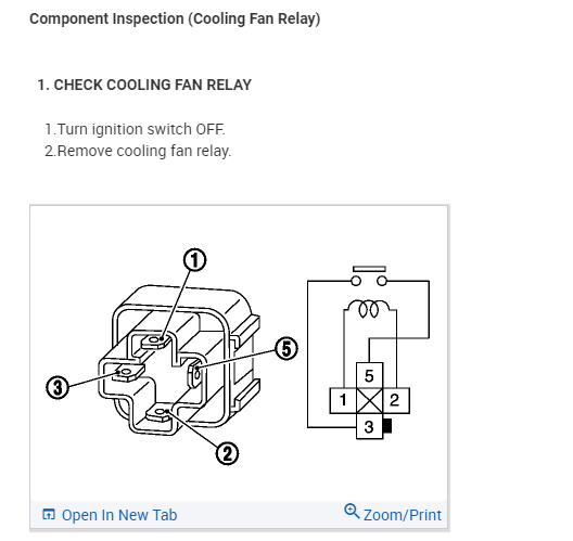

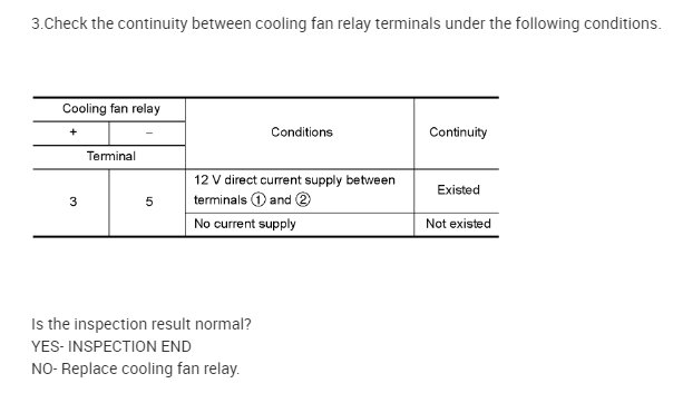

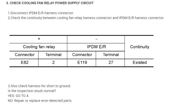

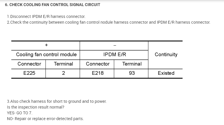

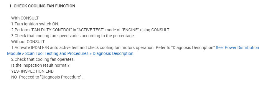

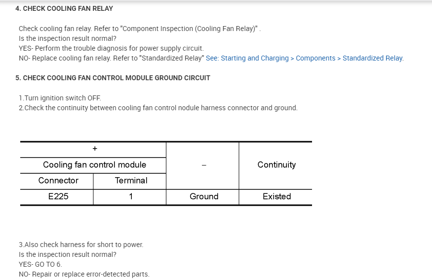

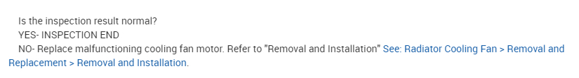

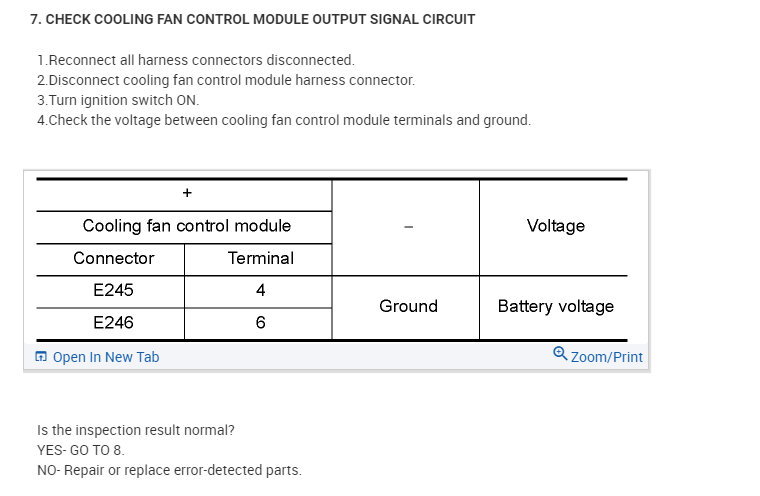

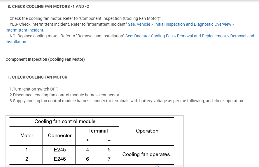

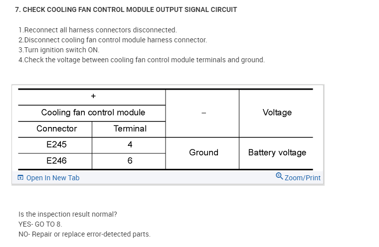

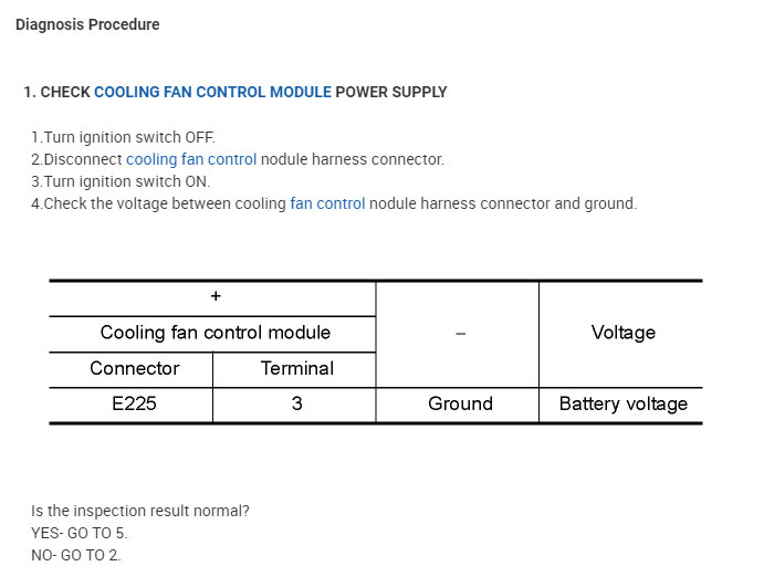

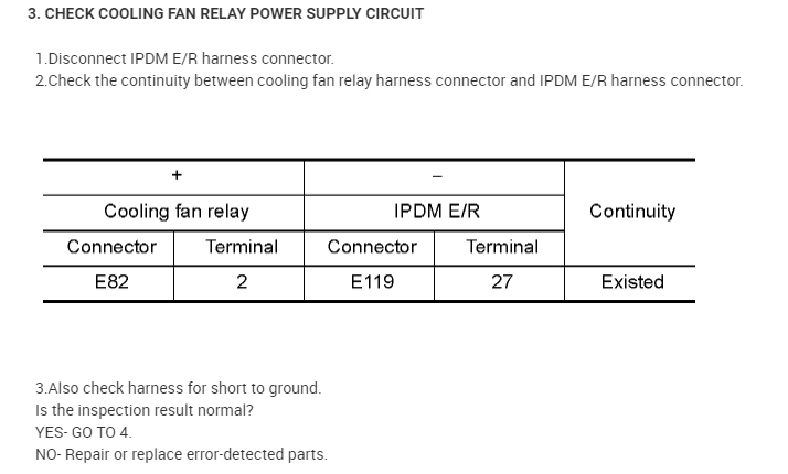

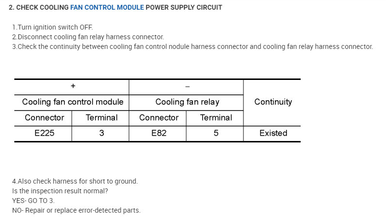

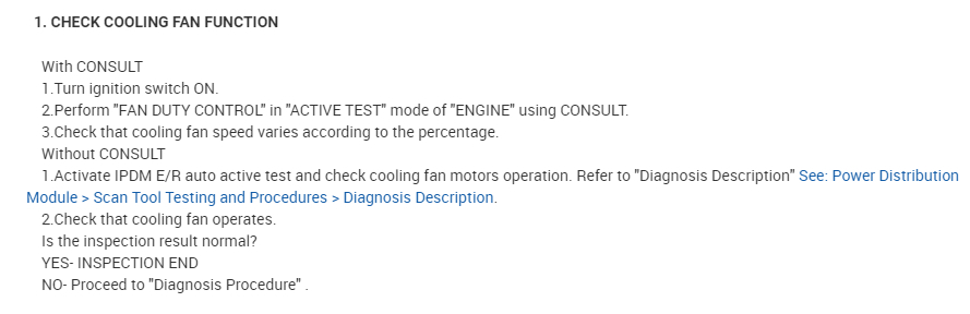

Ashely, if you let the vehicle sit and idle, will the engine overheat? I'm not suggesting you do that, but once a specified coolant temperature is reached, the cooling fan should turn on.
If it will overheat, then we need to check a few different things. I attached the diagnostics for the fan motor below. There are several different tests. Some require the use of a scan tool that can communicate with the vehicle. Take a look through them and let me know if you are comfortable performing them.
See pics below.
Oct 7, 2023 at 9:24 PM

Joe, yes if it sits idle long enough it will start to overheat. No fans kick on at any point.
What are the first two images that you put? I’m a little confused on how to do that? The others I can do.
Oct 8, 2023 at 3:40 AM
The first two pics are the first test. A bidirectional scan tool is needed. Basically, the scan tool tells fans to turn on. It is used to see if the electronics between the power supply and fan motors are working.
I have a question. I realize that many of these tests require specific tooling. That is what makes it difficult for most people to do at home. Do you have a scan tool that can communicate with the different modules on the vehicle?

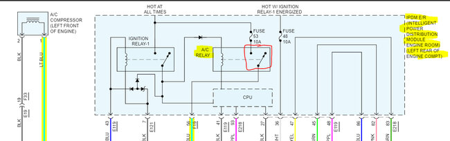

If that is with the system off, the pressures should be equal or close to it. They call that (at rest) static pressure.
I would like to try to engage the compressor, but I'm somewhat concerned if there is no pressure on the low side. Once it is engaged, we could see if the pressures change to where they should be.
If you want to try it, just don't allow the compressor to stay engaged for too long, just enough to see what the pressures do.

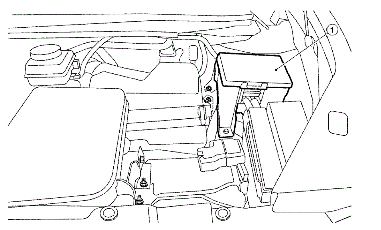

I attached a pic below showing the compressor relay. On the relay, you will find four pins. On the plastic portion, there will be four numbers, 85, 86, 87, 30. If you place a jumper wire into pins 30 and 87, that will send power to the compressor clutch, and it should engage. If you are comfortable doing it, just make sure to wear eye protection at a minimum. You should be fine, but I'm not sure what is happening yet.
Here is a link that explains how to test a relay and its circuit. It provides a more detailed explanation of the circuits.
Let me know your thoughts and questions.
See pic below.
