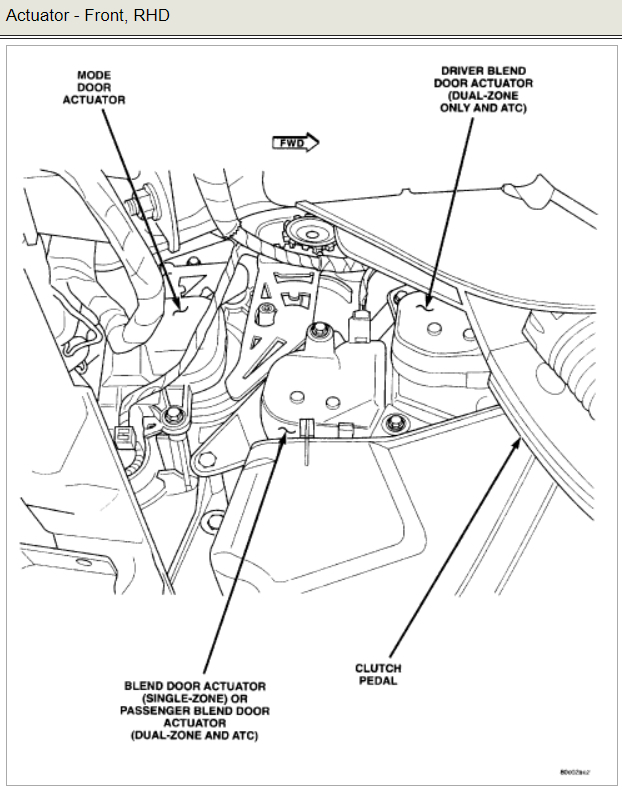

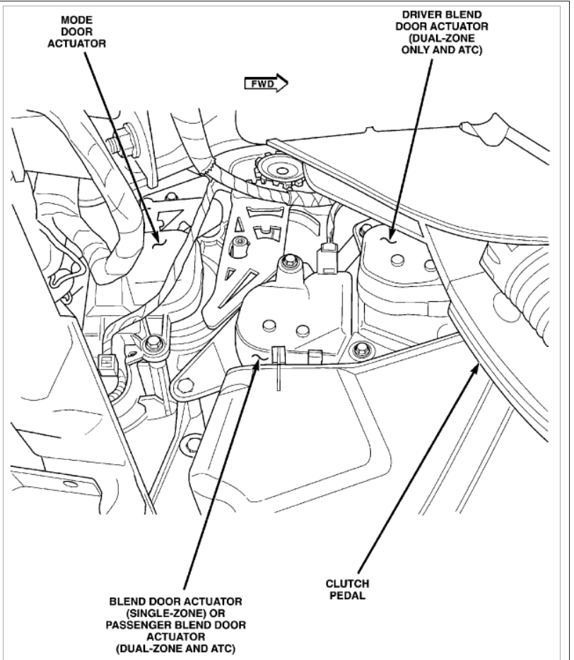

Have the blend door checked. It sounds like it is sticking. It is a vent door that directs air either for the AC or ovet the heater core. If it isn't in the right position, you get cold air.
NOTE: I am assuming that the engine warms up to normal operating temp, and both heater core hoses are getting hot with the engine running, hot, and the heater on. If this is incorrect, let me know.
