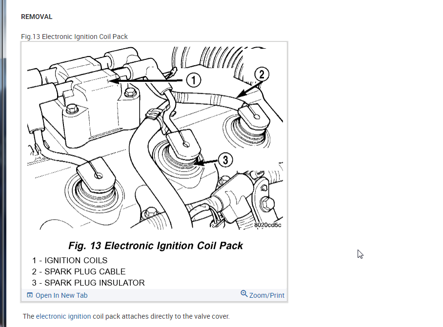

Was wondering if 2003 Dodge Neon coil pack is interchangeable with a 1997?

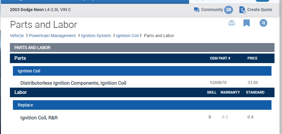

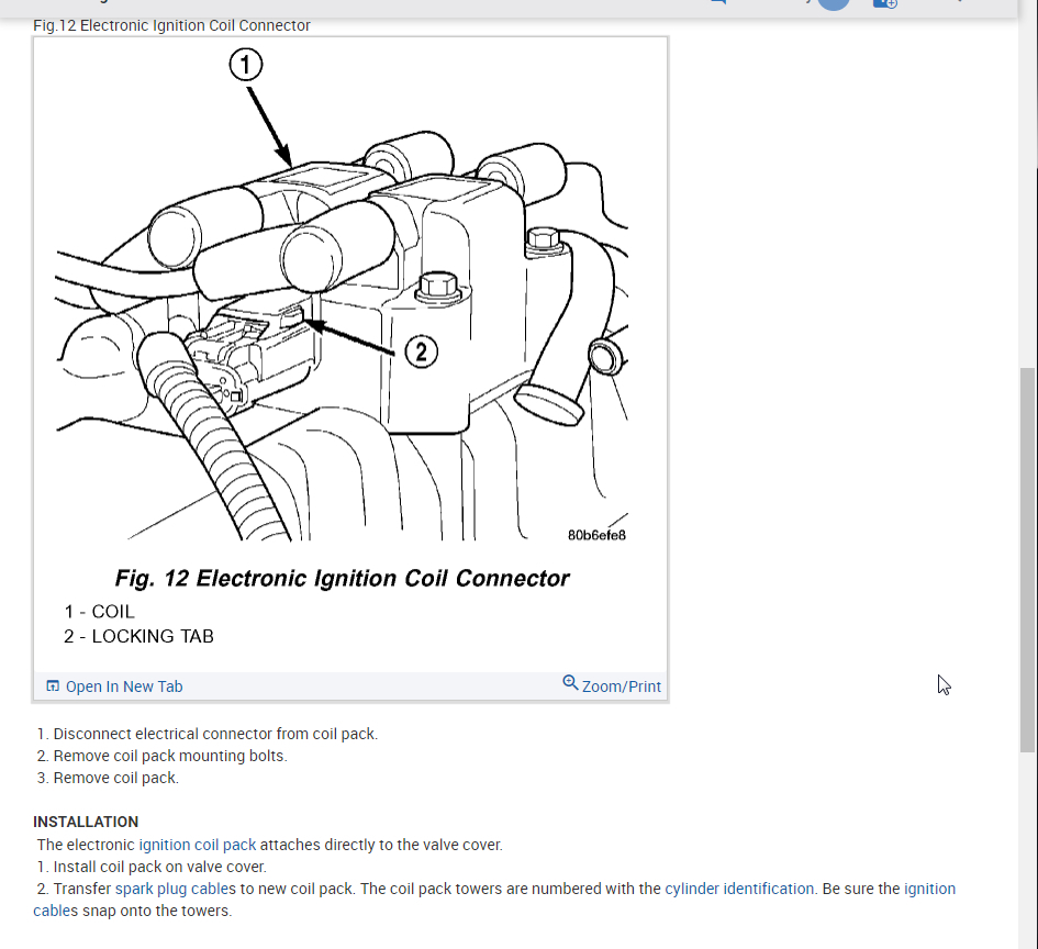

I am attaching the part and process info for the 2.0L engine ignition coil. These are interchangeable between these years.
Let us know if there are questions or you need other information. Thanks
