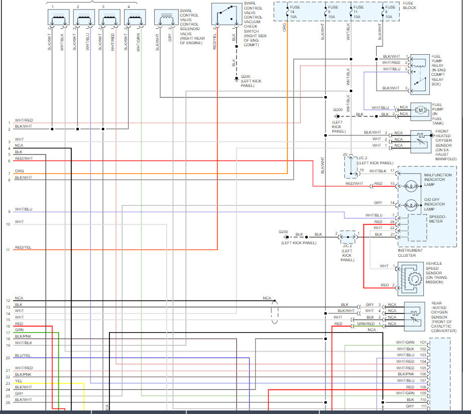

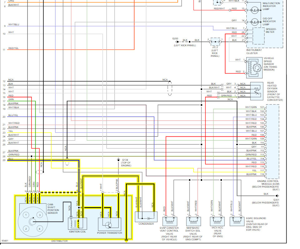

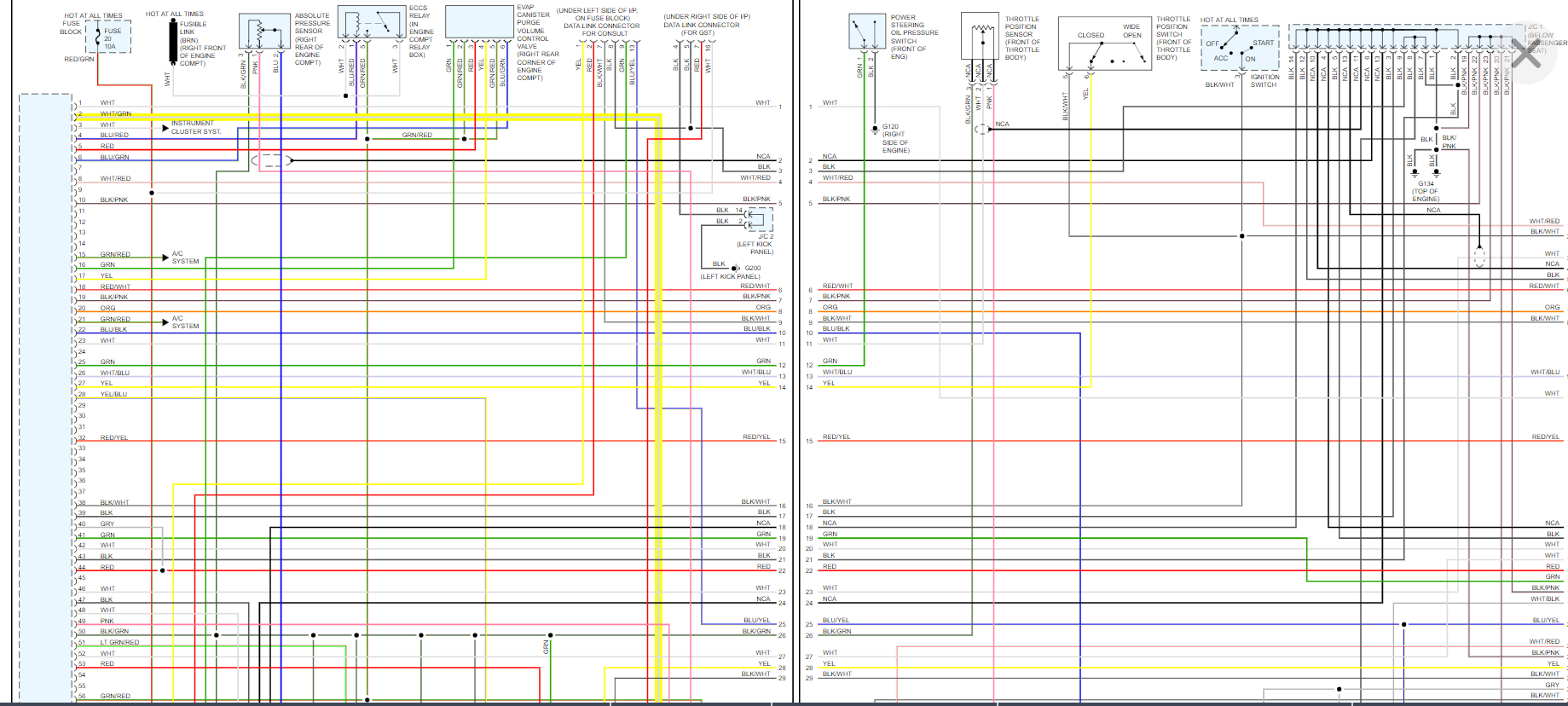

Good morning,
I attached wiring diagrams for you of the system. The most common issue for this issue is the distributor itself.
Make sure the rotor turns when cranking to be sure it is not the timing belt being broken.

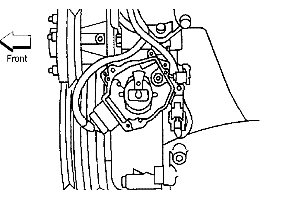

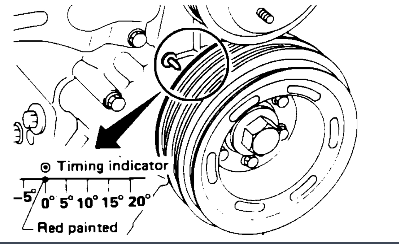

REMOVAL
1. Remove the screws securing the distributor cap and remove the cap.
2. Remove the bolt securing the distributor.
3. Disconnect the crank angle sensor connector and remove the distributor.
INSTALLATION
Timing Mark
1. Turn the engine over until #1 cylinder (front) is at TDC compression stroke.
2. Install the distributor, making sure the rotor is aligned as shown when fully seated.
3. Install the distributor securing bolt and tighten slightly.
4. Connect the crank angle sensor terminal.
5. Install the distributor cap and tighten the screws.
6. Refer to adjustment procedures and adjust the timing.
