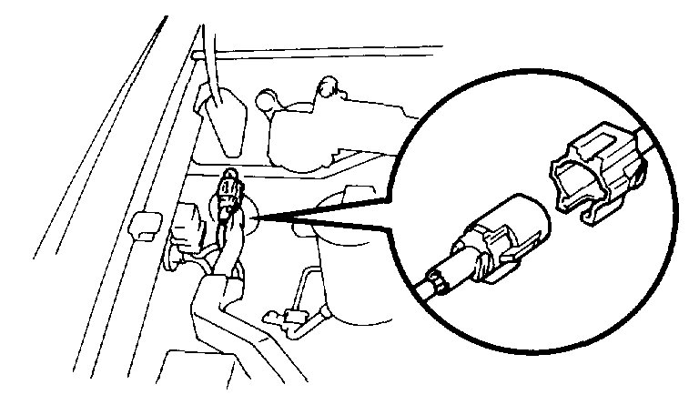

pic 1
3. Disconnect the wiring connector from the cold start injector.

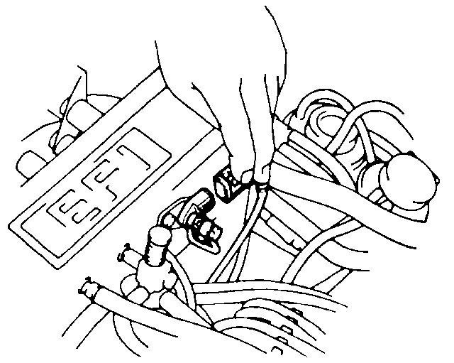

4. Put a suitable container or shop towel under the cold start injector pipe.
pic 2

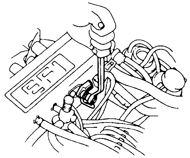

5. Slowly loosen the union bolts of the cold start injector pipe and remove the bolts, cold start injector pipe and 4 gaskets.
6. Drain the fuel from the delivery pipe.
pic 3

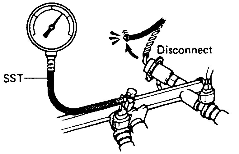

7. Install a gasket, fuel pressure gauge, another gasket and union bolt to the delivery pipe (fuel rail) as shown in the illustration. (SST 09268-45012)

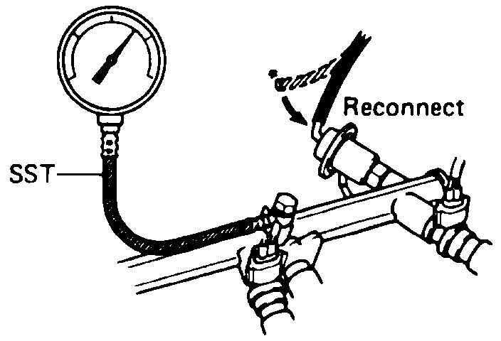

CHECK FUEL PRESSURE
pic 4

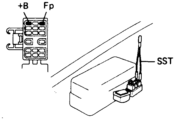

1. Using jumper, connect terminals FP and +B of the DLC1. (SST 09843-18020)
2. Turn the ignition switch ON.

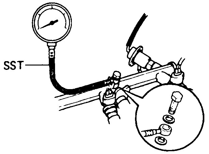

pic 5
3. Measure the fuel pressure.
Fuel pressure: 265 - 304 kPa (38 - 44 psi)

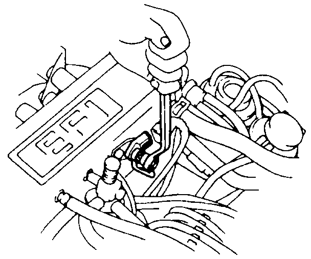

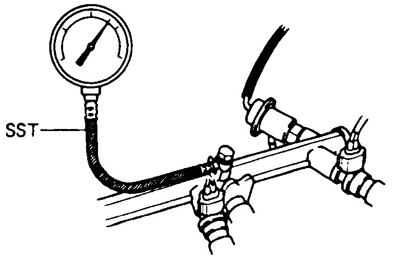

pic 6
6. Disconnect the vacuum hose from the pressure regulator and plug it closed.
7. Measure the fuel pressure at idling.
pic 7
8. Reconnect the vacuum hose to the pressure regulator.
9. Measure the fuel pressure at idling.
Fuel pressure: 226 - 265 kPa (33 - 37 psi)
If not within the specified pressure, check the vacuum hose and pressure regulator.
10. Stop the engine. Check that the fuel pressure remains above 147 kPa (21 psi) for 5 minutes after the engine is turned off.
If not within the specification, check the fuel pump. pressure regulator and/or injectors.

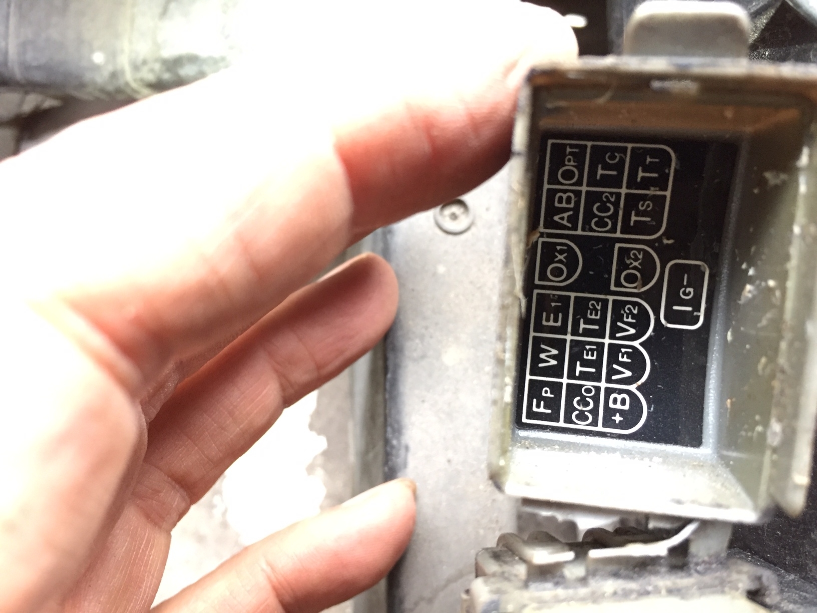

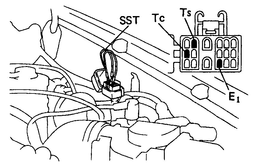

Hi Joe, started finding diagnostic codes. However, my diagnostic connector box is different from the linked website picture. The instruction asks to look fro the "Toyota OBD1" by "Using a jumper wire to connect the TE1 and T1 terminals" for my pickup. Please see the picture of my pickup's box attached. It has TE1, but not T1. It has instead, Tc, Ts and Tt. Which one or any other one shall I use? Thanks.

I read online for the 1993 pickup or 4runner, which I vin number says it is, the jump wire should connect +B to fP. Is this right? Is it risky if I connect them wrong? Thanks.
May 18, 2019 at 5:40 PM
JINGYUGU
  • 5 POSTS

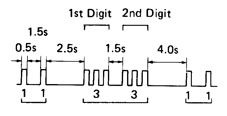

I jumper wire connected my diagnostic box's +B and fP, the engine check light stays on steadily, no blinking. It gives constant steady blinking, never stops, when I jumper wire connected TE1 with E1.
I cannot find description on this kind of reading. What do you think:?
Thanks.
May 18, 2019 at 6:44 PM
Welcome back:
TE1 and E1 are correct. If there aren't any codes, the light will continue to flash two times in a series off and constantly continue.

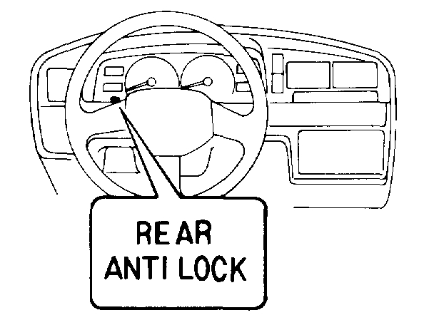

Sorry about the pictures. It won't let me delete them.
