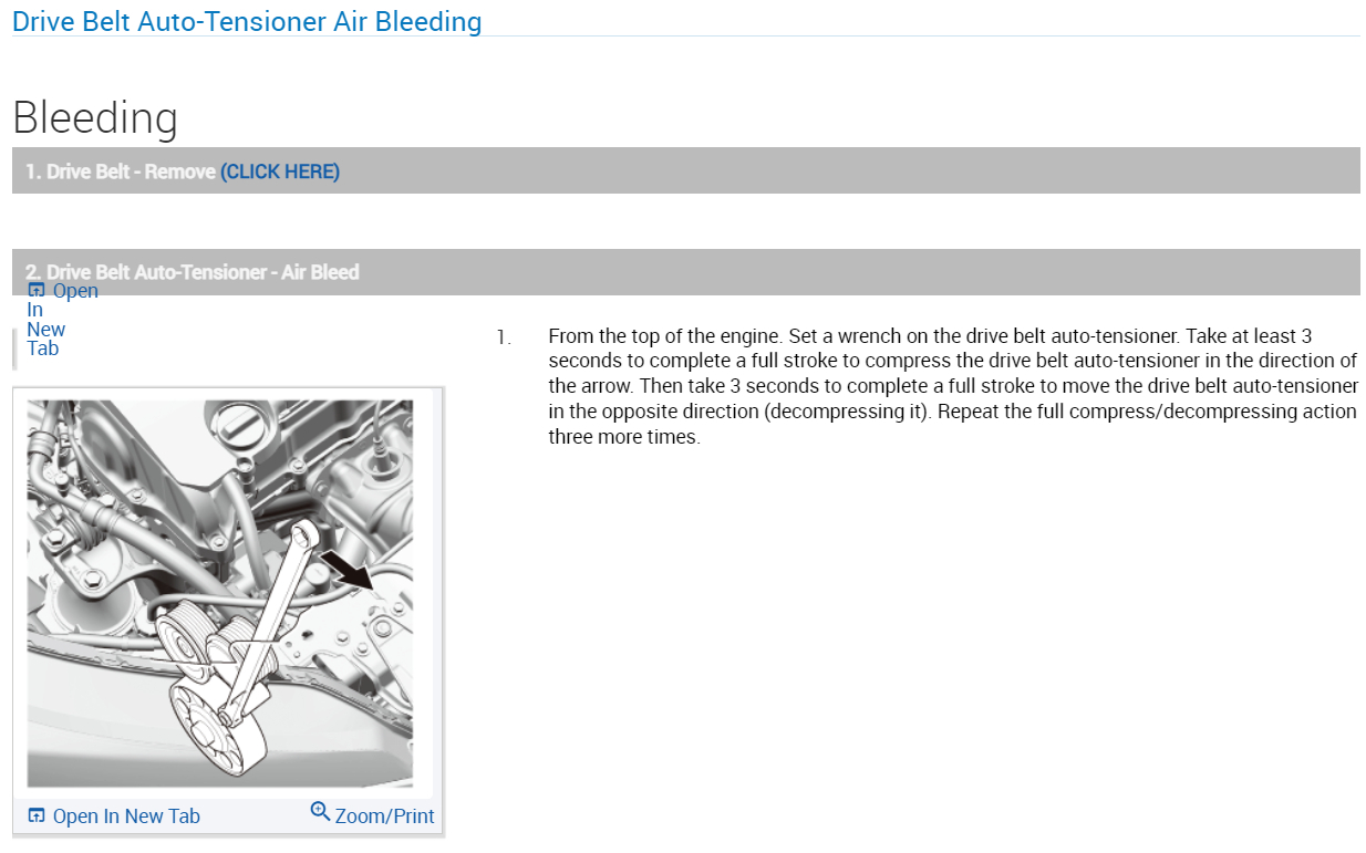

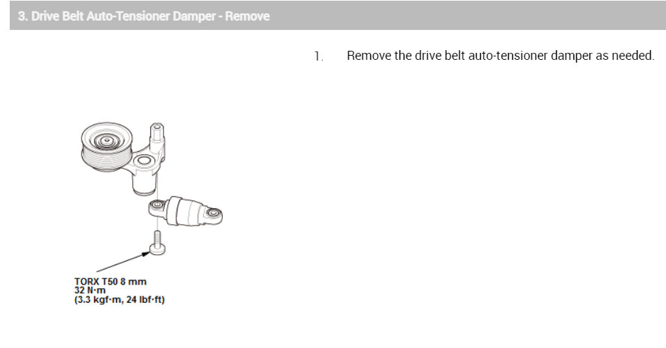

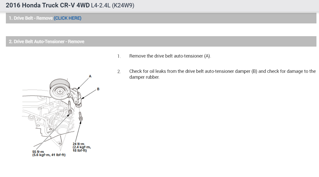

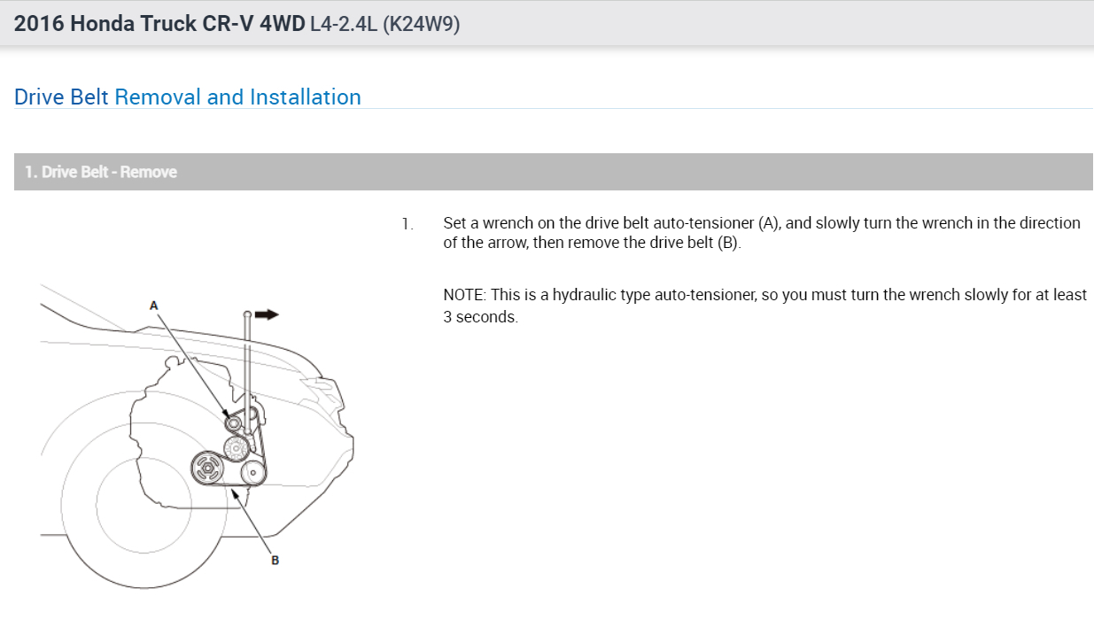

It sounds like you have a serpentine belt idler bearing or belt tensioner that needs to be replaced, I would install a new serpentine belt as well. I would remove the belt and spin the pulleys to see if one of them feels rough or makes noise. Check out the images (below). Please let us know what happens.
