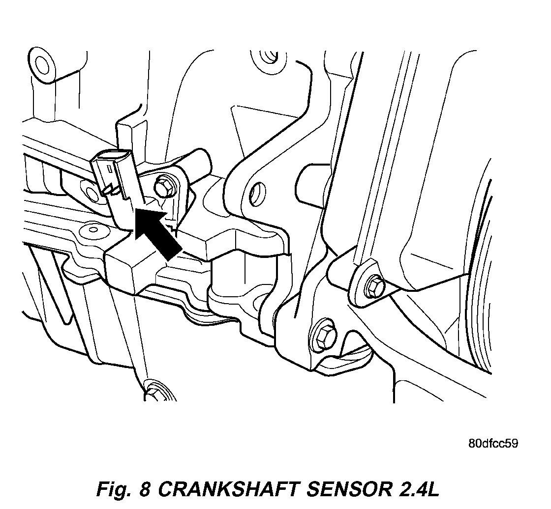

1. Disconnect the negative battery cable.
2. Raise vehicle and support.
Fig. 8 Crankshaft Sensor 2.4L See pic 1
3. Disconnect the electrical connector.
4. Remove crankshaft sensor bolt.
5. Remove the crankshaft sensor.
INSTALLATION
1. Install the crankshaft sensor.
2. Install crankshaft sensor bolt and tighten.
3. Connect the electrical connector.
4. Lower vehicle.
5. Connect the negative battery cable.
___________________________________

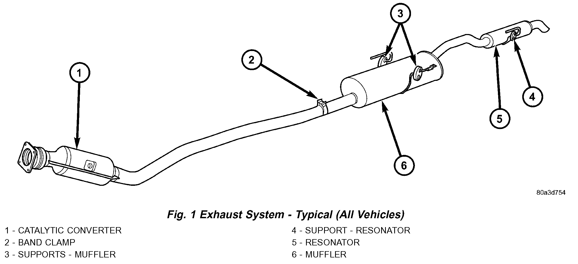

The sound I hear seems to be a loose catalytic converter. What happens is the insides come loose and then rattle like that. What I need you to do is take a rubber mallet and tap on the exhaust system to see if you can recreate the sound.
Take a look through this link.
https://www.2carpros.com/articles/bad-catalytic-converter-symptoms
I attached a picture that shows where the converter is located. I have a feeling internally it has come apart and is causing the noise and restriction of air flow. Thus, the poor running conditions and the smell you get.
