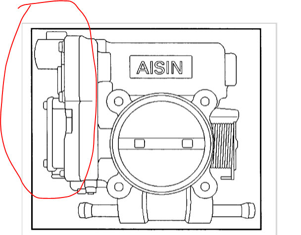

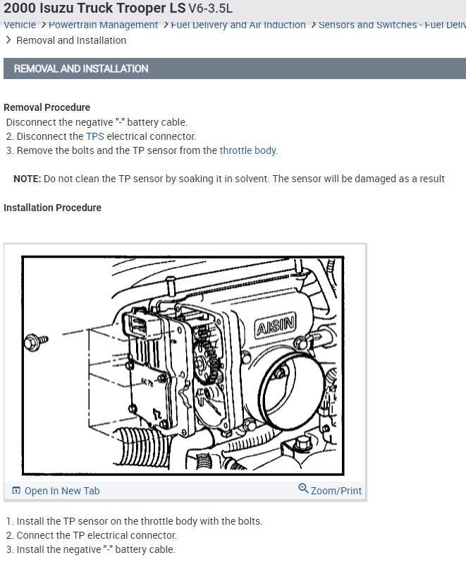

The throttle position sensor mounted on the side of the throttle body (see diagram).

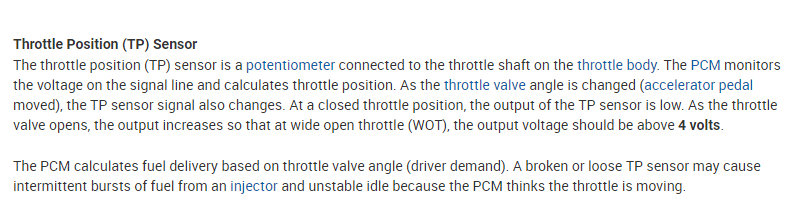

The throttle position (TP) sensor is a potentiometer connected to the throttle shaft on the throttle body. The PCM monitors the the signal and calculates the throttle.
The throttle position sensor you have a output voltage of more than 4 volts.
