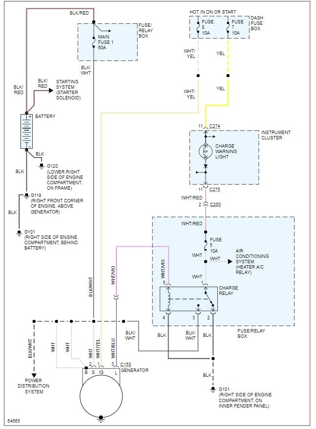

Looks like you have a charge relay, it could be losing voltage there as well
Have you used a voltmeter to verify the accuracy of your dash gauge? You should test at the big charge wire on the rear of the alternator and at the battery to see if they are the same
Here's a guide on how to use a voltmeter
Attached below is the wiring diagram for your charging system

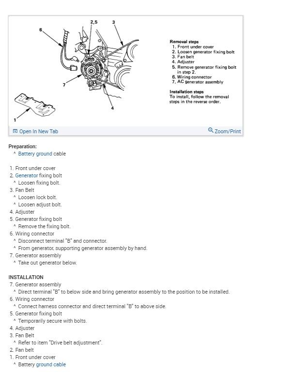

The instructions for your vehicle are attached below
