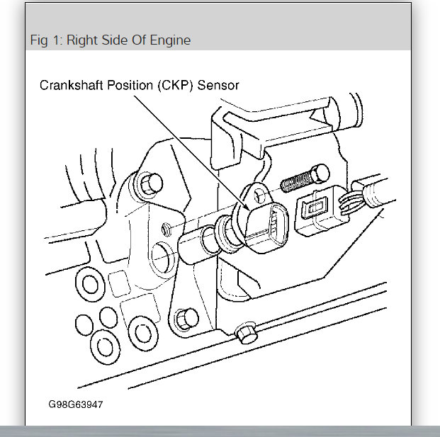

This could be a problem with your vehicle's Crankshaft Position Sensor (CKP). Your vehicle uses the information from the CKP to determine the rotational speed of the crankshaft for ignition timing. If your vehicle's Power-train Control Module (PCM) does not get this signal it will not spark the spark plugs and your vehicle will not start. I have included a few links below for you to go to.
https://www.2carpros.com/articles/how-a-crank-shaft-angle-sensor-works
I have also included in the diagrams down below the information on the location of the CKP for your vehicle. Please go through these guides and get to us with what you are able to find out.
