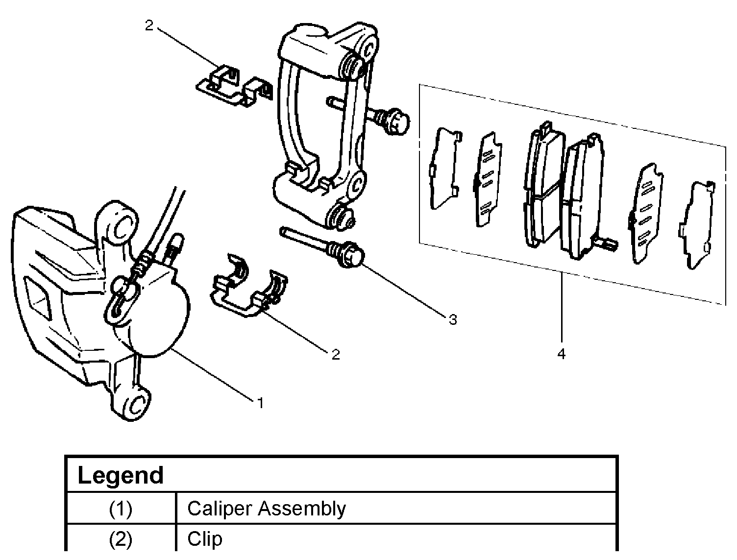

Here are the directions specific to your vehicle. The attached pics correlate with the directions.
____________________________________________________
2004 Isuzu Truck Rodeo 4WD V6-3.2L
Rear
Vehicle Brakes and Traction Control Disc Brake System Brake Pad Service and Repair Procedures Rear
REAR

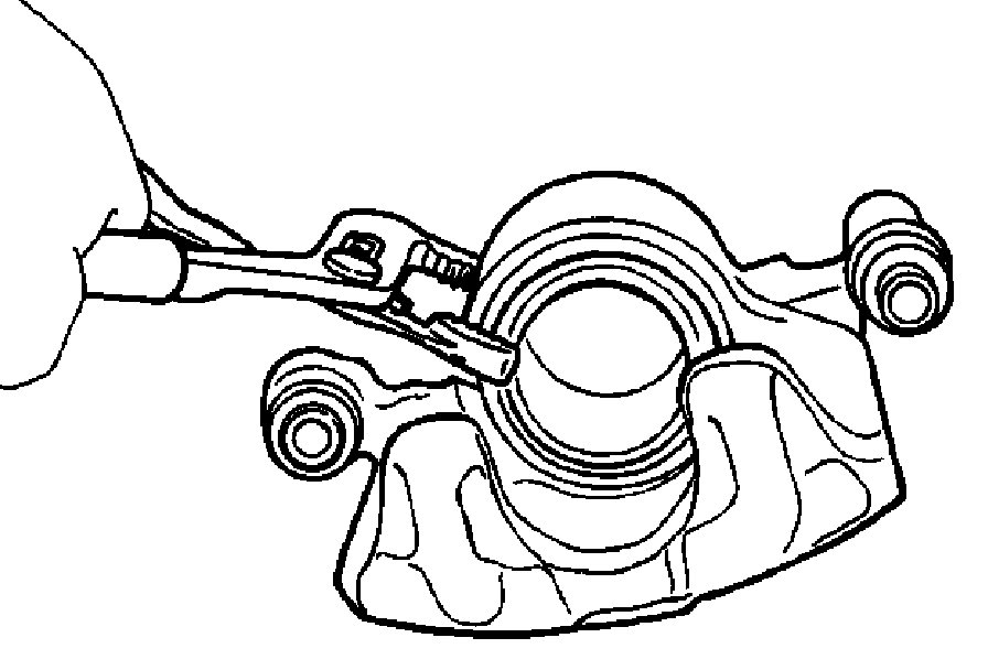

pic 1

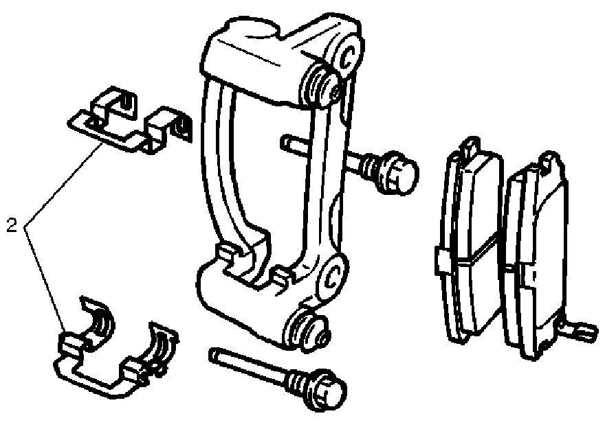

pic 2
Removal
Note: If a squealing noise occurs from the rear brake while driving, check the pad wear indicator plate. If the indicator plate contacts the rotor, the disc pad assembly should be replaced.
^ Draw out two-thirds of the brake fluid from the reservoir.
^ Raise the vehicle and support it with suitable safety stands.
1. Remove wheel and tire assembly.

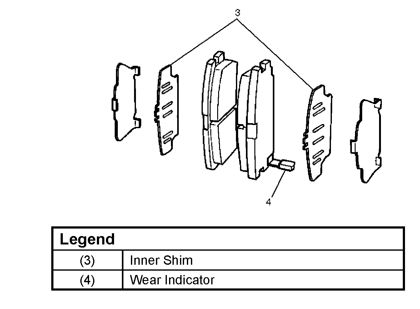

pic 3
2. Remove lock bolt (1)
3. Rotate caliper assembly and support the caliper assembly so that the brake hose is not stretched or damaged.
4. Remove pad assembly with shim.
5. Remove clip.

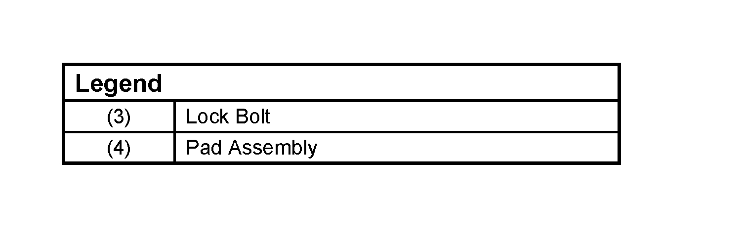

pic 4
1. Install clip (2).

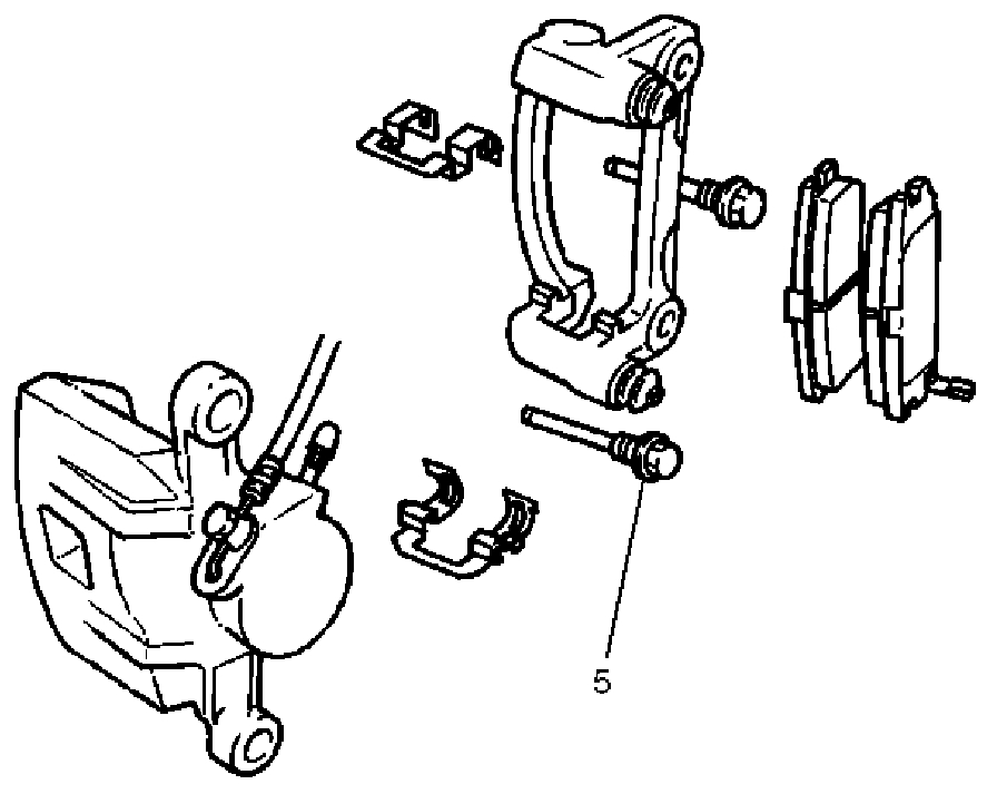

pic 5

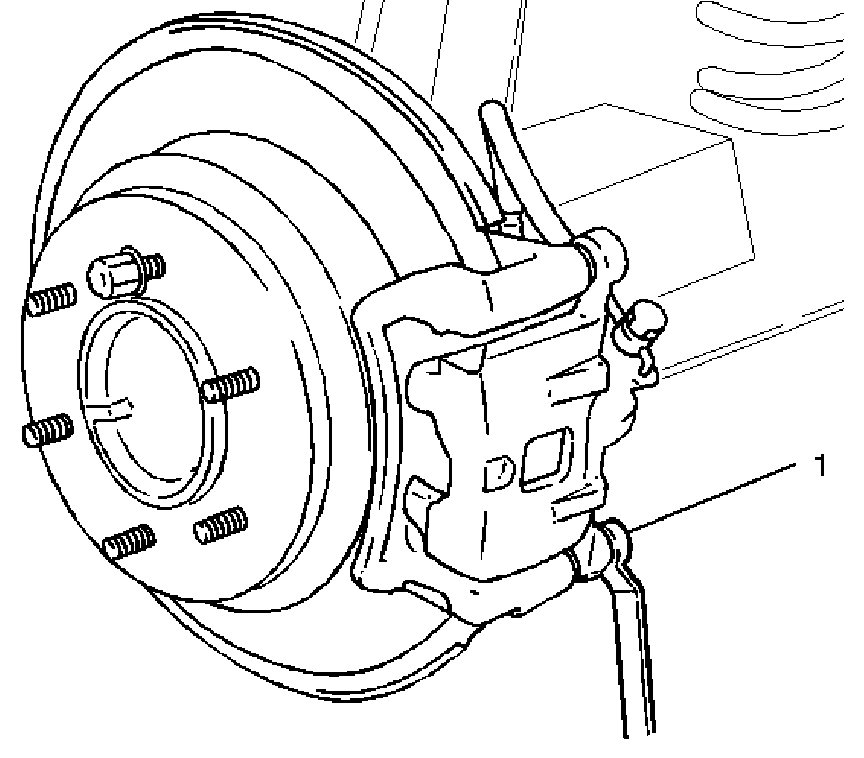

pic 6

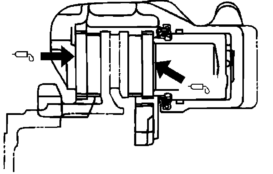

2. Apply special grease (approximately 0.2 g) to both contacting surfaces of the inner shims. Wipe off extruded grease after installing. Install pad assembly with shim.
pic 7
3. Carefully use adjustable pliers to bottom the piston into the caliper bore. Do not pull or twist the flex hose or damage will occur.
4. Install lock bolt (5) and tighten the bolt to the specified torque.

When the brake caliper is removed, you will need to also remove the caliper mount shown in pic 4. Once that is removed, the brake rotor can be replaced.
