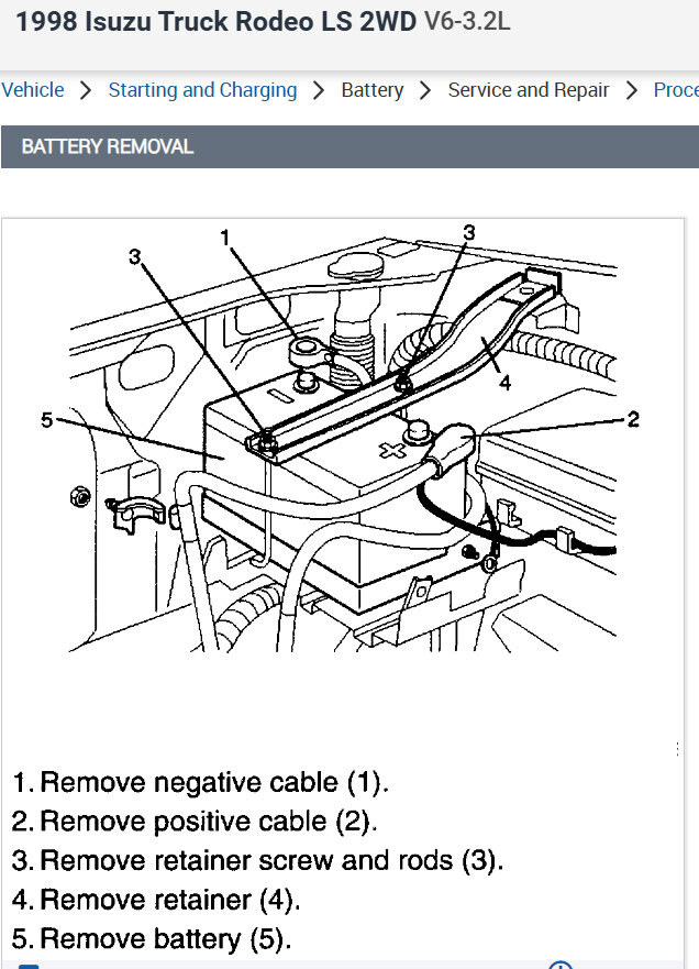

This will be a battery issue. Here is the guide you can load test the battery yourself.
Here is how to change it out for a new one if it fails the test. Check out the images (below). Please let us know what happens.
