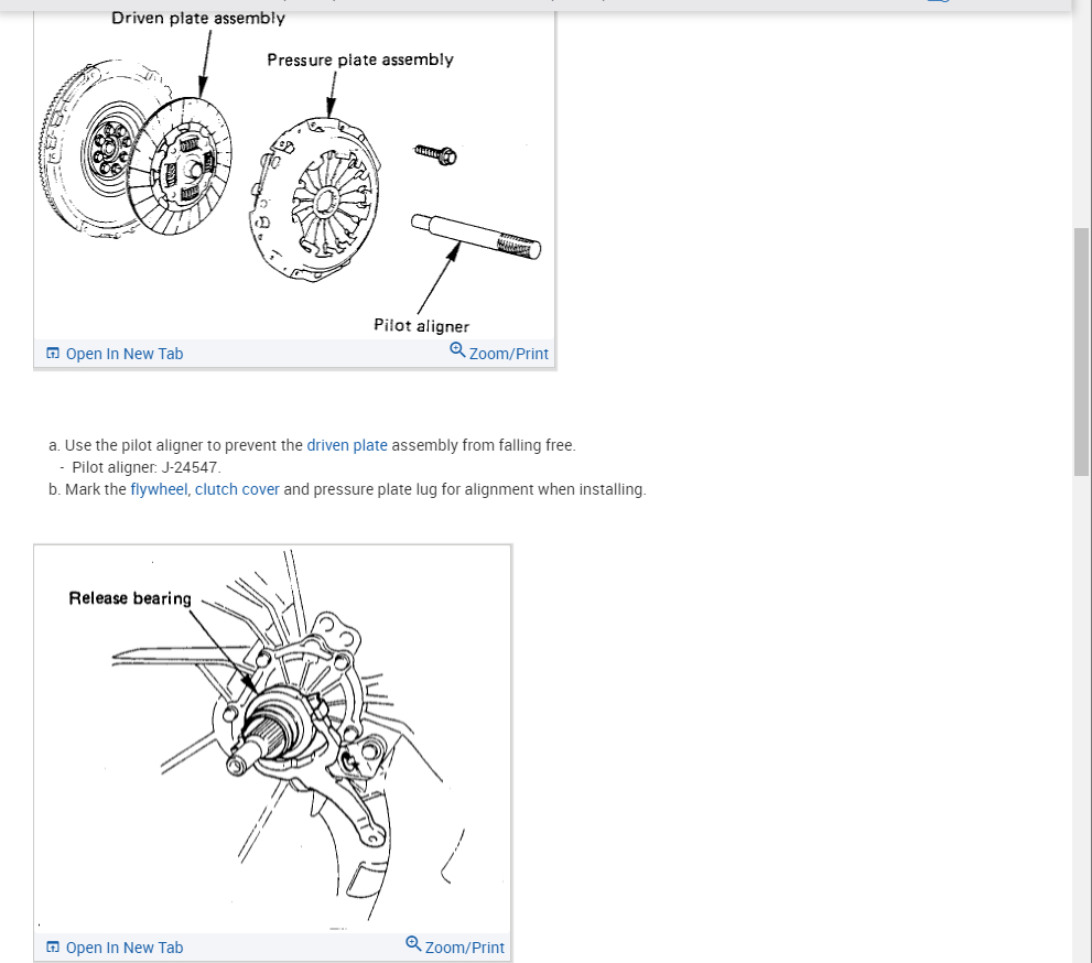

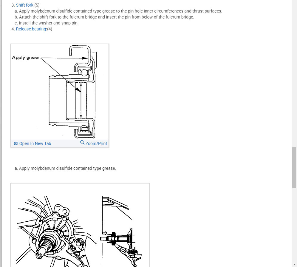

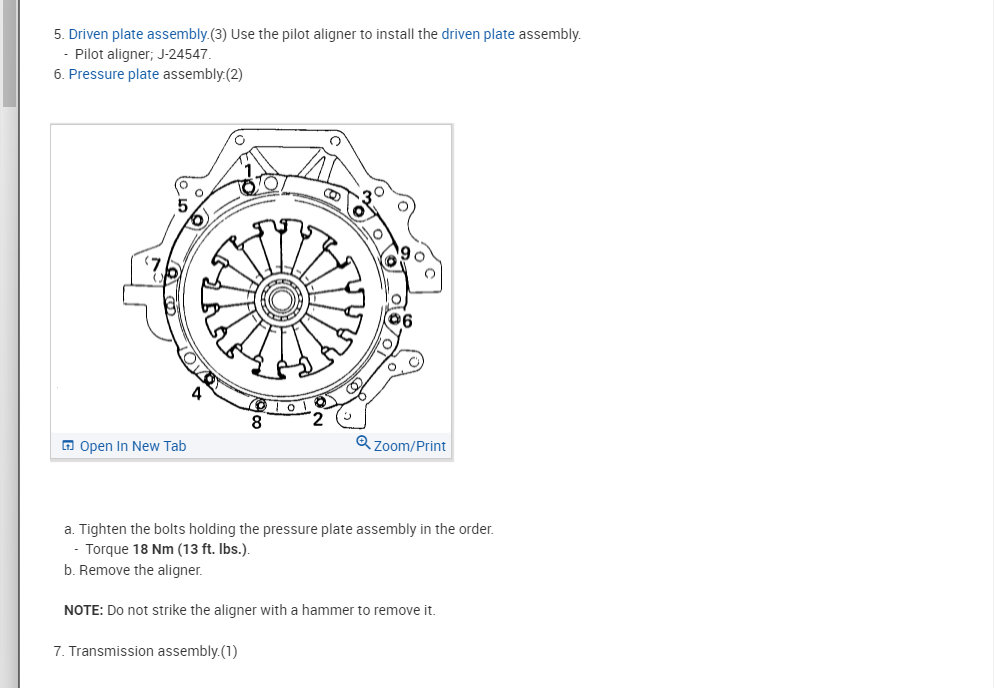

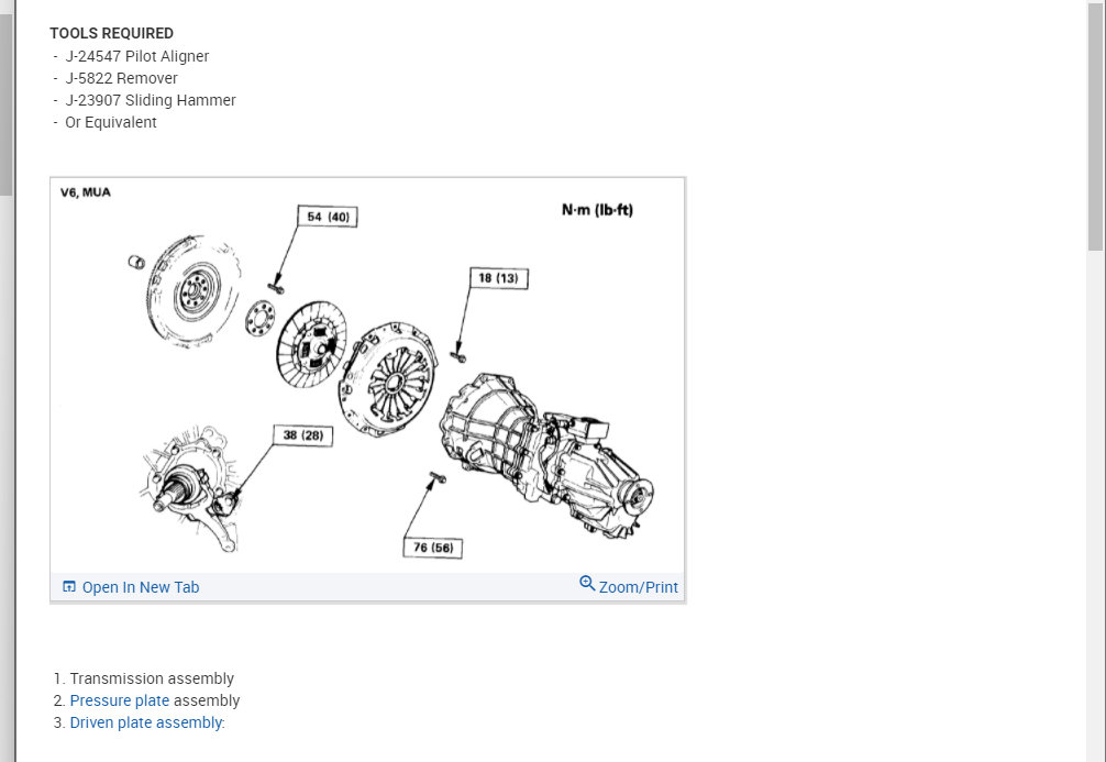

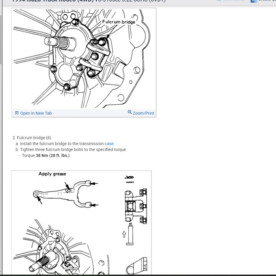

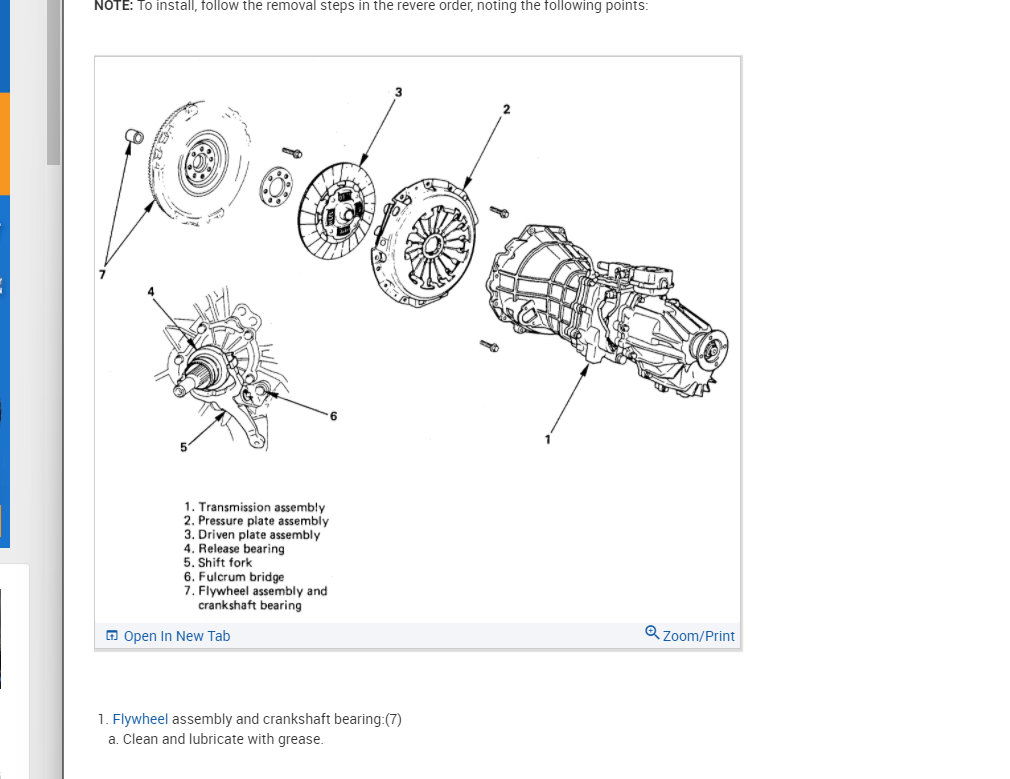

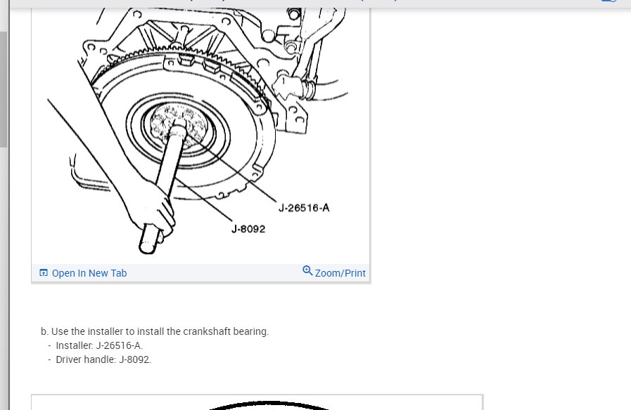

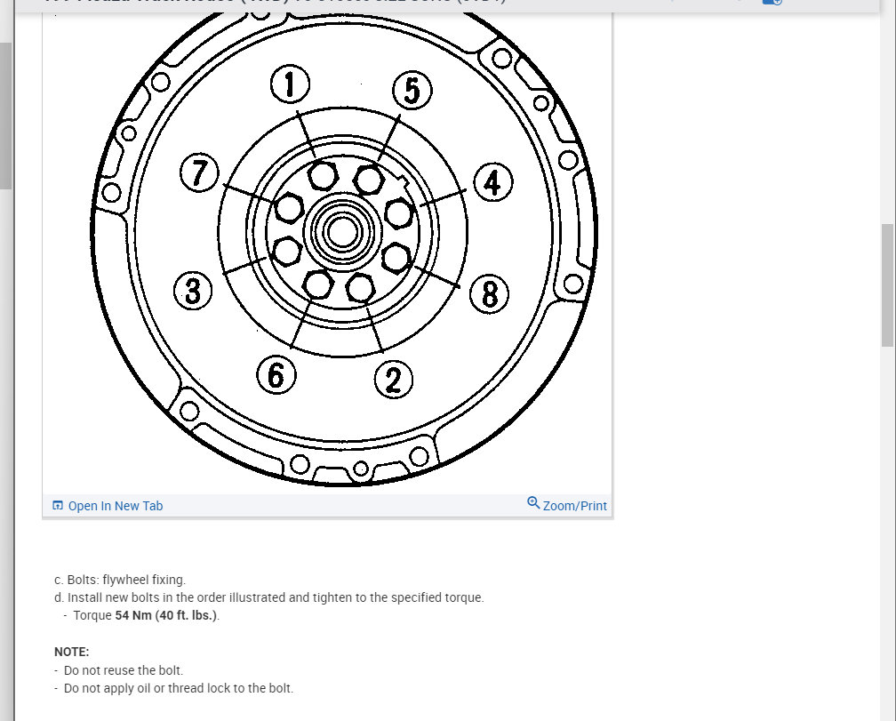

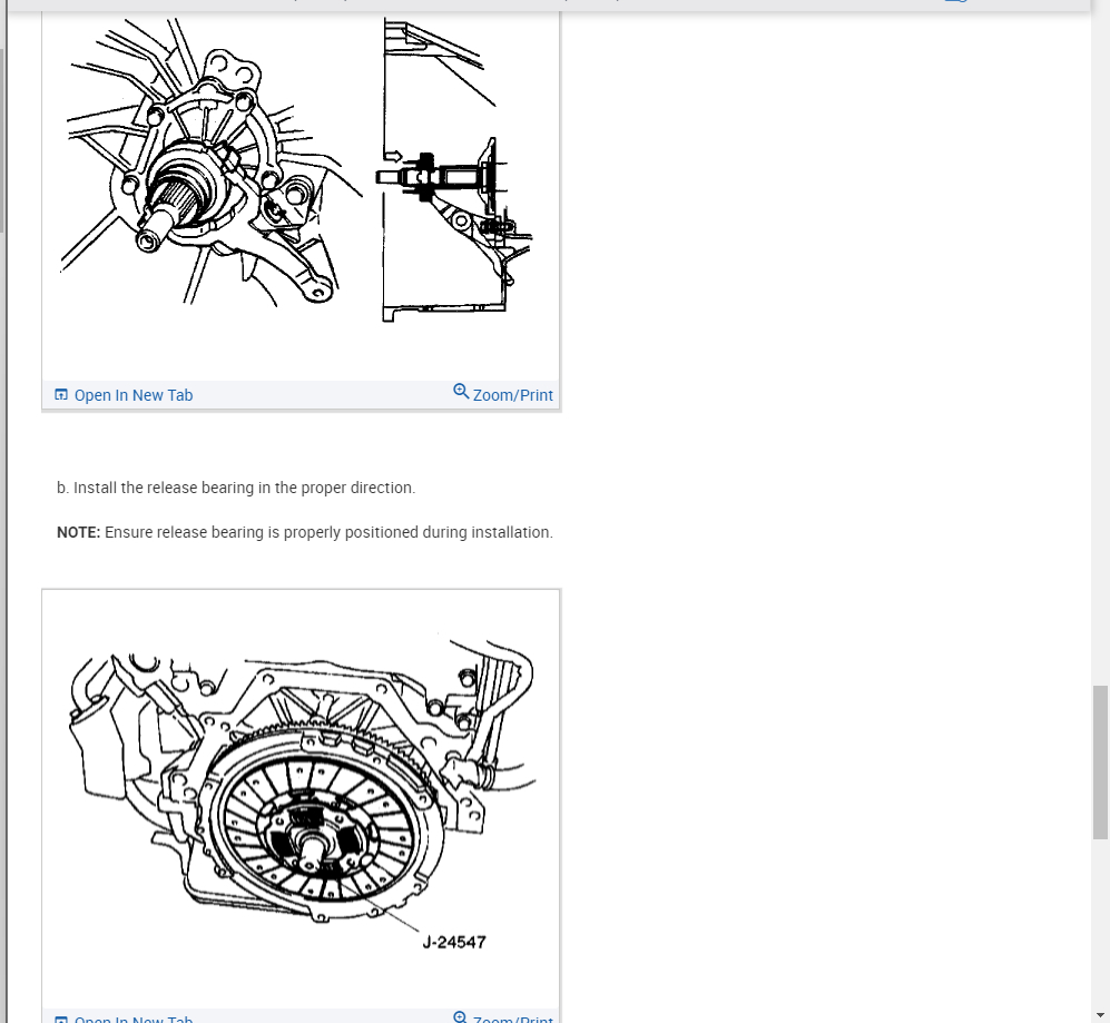

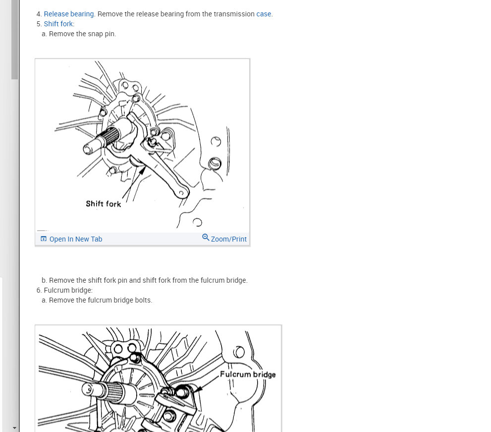

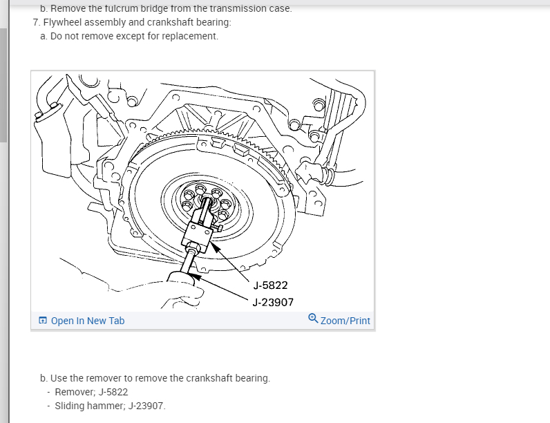

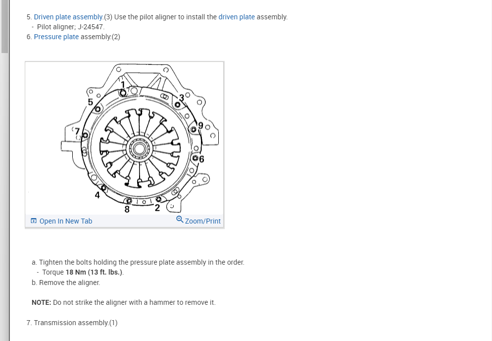

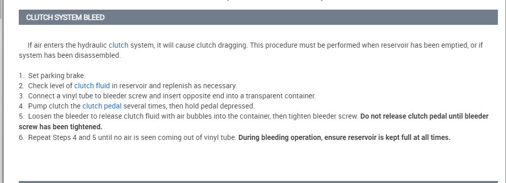

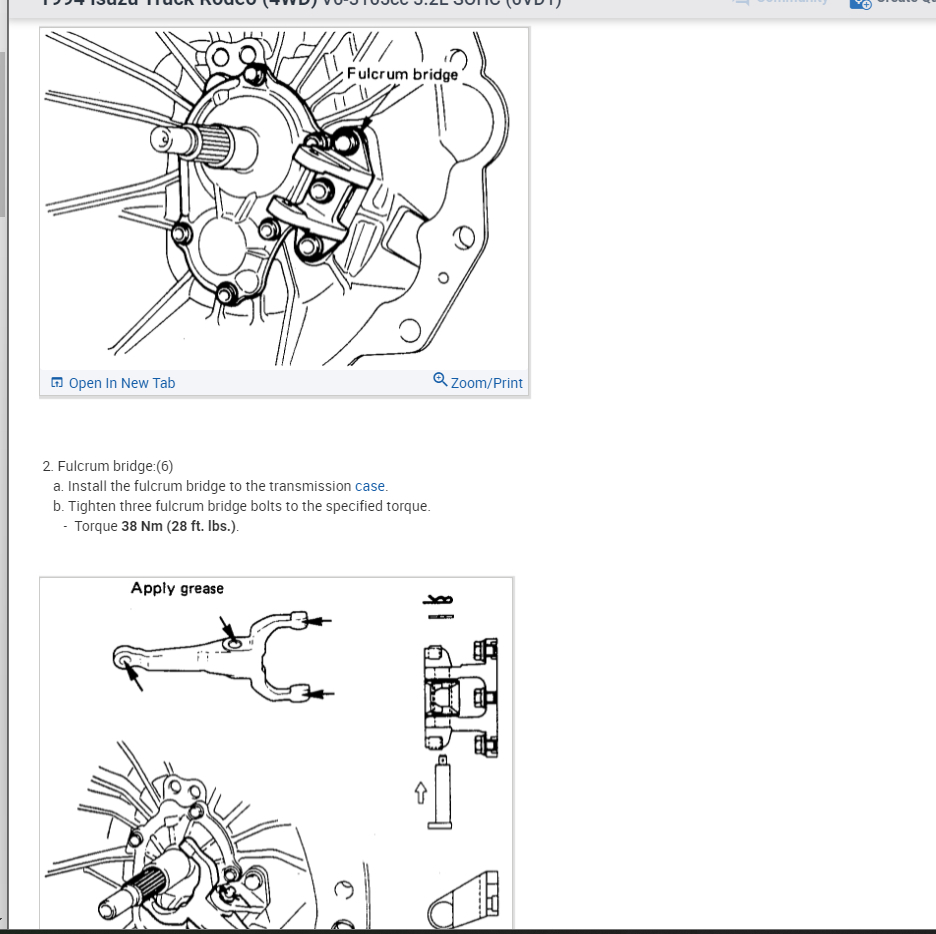

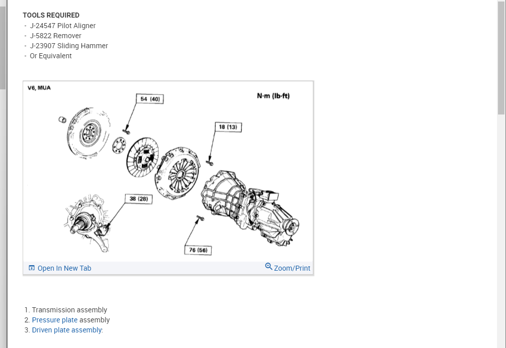

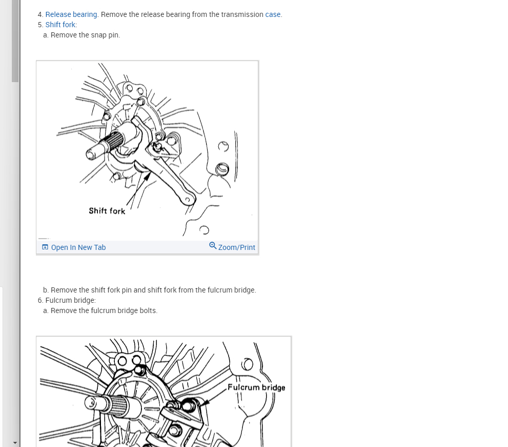

I am attaching the info below from the manual on how to replace this.
Just because these components are replaced doesn't mean they are going to last a long time so if it were me, we need to inspect this stuff at the very least. You may be able to reuse some of the items but if they are worn, I would replace them again while you are there.
Let us know what you find with this.
