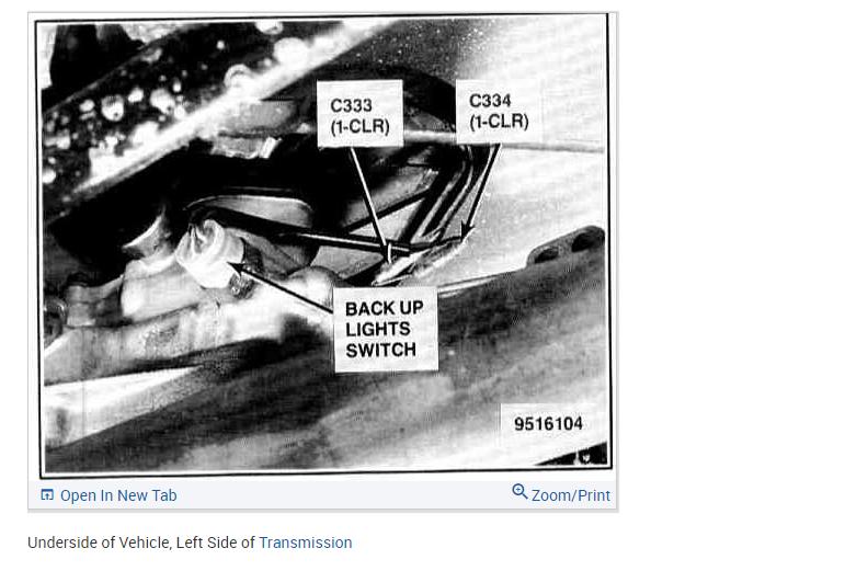

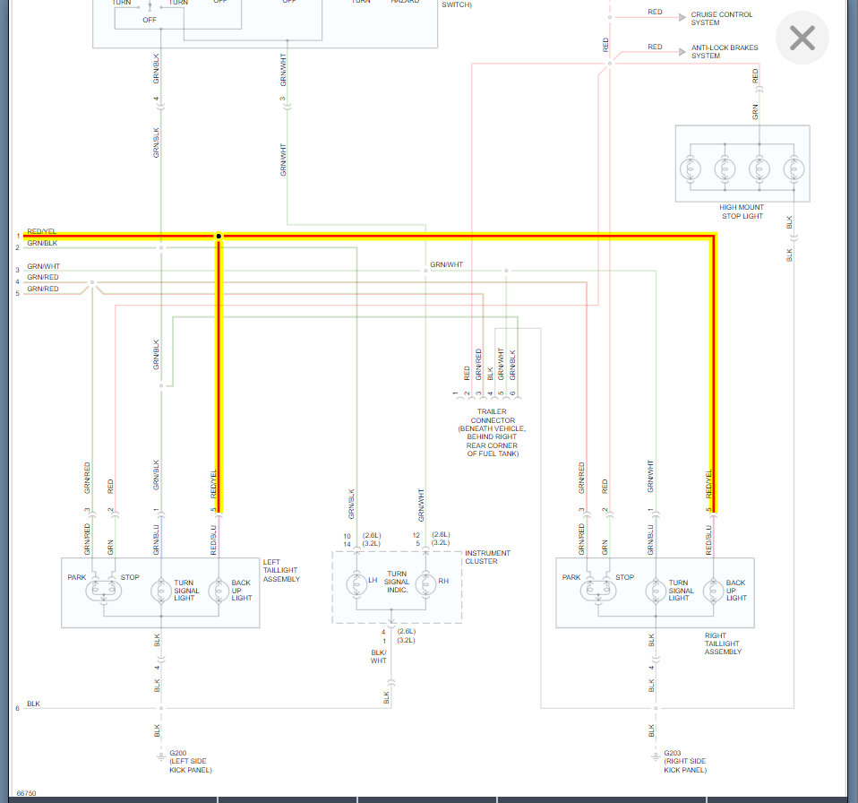

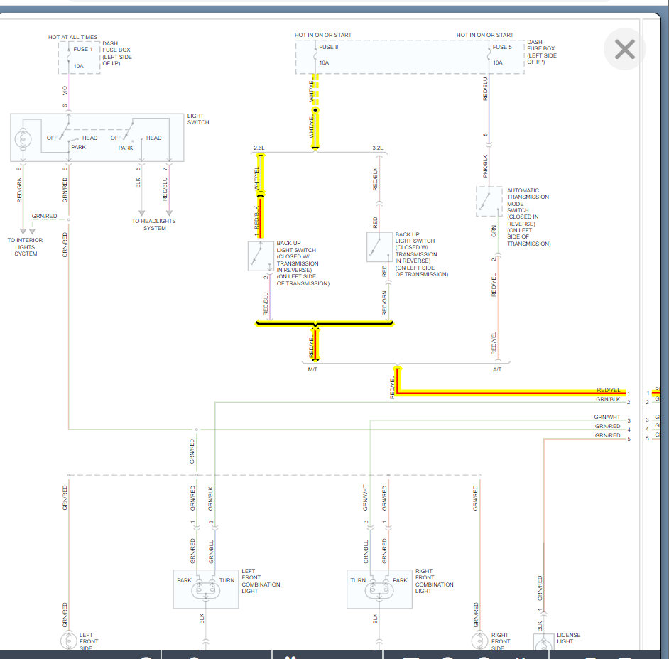

My backup lights on my 1994 Isuzu Rodeo 2.6 4-cyl. manual transmission are no longer working. I was told that it is possibly the backup light switch. Can someone help me on locating the switch and any possible ways of telling if this is the problem? And any additional possiblities?
