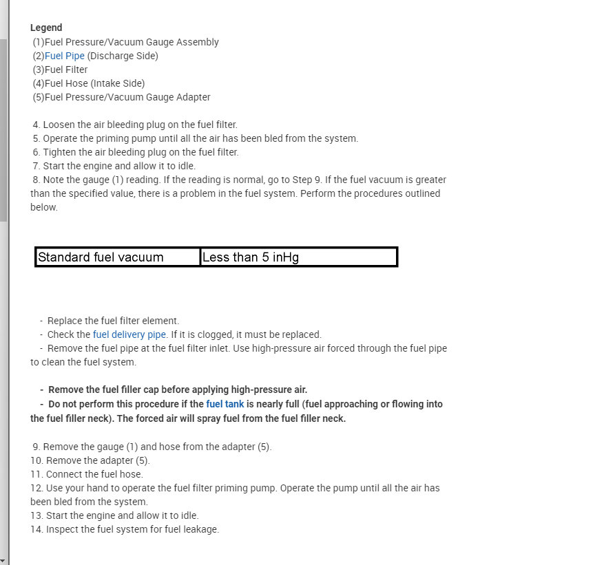

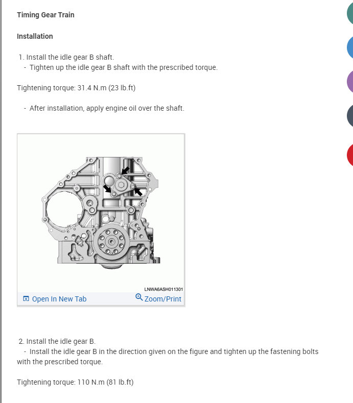

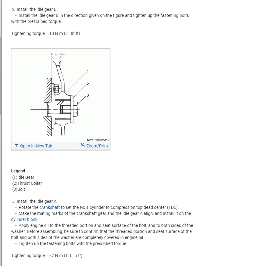

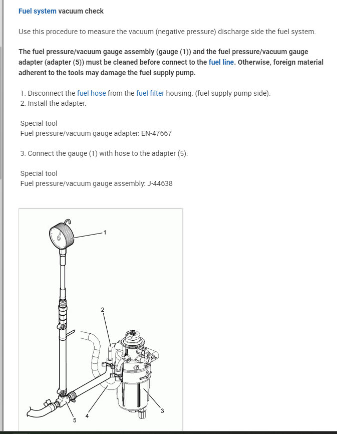

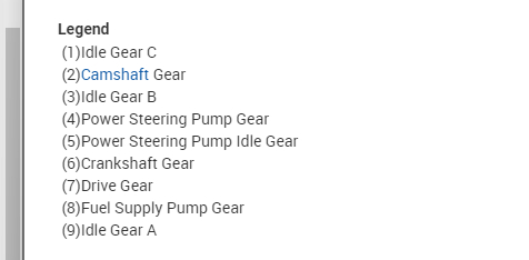

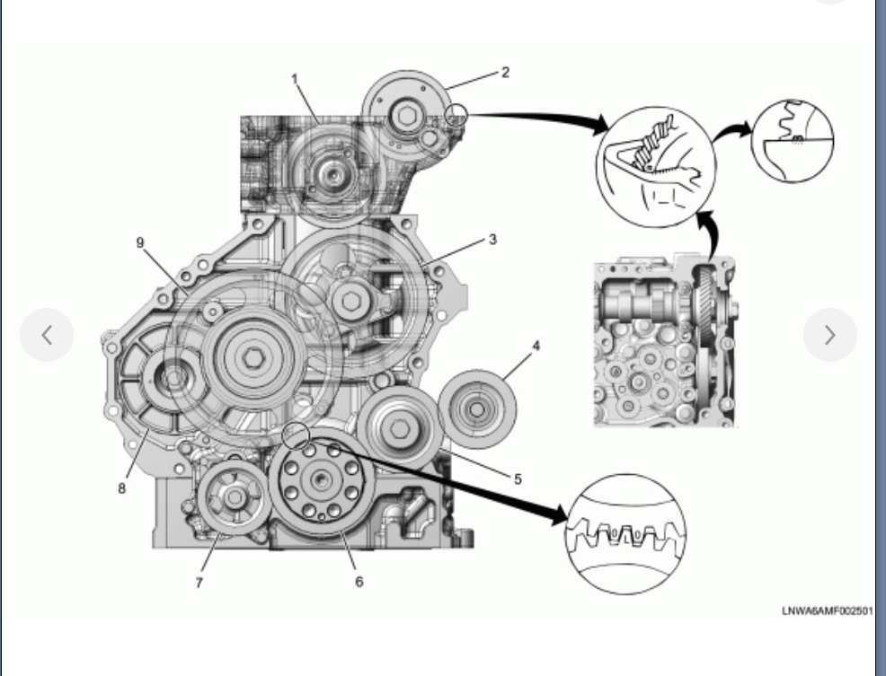

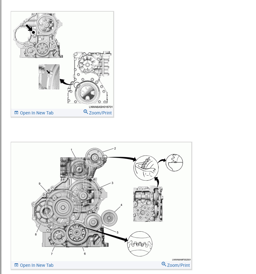

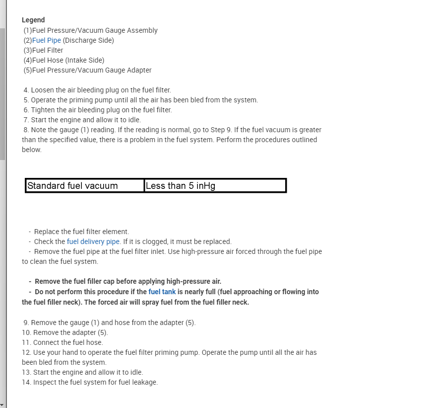

I've done a complete overhaul of the engine but it couldn't start.
Battery conditions perfect.
As in all other minor parts.
What could be a possible solution or have I missed something?
