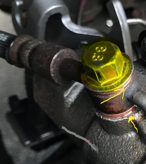

I'm changing both front calipers on this car and the new calipers are just different than the original. Where the brake line attaches to the caliper is where the issue is. I took the lines off and there was 1 copper washer with grooves like a record and the caliper has grooves. The new calipers came with 2 copper washers each 1 regular and one grooved. I tried bolt-smooth washer-brake line-grooved washer-caliper. All was good until I went to bleed the brakes then squirt out shoots brake fluid. Before I try testing every possible combination can anyone tell me the proper order and/or what washers are necessary? Thanks

You should have a washer on each side of the banjo fitting. Is that how you are doing it?

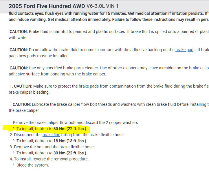

I attached two pics. Pic 1 shows the locations of the copper washers. Pic 2 indicates the torque specifications, 22 ft/lbs. You may not be getting them tight enough.
Let me know if this helps.
See pics below.
