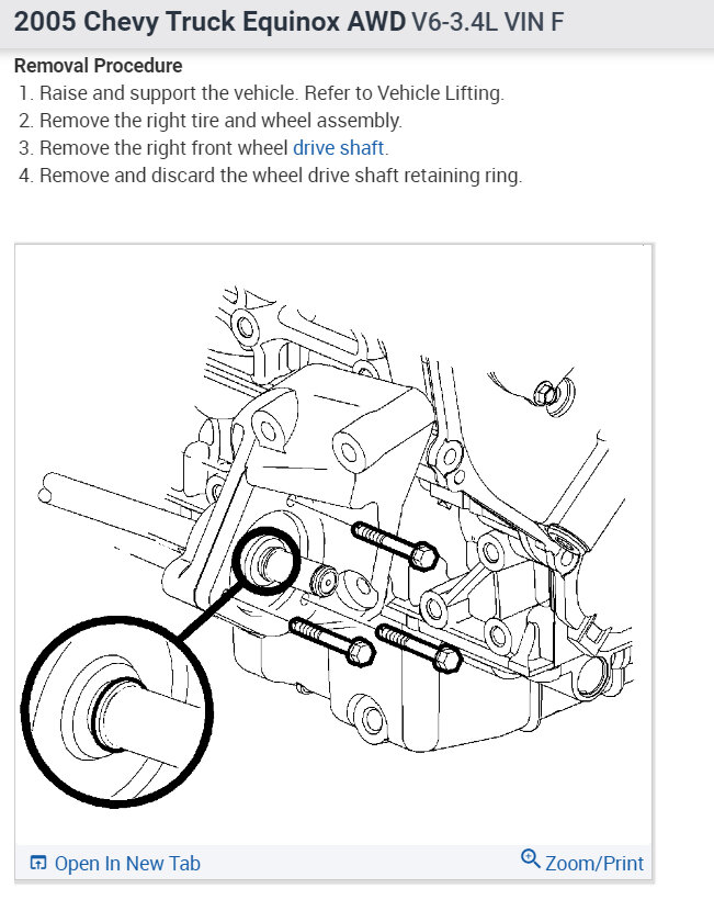

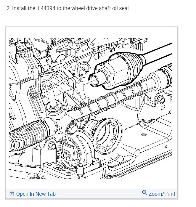

It sounds like one of the CV axles is not installed completely, I would double check the inboard CV axle joints to make sure they are in the transaxle fully. Check out the images (below). Let us know what happens and please upload pictures or videos of the problem so we can see what's going on.
