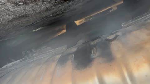

I'm trying to figure out why my car is so sluggish and it's vibrating in idle while in park and drive. The engine is loud when accelerating. i have to press down on my gas hard for my car to even go past 40 MPH. Then I looked under my car and seen this? Could this be the problem?

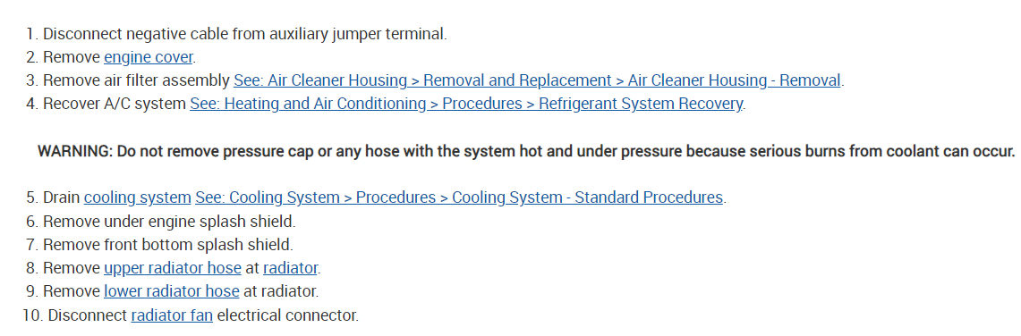

To change out the radiator you will need to discharge and refill the A/C system.
This guide will show you what needs to be done in case of a radiator change:

That video is the back of my car by the muffler. not the front. Isn't the radiator in the front of the car?
Jan 16, 2024 at 11:19 AM
Sorry I couldn't tell if it was the front or the rear. If water drips from the exhaust system this is normal until the engine gets hot. I would wait until the engine is cold though and check the coolant level.

I live In MN and it's cold. I recorded that video when my engine was already warm. Could there be a problem with my exhaust?
Jan 17, 2024 at 10:49 AM
No, it is just condensation for the engine which is normal, was the coolant level low?
