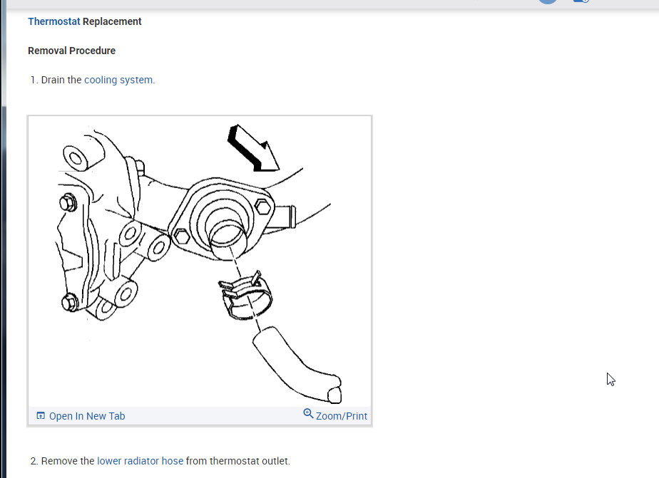

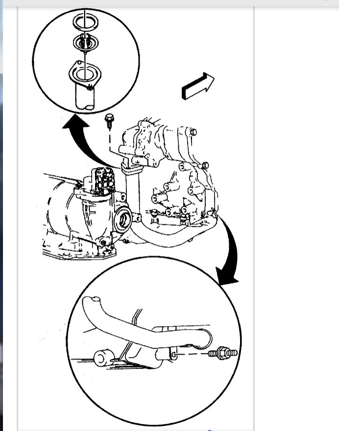

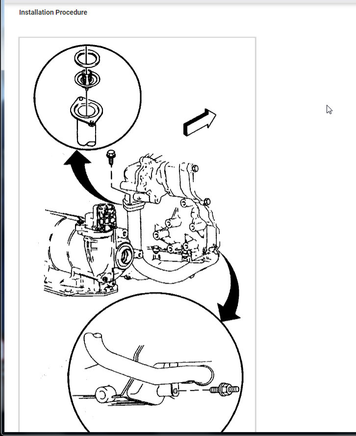

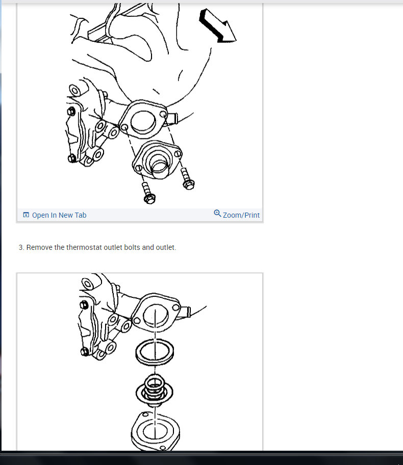

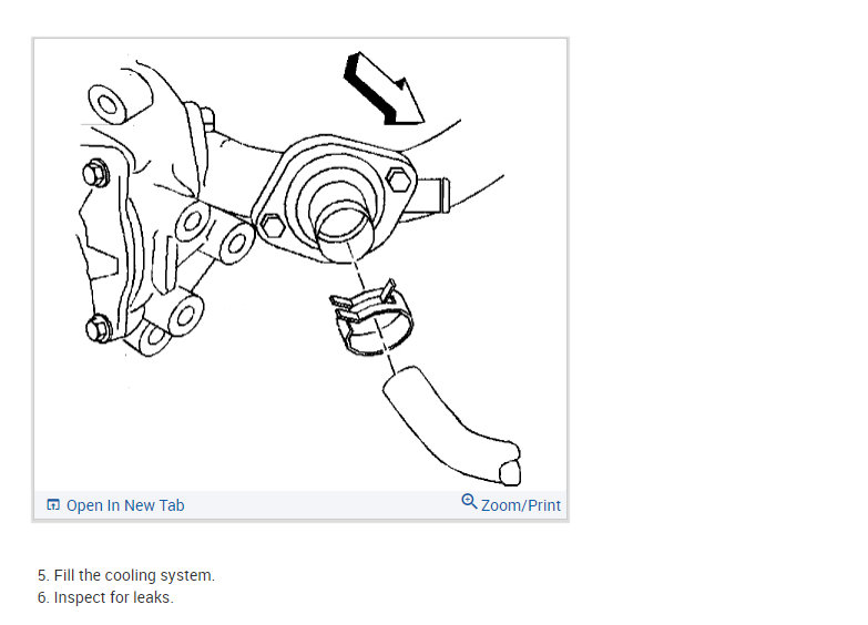

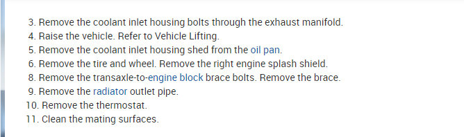

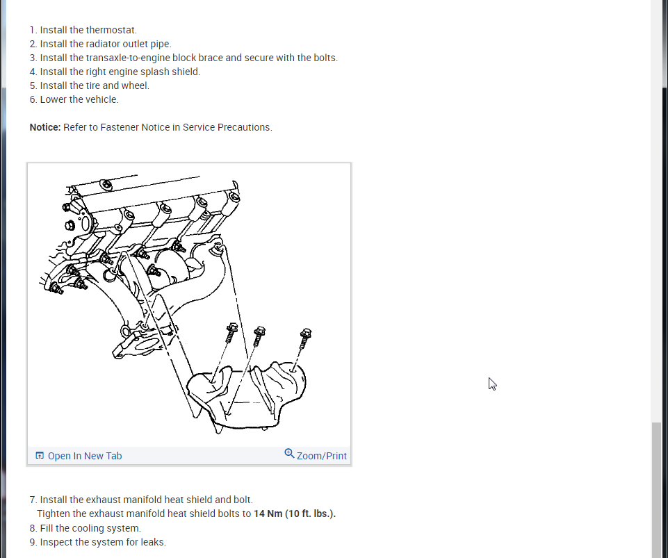

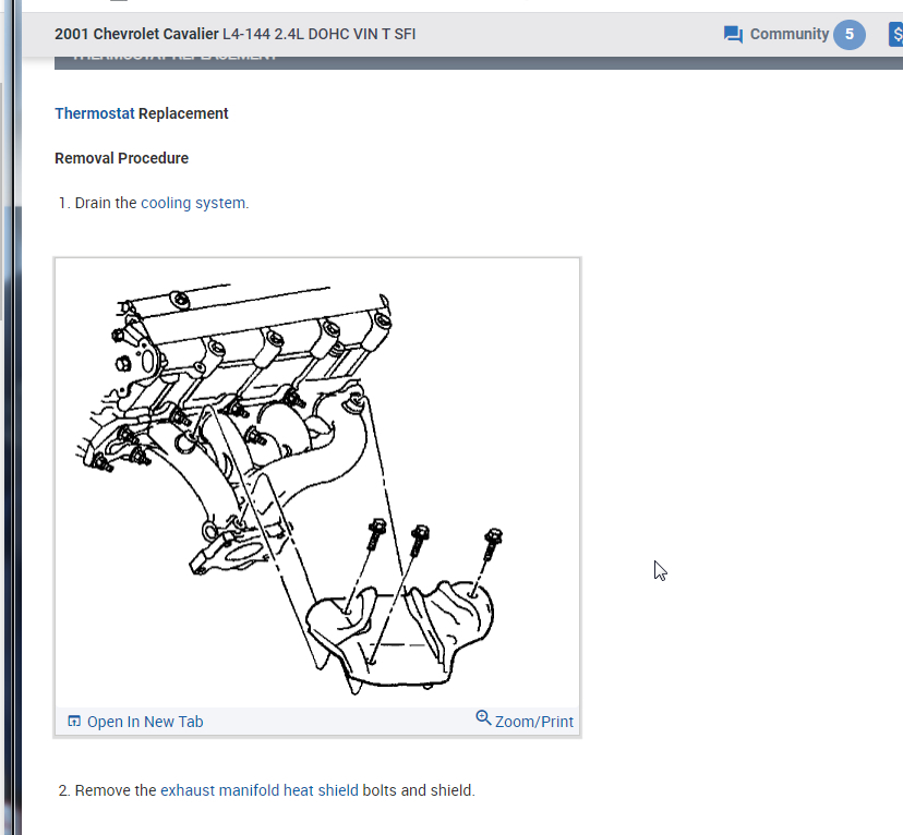

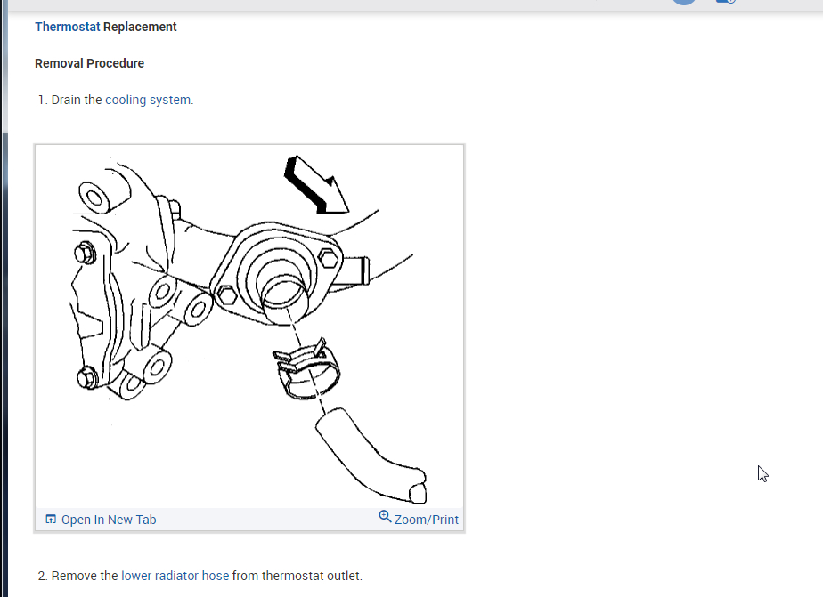

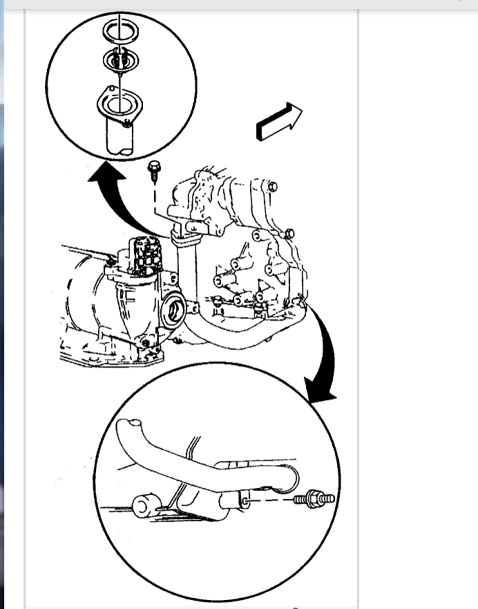

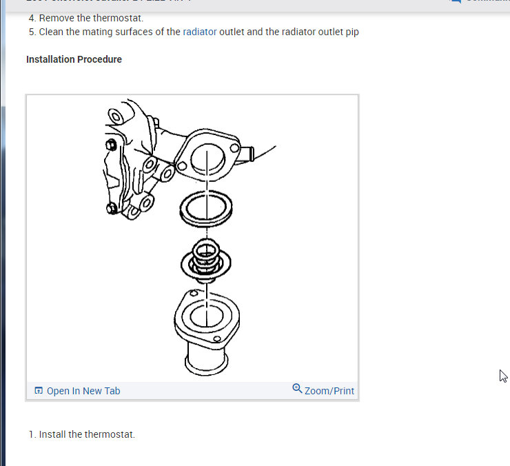

You do not have two thermostats on this vehicle. I am not aware of any vehicles that do have two thermostats but some have bypass valves that could be considered a thermostat. However, there are a number of vehicles that have two sensors but yours is not one of them.
I attached the process for the thermostat depending on what engine. The 2.2 and 2.4L are both attached.
Let us know if you have questions. Thanks
