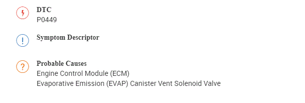

I was having problems with my vehicle where it would chug a bit, then the traction control light would come on. I had to pull over let it sit for a minute so the traction could reset itself. I had an original code on my car PO449, we changed the gas cap and the purge valve canister (i think it's called), then threw another code for the crank shaft sensor, fixed that. Threw a code for the cam shaft position sensor, fixed that, checked all the wires and harnesses on each. Then wouldn't start at all after we replaced the crank shaft sensor. It sounded like the timing was off as we were trying to crank it over. So we looked it up and the internet said possibly the Variable Valve Timing solenoid (VVT), but we can't seem to find where it is at. Does anyone know where it's located, or if they think it could be something else? Any help is appreciated.

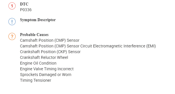

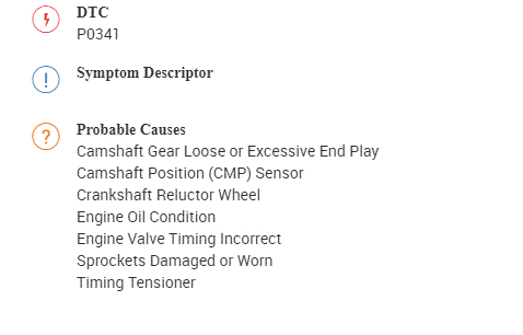

I would start with a compression test as I think you have a bad timing chain.

Remove the spark plugs and see if it cranks over.
I attached the code possibilities for you. The 2 codes have the timing chain in common.
