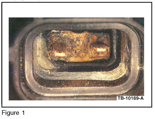

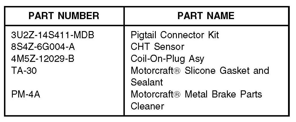

Ford has a technical service bulleting for this issue and you'll need to replace the sensor and the connector. Here is the official repair, and I've attached the part numbers and a view of a failed sensor.

3.If corrosion from water contamination is severe and terminals are rusted and disintegrated: (Figure 1)
a. Cut off connector C1164 and install a new pigtail connector. Refer to instruction sheet.
b. Replace the CHT sensor. Refer to Workshop Manual (WSM), Section 303-14. Proceed to Step 4.

4.Replace the affected ignition coil-on-plug(s), refer to WSM, Section 303-07 - Engine Ignition.
