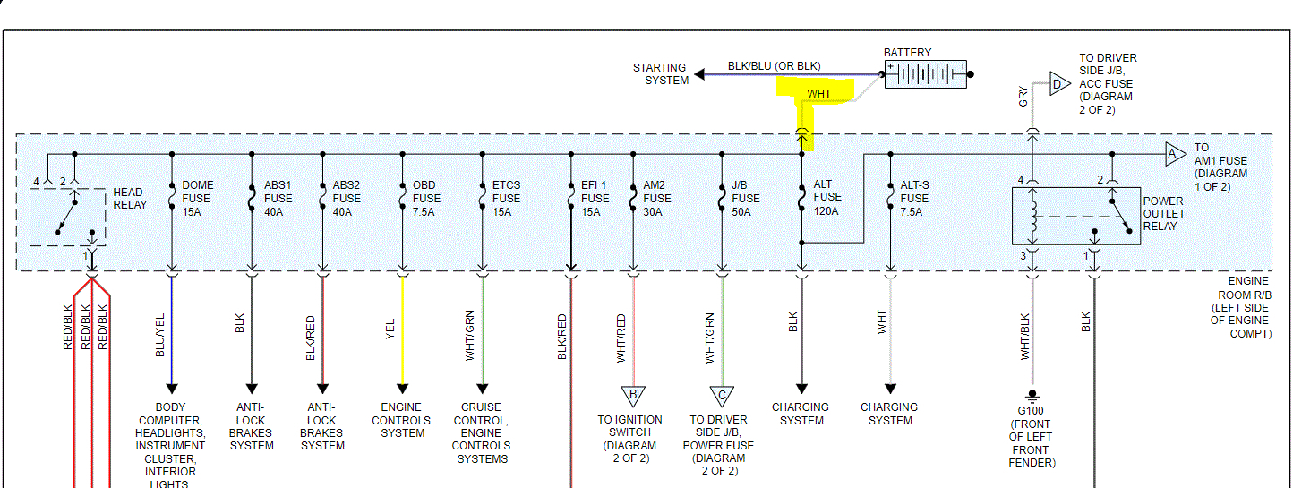

Something went very wrong, truck is running very bad. OBD codes showed several different cylinders both banks miss firing, and MAF sensor problem. I pulled battery cables before removing the MAF sensor to clean it. Could not find my can of mass air flow sensor cleaner. So I put everything back together to run to the store. Passive Theft reset and nothing. All electrical works but starter won't turn over. And even worse and what I really need to ask about is the smallest wire (2 cables and 1 wire) that connects to the positive battery terminal is getting hot. There is something seriously wrong because as soon as I connect the battery terminals it starts to heat up you can smell it and pretty warm to the touch.
