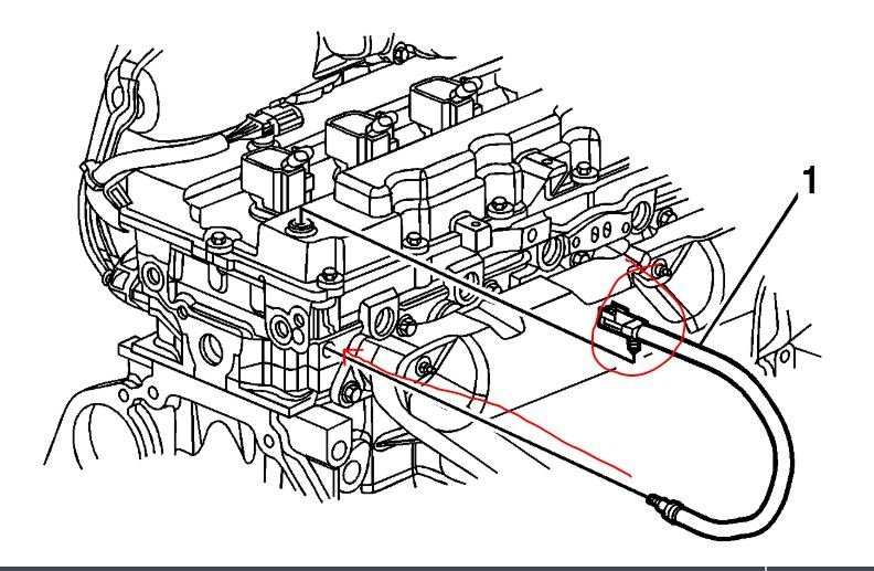

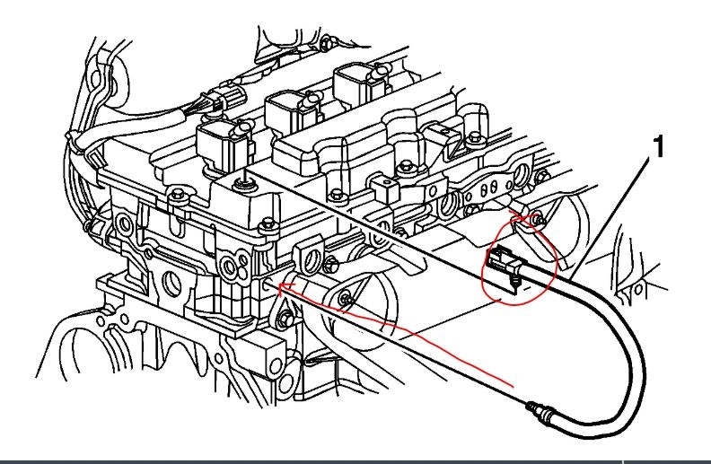

I attached a picture of the sensor and location below. I circled both the sensor (left side) and connector (right side).

The picture I attached is the engine. The sensor screws into the side of it. As far as a code, it could be one of a few different ones. P0116, P0117, P0128 and so on. The 128 indicates the sensor is showing an overheat.
