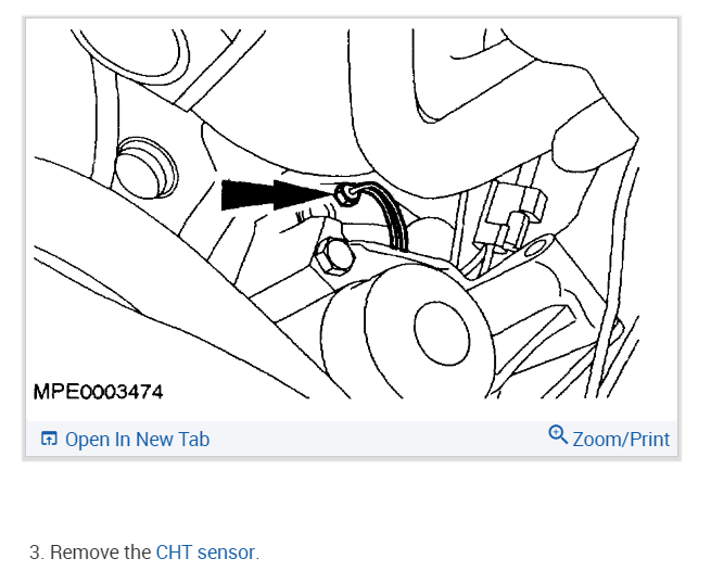

Engine management light came on with code P0118. Is the engine coolant temperature sensor located in the thermostat housing on a 1.6l Sreetka?
Jun 30, 2019 at 4:13 AM

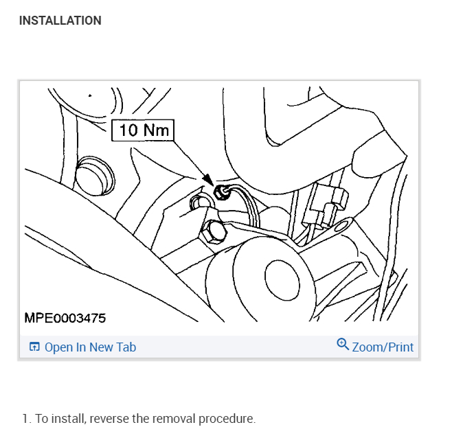

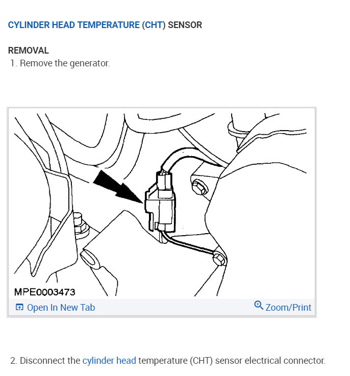

We don't have this car in this state but I think this will work. here is a guide to help walk you through the repair and diagrams below to show you the location on your car below:
https://www.2carpros.com/articles/coolant-temperature-sensor-cts-replacement
Check out the diagrams (below). Please let us know if you need anything else to get the problem fixed.
