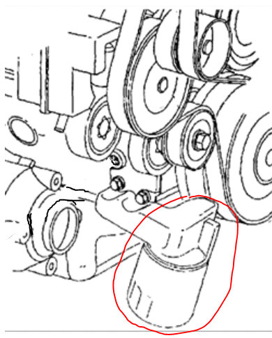

From memory (the manual doesn't provide a location) it will be accessed from under the vehicle. If I recall correctly, it is on the passenger side of the vehicle behind the front tire (close to the frame). Also, it is likely pointing downward.
If you turn the steering all the way to the right, you should be able to get it by moving the splash shield. See pic below.
Let me know if this helps.

Thanks so much, Joe! If it's close to the frame there's a chance, I may be able to find it with a flashlight, lying flat on my back alongside the vehicle. If it's really close to the frame, I may even be able to change it with just my arms underneath.
Otherwise, turning the wheel and moving the splash shield is a great hack to know!

You are very welcome. You should be able to see it behind the splash shield. It may be a little tough with the wheel straight. It sits more centered behind the tire.
Take care of yourself and feel free to come back anytime in the future. You are always welcome here.
