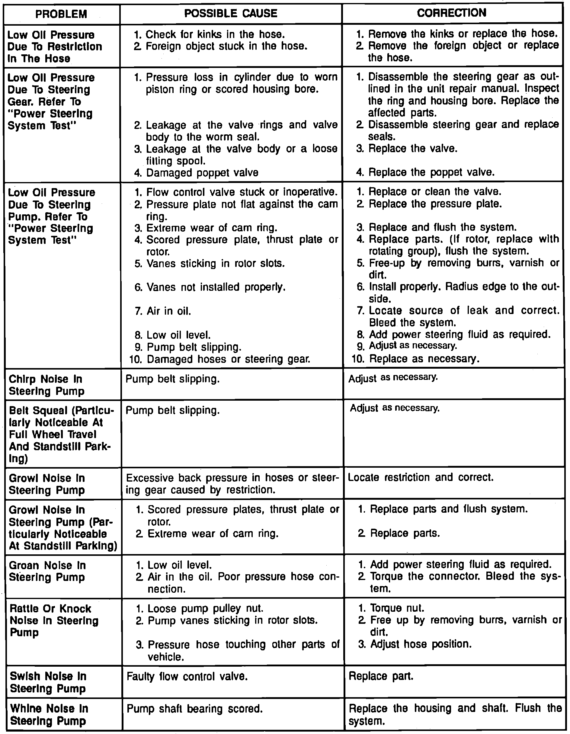

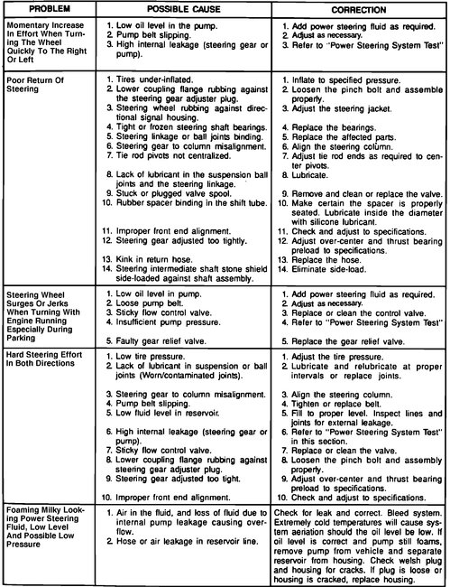

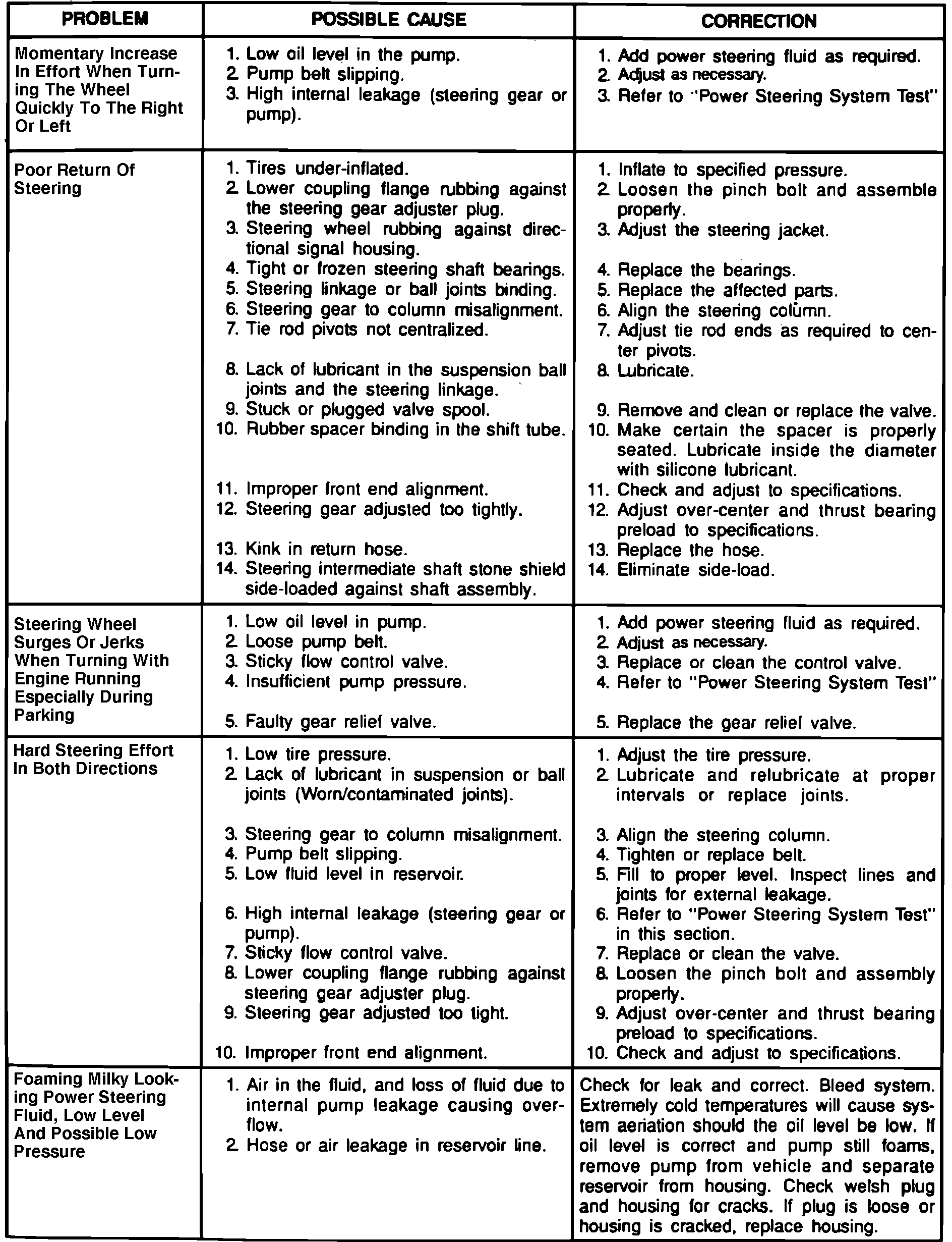

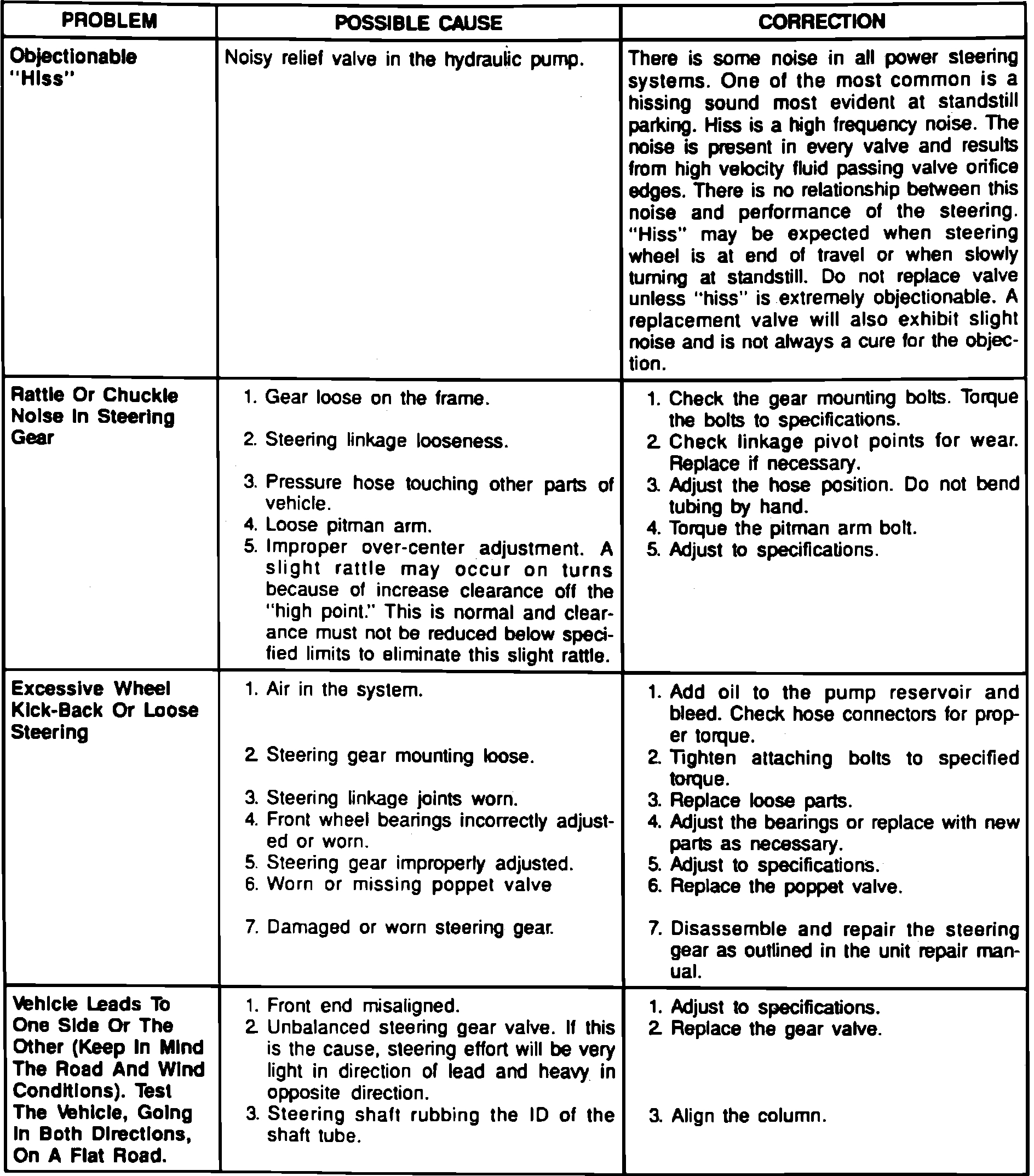

Regardless, if you look at the first three attachments below, I included the flow charts for diagnosing power steering pump issues.

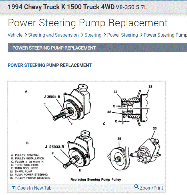

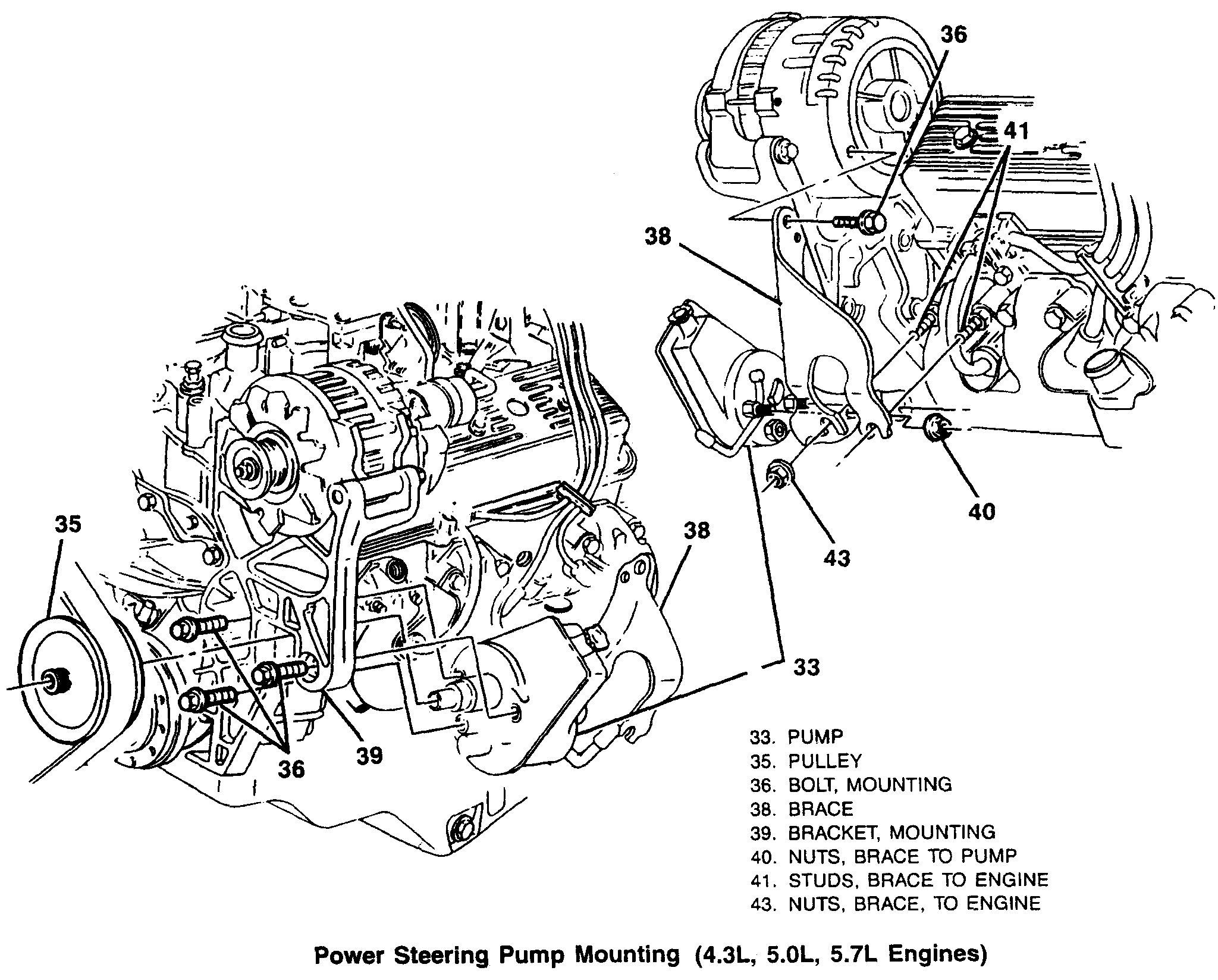

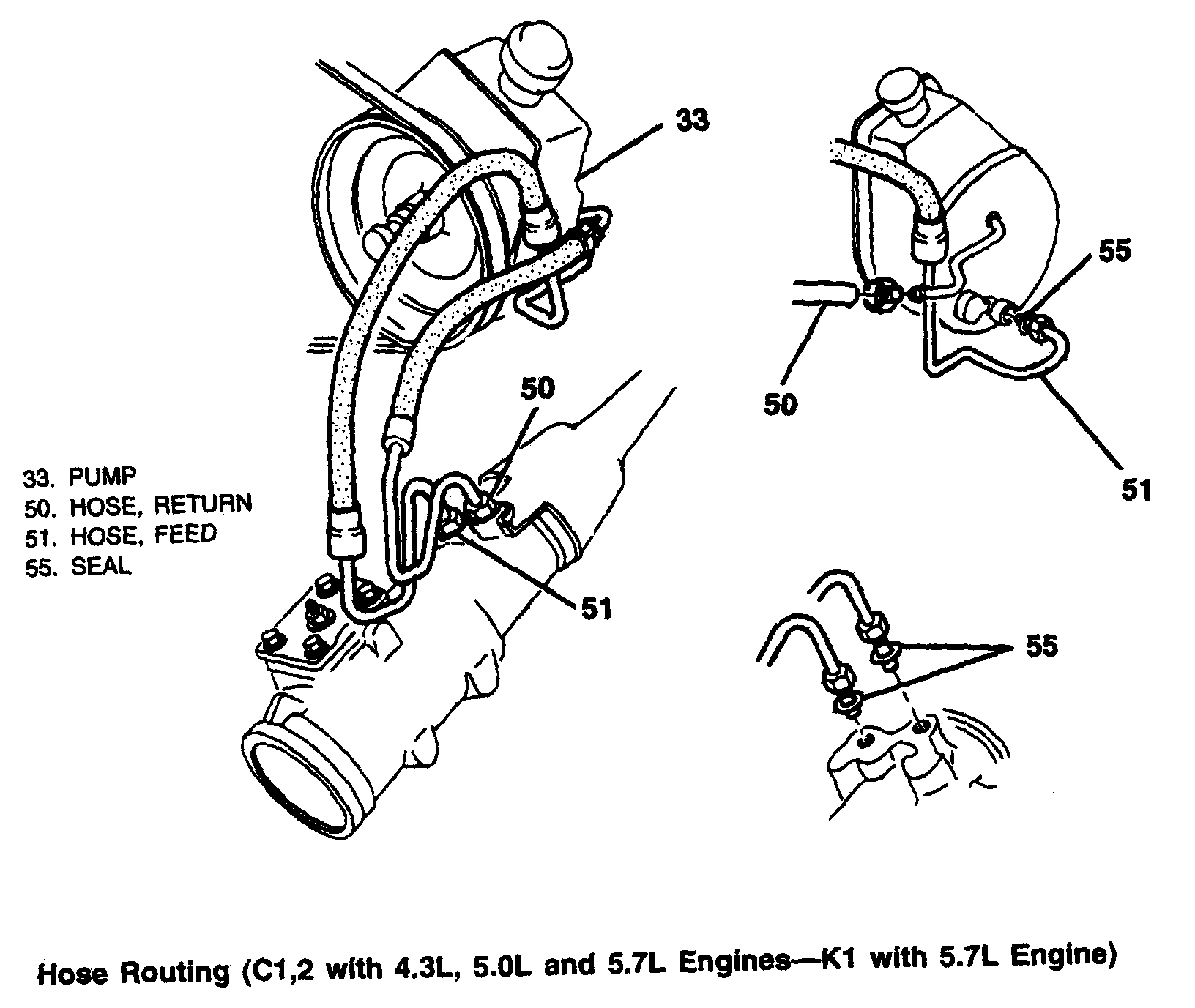

I am adding two more links here. The first link is in the event you replace the pump and have to reuse your old pulley. The second shows in general how the procedure is done. You can use it as a guide.
https://www.2carpros.com/articles/remove-reinstall-power-steering-pulley
https://www.2carpros.com/articles/how-to-replace-a-power-steering-pump

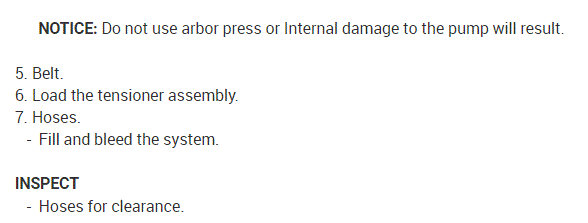

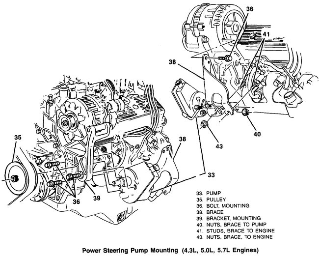

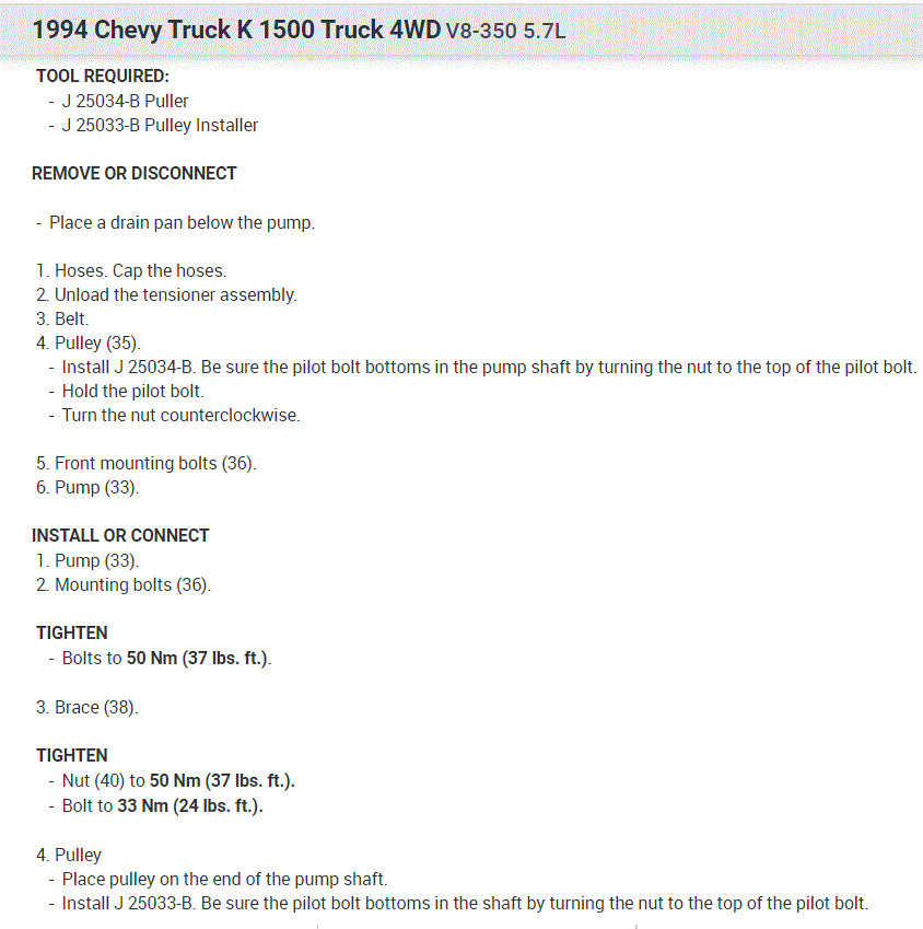

If you look at the additional attachments, they are directions specific to your vehicle for the pump replacement.
