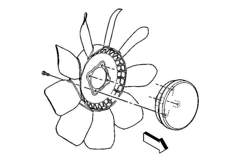

Removal Procedure
1. Remove the cooling fan and shroud.
imageZoom/Print
2. Remove the push-pin and release the fan clutch electrical connector from the fan shroud.
3. Remove the fan clutch from the fan shroud.
4. Remove the bolts retaining the fan blade to the fan clutch.
5. Separate the fan blade from the fan clutch.
